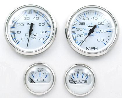

All great info, thanks to all for the replies. When the time comes, I think I'll take Tomahawk's approach. The rig is blue and white, and this set would look pretty nice in there.
