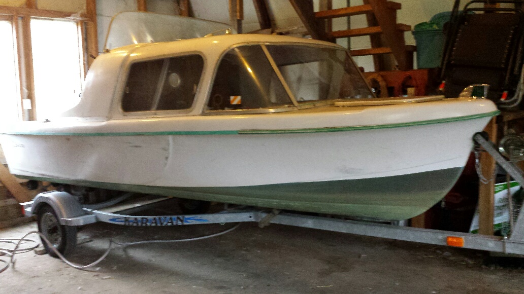

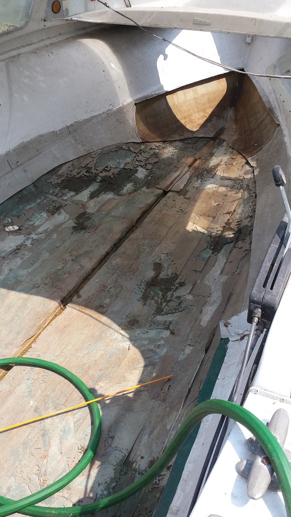

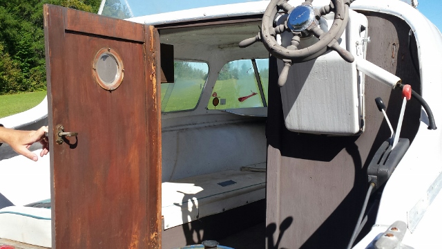

We ran across this boat for sale yesterday and although not ever having owned a boat are really tempted to purchase this one. We live in an area with lots of boaters and river systems so maybe it is time! I am hoping someone on here can give us some advice as to fair price, what to look for in the way of issues etc. Boat appears to be in relatively good shape for its age. So I am attaching a few pics and would love to know what you all think. Thanks!!

Jazz, welcome aboard and very nice find. I can't tell you much about it but I like the small cruisers.

Go ahead and do your demolition now, remove the decking and check the stringers and transom for rot (they'll probably need to be removed too). Do all of the grinding and clean-up as well. You'll be way ahead of the game come spring when the weather warms back up to start glassing.

Well it has taken about 9 months but we are now hard at it! Finally got it stripped down and every piece of wood on the deck was compost so starting with a clean slate. There was no evidence of stringers of any kind but I don't know if that was original or a previous repair job. I does appear to have just been 3" boards laid in as you can see the outline quite clearly....so that is what we are going to attempt! Wish us luck...
