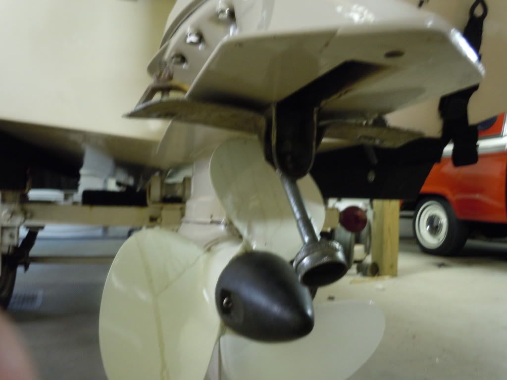

I know it's freezing up north here but that doesn't stop me from dreaming. I have this '67, I think, Johnson 100 hp golden meteor and hear/read different ways to cool them with a hose. Would this setup work? I took the plate off the side of the leg by the water pump. The other hose leaves plenty of room inside for water to enter the screen intake. Probably won't even attempt a start until late March.

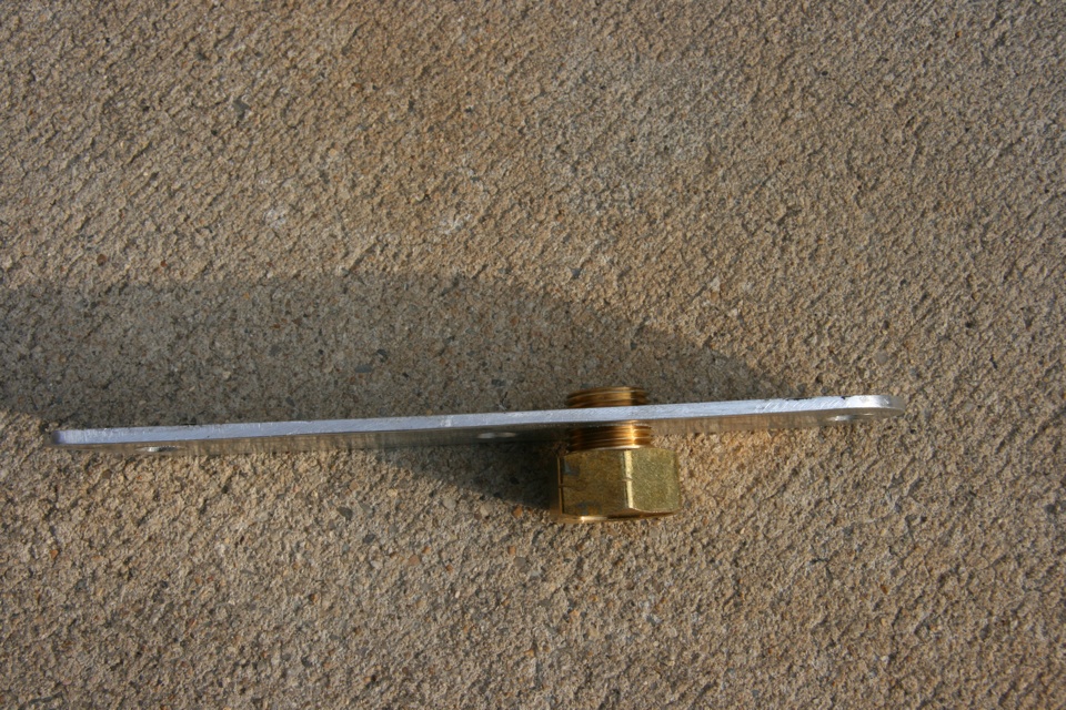

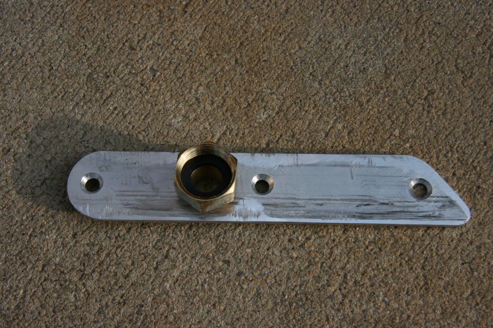

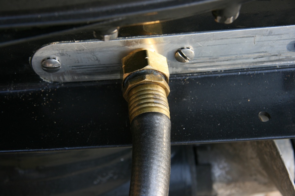

Ok try this for the third time! That may work cal. Here's what I did.
This seems to work just fine. Haven't had any problems.
Re:Will this cooling work? 12 years 9 months ago #89211
The port on the 100 model is not the same as the one above ( 75 / 80 hp ) I believe the adapter made up by 63 will cool the 100 HP.

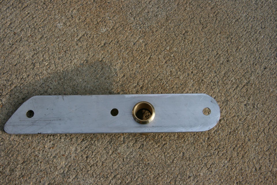

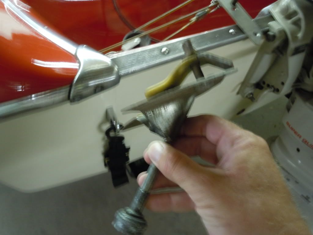

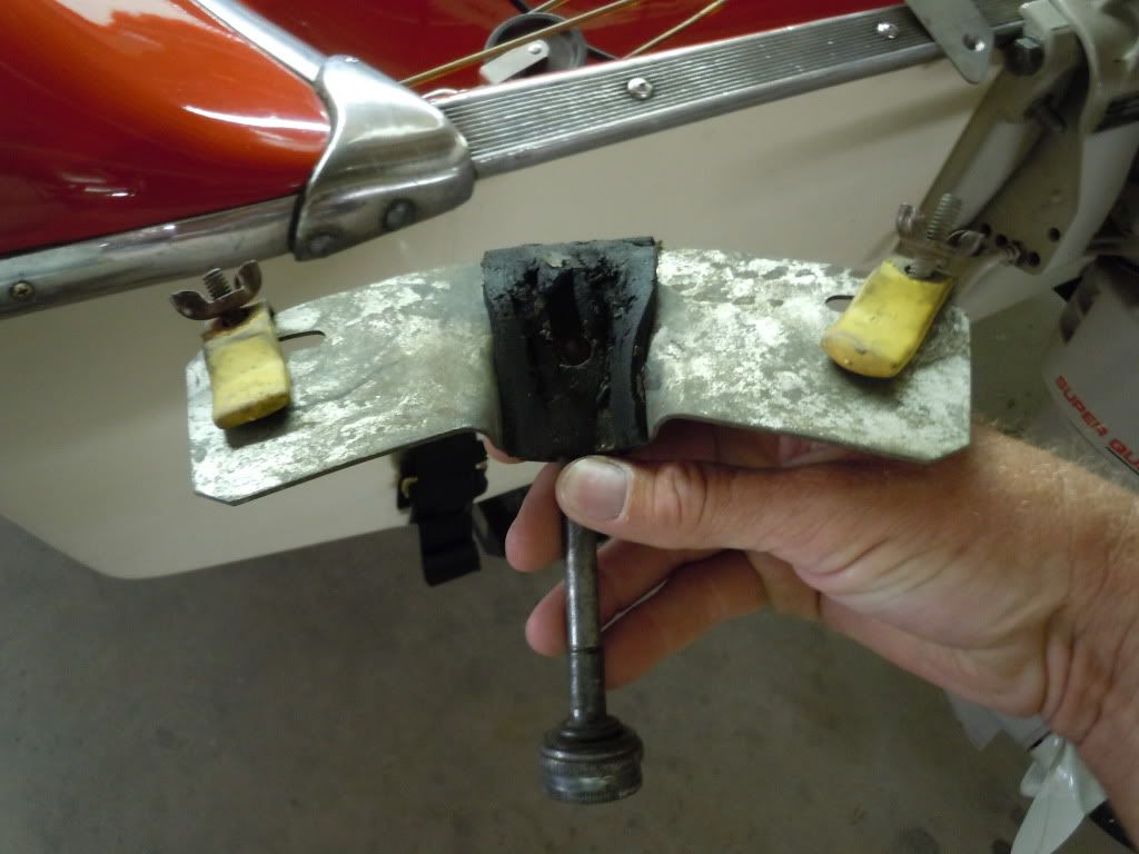

Could something like this be used for the 100 hp?
Re:Will this cooling work? 12 years 9 months ago #89226
Bob, beautiful engineering work but the Johnson drive leg is not the same. Thanks for the look-see.
Cal
Re:Will this cooling work? 12 years 9 months ago #89227
Jim, neat setup but still no cigar, you guys come up with the good rigging for difficult problems. The 100 hp Johnson is a different egg altogether.
Re:Will this cooling work? 12 years 9 months ago #89353
Sorry, thought the 100hp was the same lower as the 80hp, my bad. ;)
Re:Will this cooling work? 12 years 9 months ago #89357
Nothing to be sorry about. Seems this 100hp meteor came from a different planet. Can't for the life of me figure why they would change a cooling system for one model/hp when everything else they made worked just fine unless they planned on selling lots of adaptor kits :)
