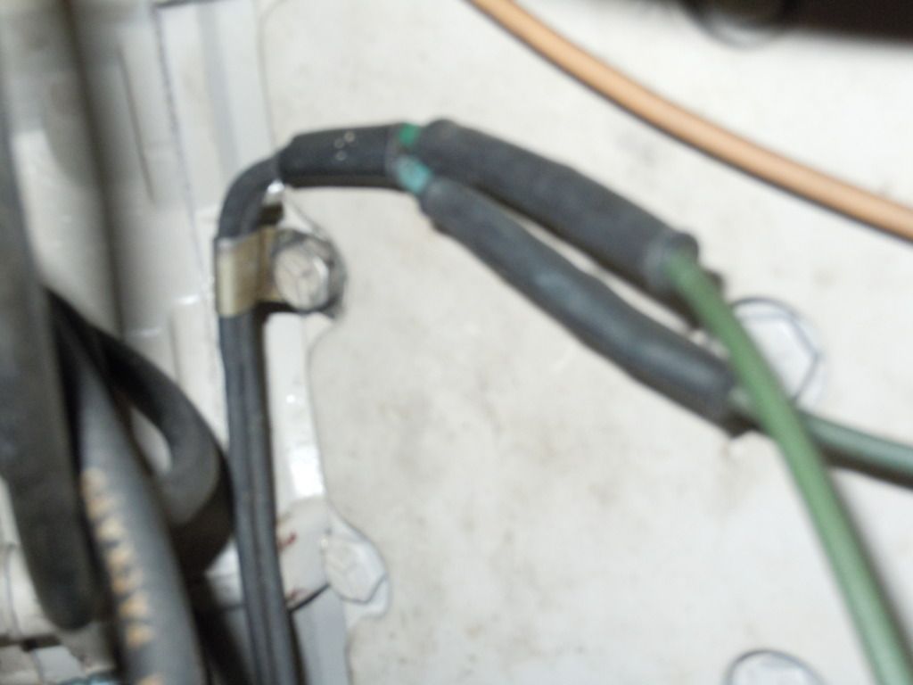

You might take a jumper wire and attach it to the positive terminal of your battery with the other end touching the green terminal located behind the powerhead. Just slide the rubber sleave/tube off the color coded knife connecters and apply 12v to one, one at a time and see if there's resistance to turning the prop(with the ignition switch off). If the prop engages,I would think you just need a switch like ED says. Here's a blurry pic of the wires to disconnect.Hope this helps
