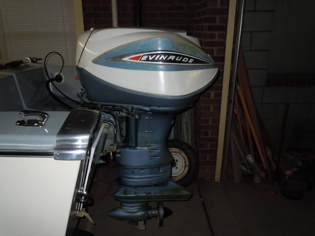

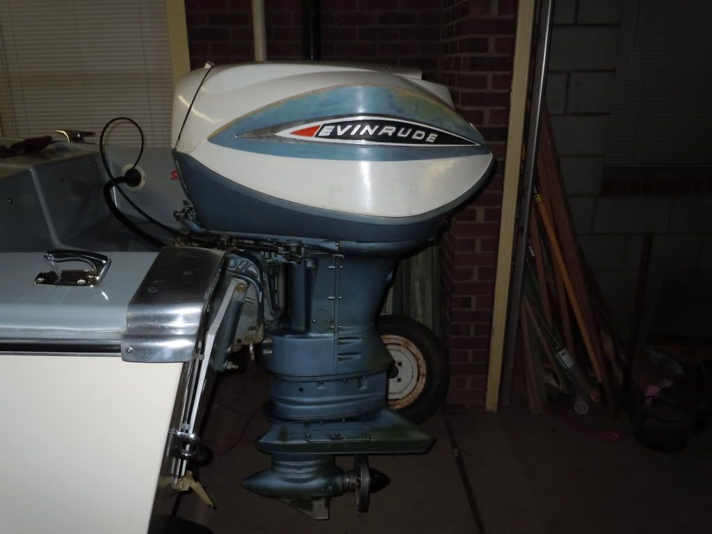

One $100 1965 75 hp Evinrude parts junker back from the dead.Stuck it on the Crestliner for the heck of it and it runs and shifts out good. I LMAO when it fired up. Had one issue with almost no water coming from the relief port on the back. No overheat and it might just be because it was cool(45 degrees). But I went on and put a thermostat that I knew was good. While it was running, I loosened the screws on the themo housing and water gushed out so I feel like the themo was not working quite right. Had it in a 50 gallon barrel.
Re:It's alive!!! 13 years 8 months ago #74548
Glad to hear you bought a "runner" Jim, that is good news! I've experienced the same thing on the exhaust relief water on both the Johnson and now the Evinrude 115's. 2 Things:
1 - It's almost impossible to get the thermostats to open in the driveway this time of year with the weather (and the water coming out of the hose) being so cool. Both the hose / flush muffs as well as the barrel produce very little water out the exhaust relief.
2 - Even in cooler weather mine produces more water out the relief holes when it's in the lake. (Guess being submerged to normal operating depth may have something to do with it?) Mine will open at cruising speed, then close shortly after coming back down to idle. Only a little water out the relief holes is normal this time of year IMHO.
This is one of the reasons my obsessive/compulsive disorder requires me to have a water pressure gauge plumbed in prior to the thermostats, that way you KNOW it's pumping water. I also believe investing the time and few dollars on a new impeller is cheap insurance if you're not sure what kind of shape the old one is in. Also a good idea to replace them every couple years, I am told.
Just the humble ramblings of a shade tree mechanic, HTH. :)

Yeah,I took the water pump(new),points/condenser(new), bottom section of carb(rebuilt last year)and fuel pump also rebuilt last year,all from my 63 75hp that overheated(broken intake tube) last year and put them on this old clunker I've had setting in the basement I bought for parts prolly 10 or 15 years ago. Still got the Merc 850,but it needs probably more than I can swing right now so I took a gamble and "maybe" (fingers crossed) it paid off.. :laugh:

I got the shifters changed out Friday and the power tilt added yesterday while it was cold and rainy outside. Today tested it all out. Made a video of the motor running with "summer time" water temp in the barrel. Thermostat worked perfect. video maybehttp://youtu.be/W7TWzVdKEko
