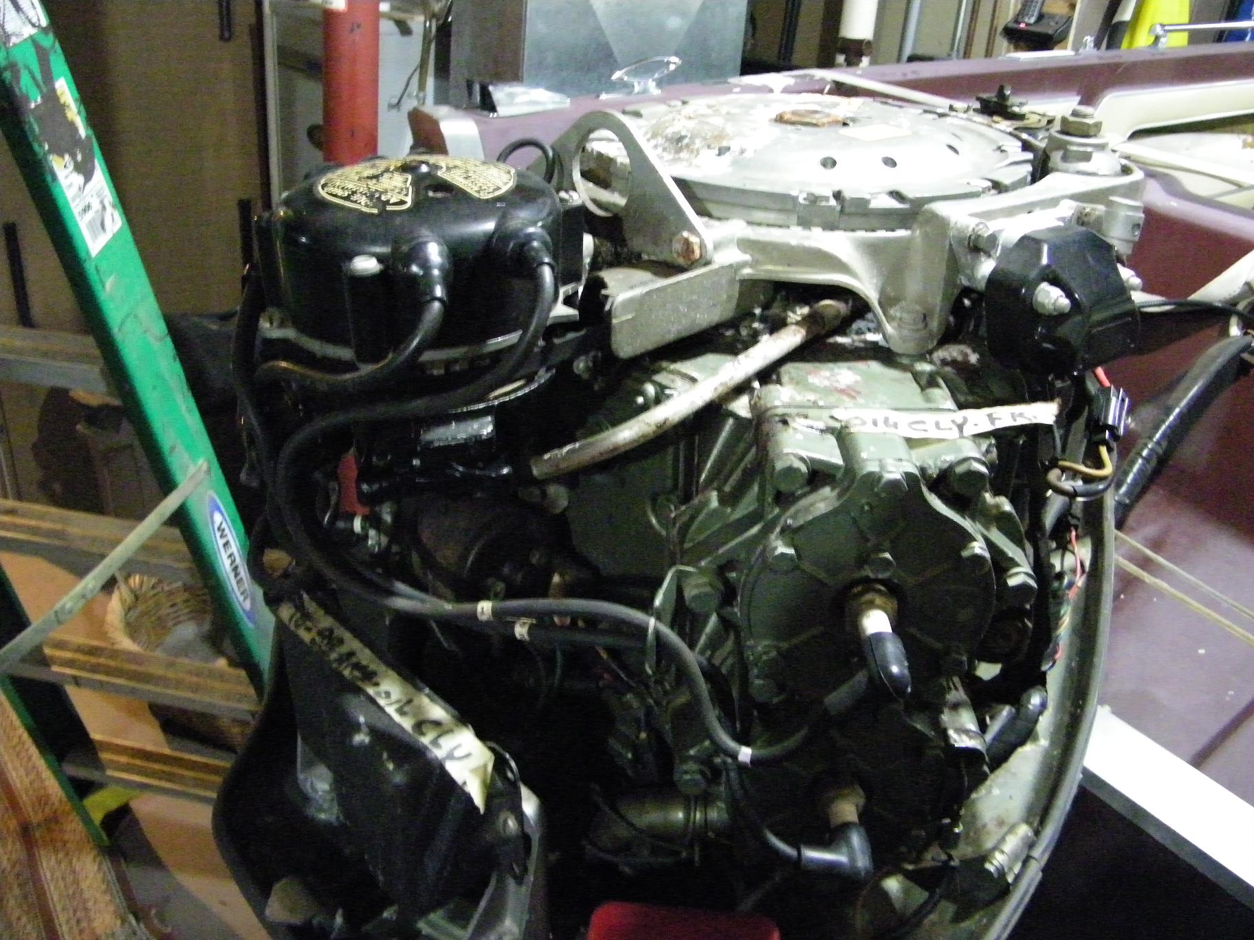

Ok, my new winter/summer/winter/summer///// project is home and hanging on the back is a 19-- 100 HP Johnson Golden Meteor. Looks to be in great condition. Compression in all four is well over 120, maybe higher but I couldn't hold the gauge in the hole by myself. Wiring is soft and supple, the belt looks new and soft but there is one ground wire that got "moused". Last time the motor was run on a lake was 1997 and then the cylinders were fogged before layup. Needs some cleaning and freshing.

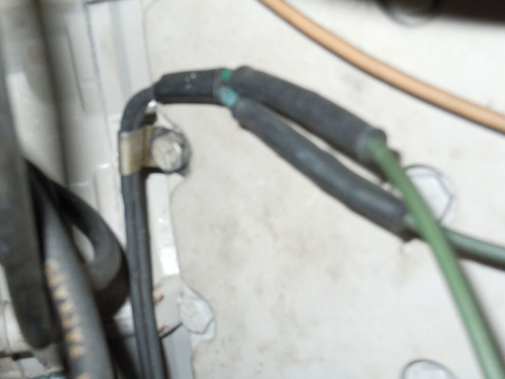

Can someone point out to me where the knife connections are for the lower unit shift so I can disconnect them and attach a string before I even unbolt the lower.

Cal,the wires are located on the back of my 75hp between the cylinder banks above the thermostat housing. yours should be similar.jim
Re:Johnson Golden Meteor 14 years 1 month ago #70024

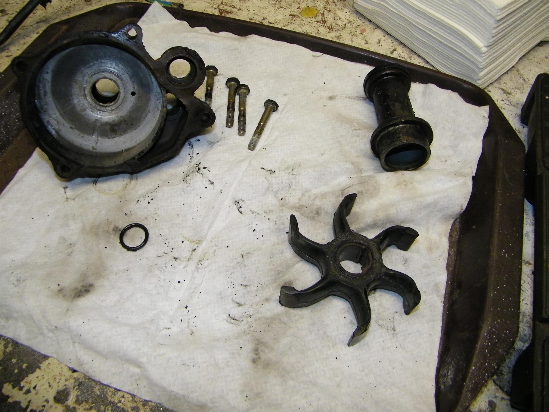

Jim, thanks, I found it hidden behind one of the rubber cooling hoses. Had to remove the hose to get at the wires and of course I trashed the rubber hose and dropped the hose clamp down the cowling. Now I have to replace the cooling hose, remove the lower cowel to get the clamp out.
Anyhoo I searched and googled the procedure for changing the water impeller on this puppy and could not find anything so I started taking pictures of the process to help anyone else out. I have to pick up a new impeller tomorrow and then I will post the pics on how to take the lower off, change the impeller and reasemble etc. The impeller had a pretty good set to it so I can see why it wouldn't cool. Tomorrow I'll also jam a garden hose up the inlet pipe and flush the system, probably blow right out the rubber hose I trashed.
Here you can see the set of the impeller.

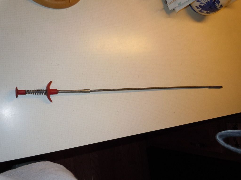

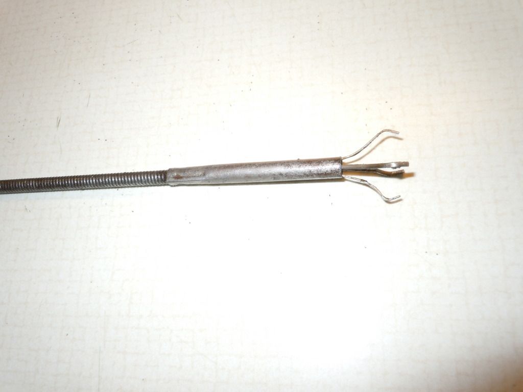

Cal,I've had to fish out quite a few pieces out of my motors lol.I've found that this is real handy for that.
Re:Johnson Golden Meteor 14 years 1 month ago #70040
Jim, I have one Zackly like that same color too. They do come in handy. I can't figure where the clamp is so I'd be fishing all evening without a bite. I'll pull the lower cowel, probably lots of screws and washers down there anyway.

Re:Johnson Golden Meteor 14 years 1 month ago #70145
Bruce, I removed the motor fromt the boat today. Rumaging through my old inventory I found a curved heater hose from my Sabre that was a perfect fit sans some trimming with the amazing Ginsu, got my finger also. I will pull the lower shaft cover sometime before I put the lower unit back on to look for hidden treasure.
The new impeller is installed without a hitch.

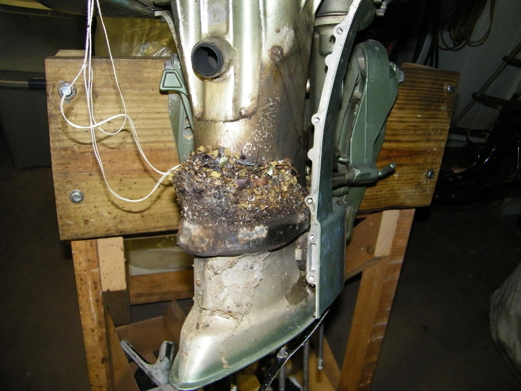

Re:Johnson Golden Meteor 14 years 1 month ago #70161
Removed the lower coweling, found the usual mouse chewings, one 1/4" bolt, a fishing swivel terminal and the elusive hose clamp. Good opportunity for a clean up.
The dangling string is for rethreading the shift wires.
