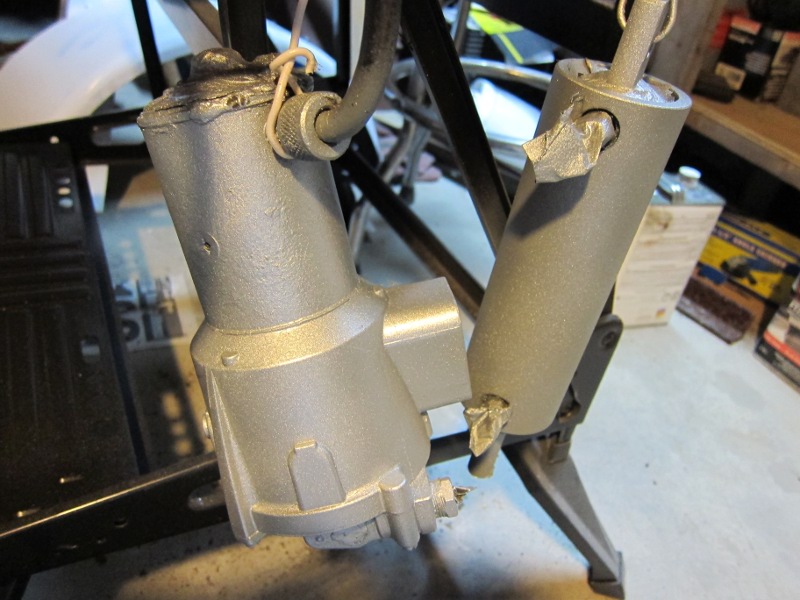

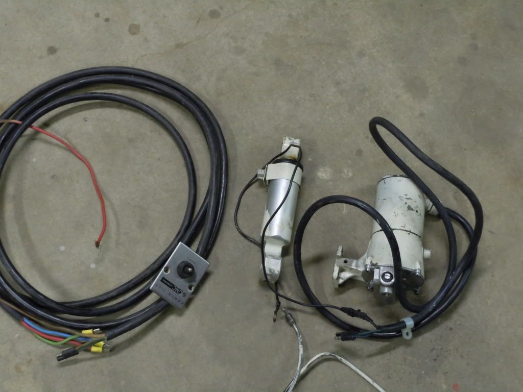

Try it with the tilt then take it off,use the motor for a while(especially beaching), then come back on here and tell us if it's worth it keeping. I bought one complete on fleabay for $35 last year,put new o-rings in it and it works like a charm..jim

Sounds like I should keep it. I do not have the switch. The switch in your photo looks like the electric choke switch are they the same? I do have an extra one of those.

Those babies look like mine, or I bet I could use one. I should check out flea bay more often!

The switches work different. The tilt switch stays centered when not being pushed up or down. There is /was one or two on fleabay not long ago(I love fleabay)lol.

The switch should be a DPDT momentary on. That is a Double Pole Double Throw switch that is spring loaded to go back to off when you let go. They can be bought in many places and if you buy a toggle, be sure to buy the water proofing boot for it.
www.google.com/search?q=DPDT+monterly+on&ie=utf-8&oe=utf-8&aq=t&rls=org.mozilla:en-US:official&client=firefox-a#hl=en&client=firefox-a&hs=9nW&rls=org.mozilla:en-US:official&sa=X&ei=RdSlT7HOF4eA2QW6y9CmAg&ved=0CCQQvwUoAA&q=DPDT+momentary+on&spell=1&bav=on.2,or.r_gc.r_pw.r_qf.,cf.osb&fp=b001bd3a40637c26&biw=1047&bih=489
I think with those older unites, (been a few years that I worked on one) that you used just one side of the switch till it wore out and then plunged into the other side...... and used that side till it stopped working...
