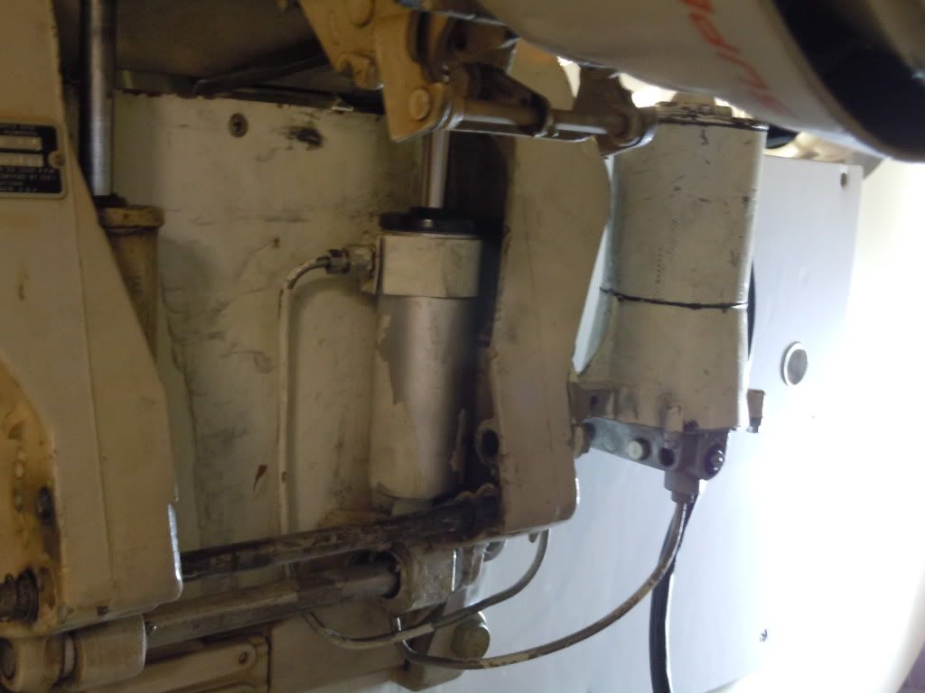

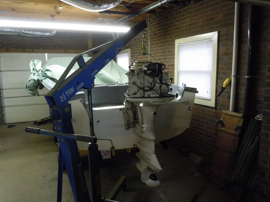

Raining here today so it was a good time to tinker on the power tilt I got off of ebay last spring. I figured out the PO had put the piston on backwards on the shaft of the lift cylinder.After I fixed that it worked great. I put it on the Crestliner so I won't have to crawl up in the splashwell and put my foot against the transom to lift the motor anymore :) . Thought I'd show some pics.

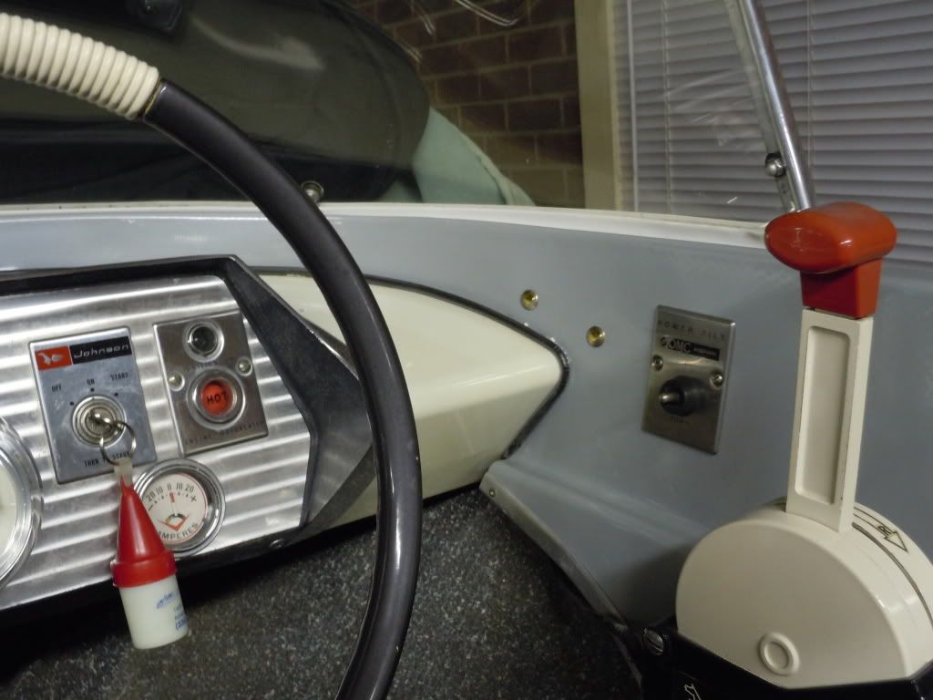

Another rainy Saturday...This was the only place I could figure out to mount the switch. What do you guys think? My thinking is it will be easy to reach standing on the ground,preparing to launch.I always tilt the motor up before I back it into the water.

Looks good to me. My only suggestion would be to add a waterproof switch at the back somewhere (motor pan, splashwell, gunnel) so you don't have to go forward to tilt when doing tinkering, maintainance, transom saver, etc. Best advice I ever received, very handy, not very much $.

Nice job Jim, looks good. Got mine working yesterday too, (it was raining and storming here as well), bypassed the relay box. I'll check that out later, still finishing up the carb/fuel pump rebuild, hose replacement. Kerry has an excellent suggestion on the aft switch, just have to figure out where to put it. :P

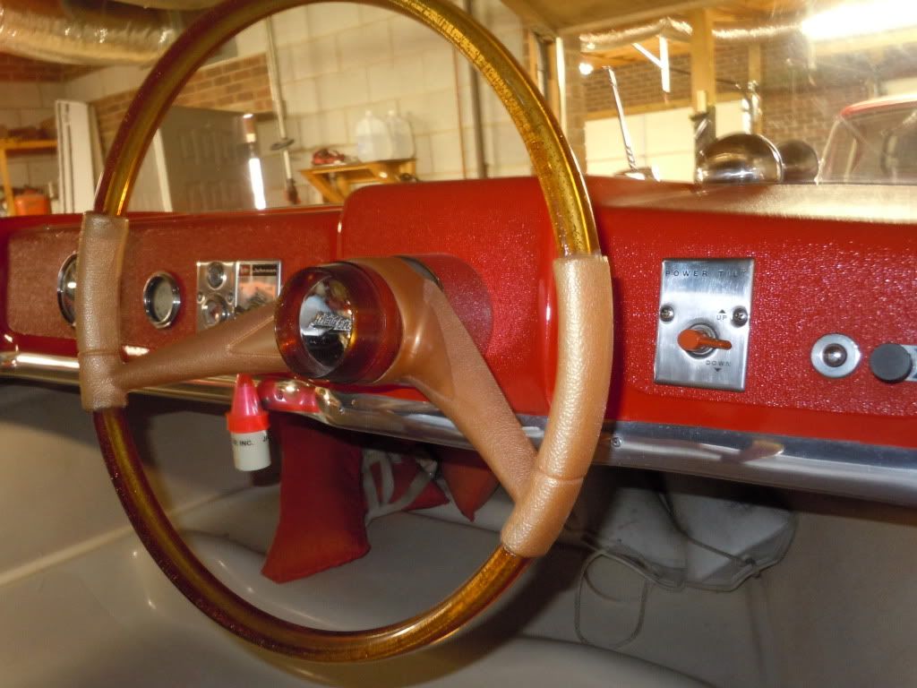

Thanks guys,That's a great idea Kerry.It would be neat if I could find another switch to match the one up front or one original for a 1962 model tilt. The toggle would go at the back.It has a rubber boot on it. This is an original type for a 62-63.
Re:Got my power tilt to work......finally. 14 years 3 months ago #54881
Wow! fancy schmancy! Beautiful work.
