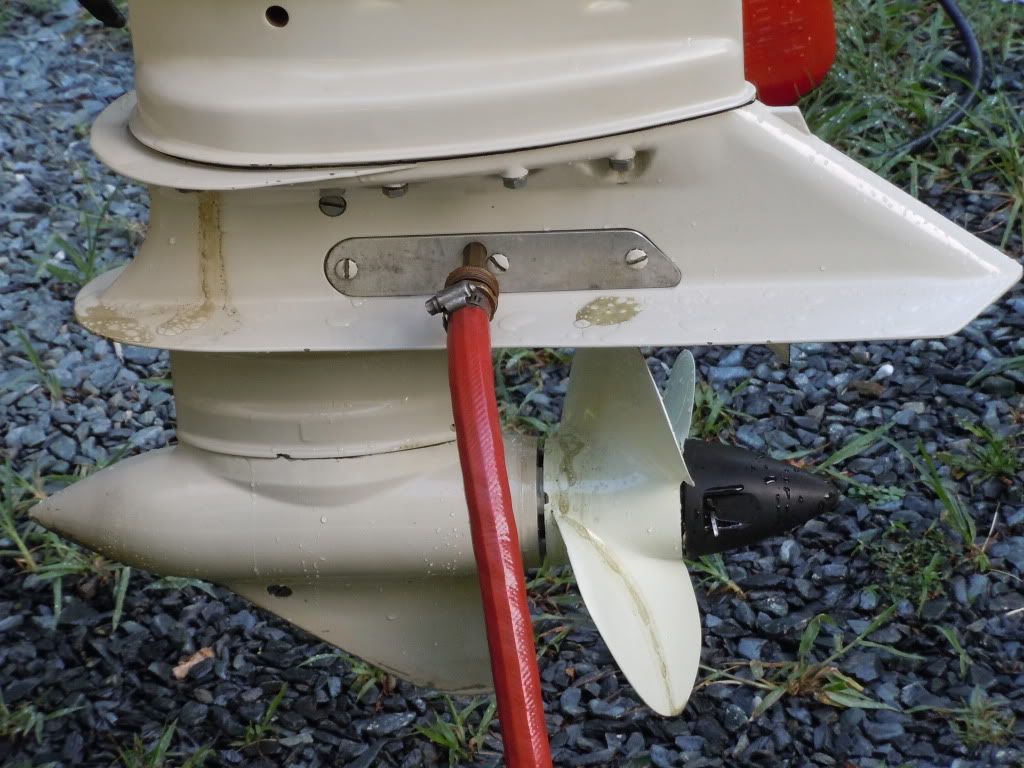

The OMC engines of this vintage can't use "muffs" as the water getting to the pump won't be enough. TEMPO products used to make a "taco shell" adapter that attached to the water pickup with a spring going over the housing to hold it in place. This screwed to a garden hose. The best adapters for these were a metal plate with a hose attachment on the side. You have to unscrew the 3 screws on the intake bypass plate - which is in the upper left side of the lower unit. The flushing plate screws on.

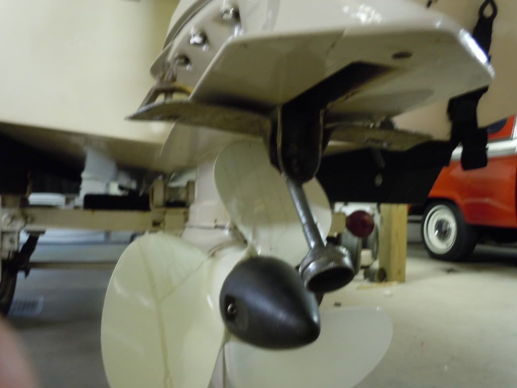

The hose for the speedo used pressure. There should be a Pitot (pronounced PEETO)tube on the base of the transom. This had a Pitot that attached to the hose. As water was forced into the pitot tube by forward movement, it compressed the air inside the rubber tube, making the speedometer work. Water never gets to the inside of the speedometer (or at least it shouldn't) If water gets up to the speedo mechanisim, it will ruin it.

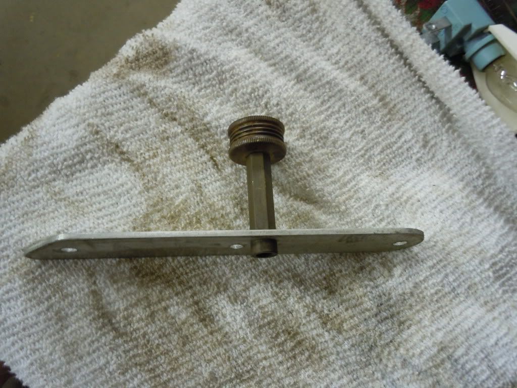

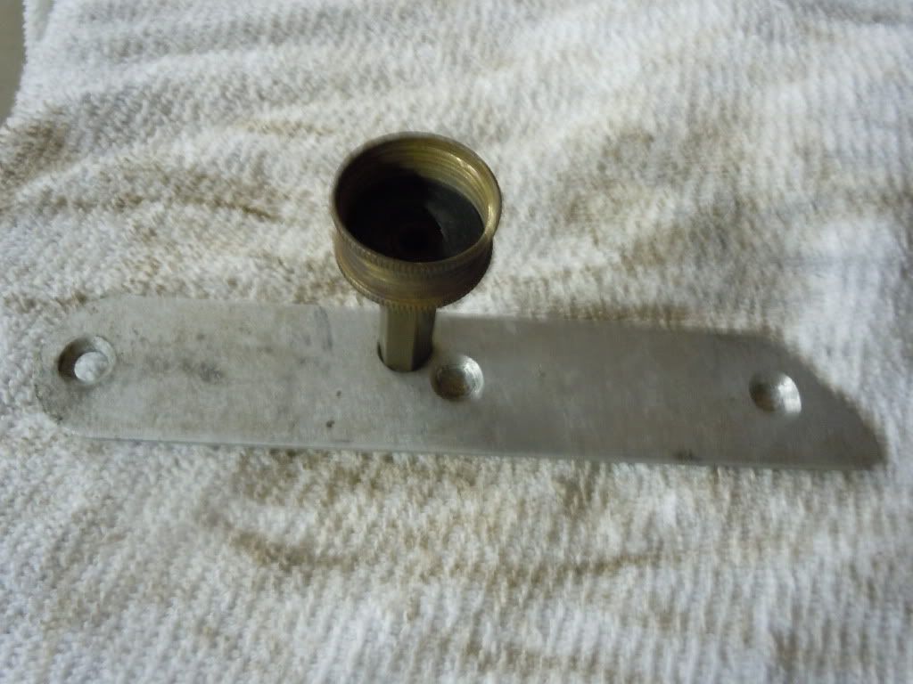

This are a couple of flush attachments I have.The plate with the three holes looks like it would be fairly easy to make.
I apologize for the fuzzy pics. :)
