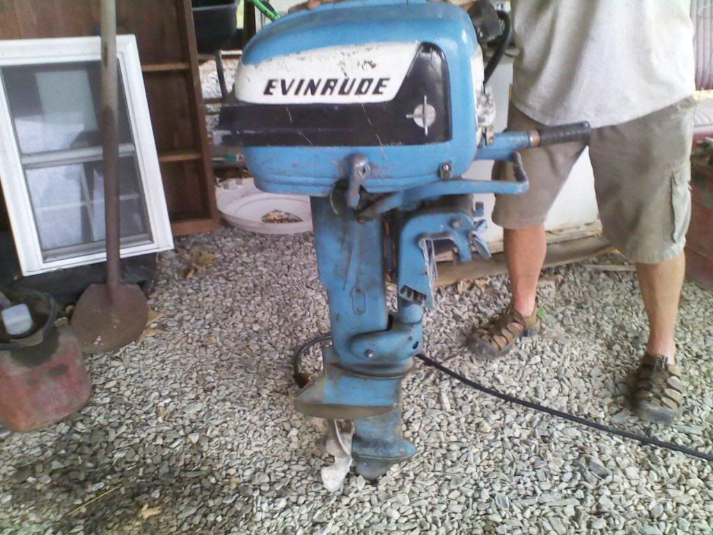

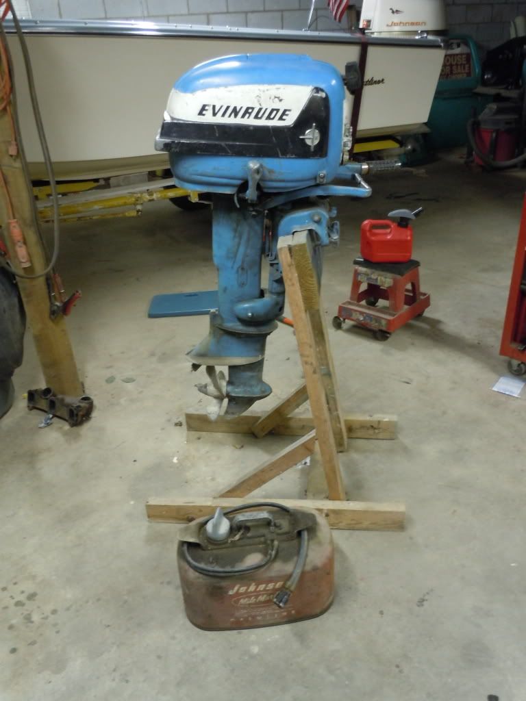

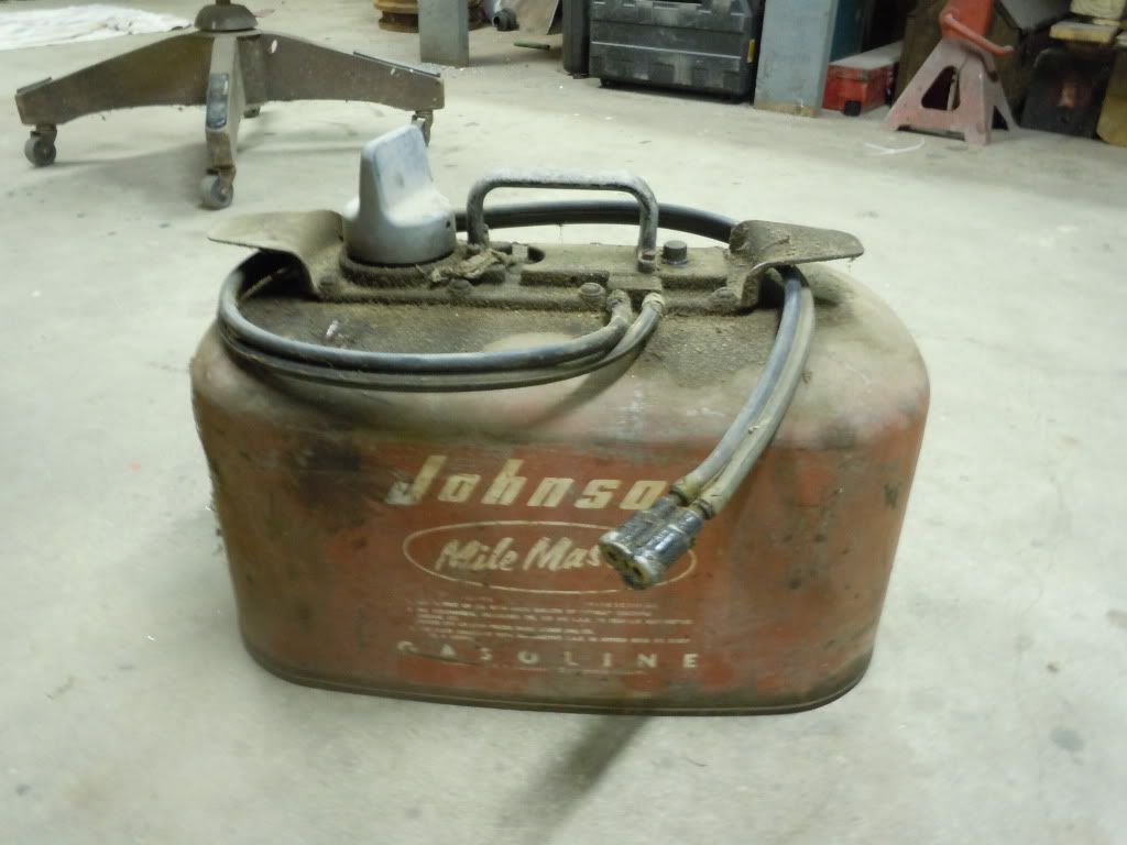

1956 evinrude sportwin 10 ? What do ya'll think about this little jewel? He's asking $100 for the motor and a johnson 2 line tank.

JUMP!!!!!!!!!!!!!!! :ohmy:
Re:Got a chance at one of these. 15 years 2 months ago #40852
If it looks as good inside as the outside and has good compression and spark I would say you got a good deal. Those twint if tanken care of will run forever.

Okay now. Wiped off the drool and got a cold drink. If it isn't stuck, its worth it. If the pressure tank works, and it runs, its DEFINITELY worth it.

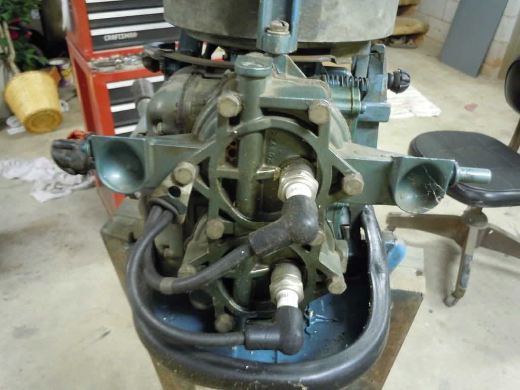

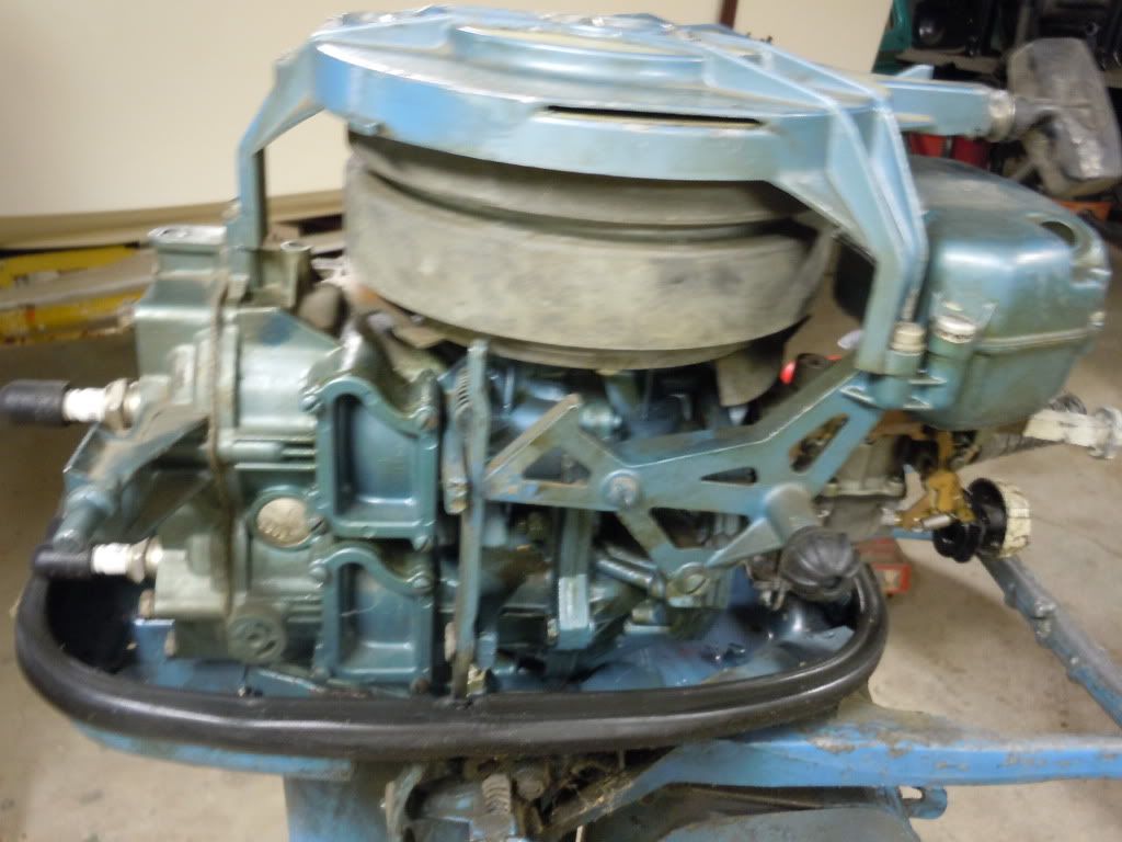

O K,I went and picked it up today ,got it home, done a compression test. I came up with 60 lb per cylinder. Is it still worth it or junk??? I told my friend I'd either bring the motor back or a $100 bill.jim

Little low on pressure...Turn the crank till the pistons are near center of stroke (Use a soda straw in the spark plug hole to find center)
Add about a 1/2 cup of diesel and transmission fluid mixes 50/50 to each cyl (motor face down and let sit....may want to place on cardboard as it will leak out this should loosen up the rings
You got your money worth,,,as parts you can piece it out for over $300 the tank fitting is worth $35 along and on the tank cleaned up $75 (with the fitting)

Check the wrist pin/ piston / bushing for looseness.
If that is good they are an excellent motor.
