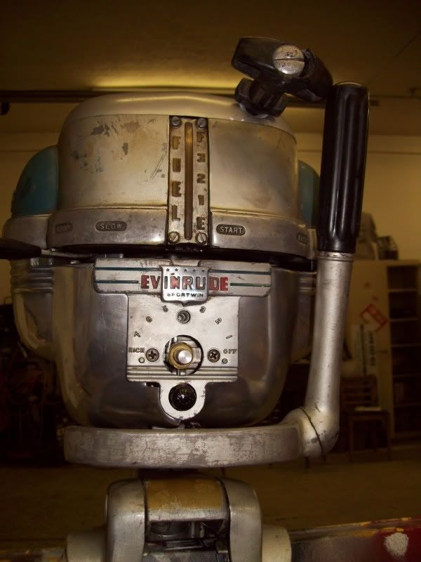

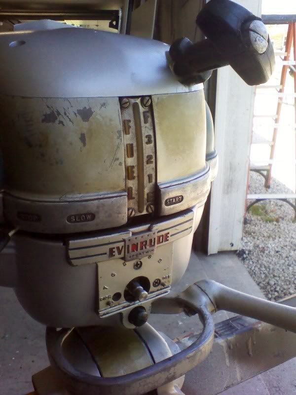

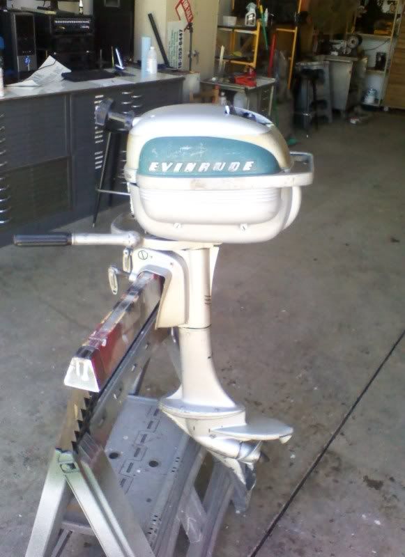

I picked this little guy up today and had it running for a minute but I'm missing some parts but the problem is I don't know what I'm missing. First off is the knob and whatever is behind the knob that controls the richness. Does anyone have a parts manual that is willing to share the exploded view? I would like to get a rebuild kit for the carb also. The other piece that I'm missing is on the side of the motor there is like a copper coil of some sort that I don't know whats missing but the coil is just sitting there. Sorry I don't have a picture of this yet but will here soon. If anyone knows where I could get the carb parts please let me know thanks.

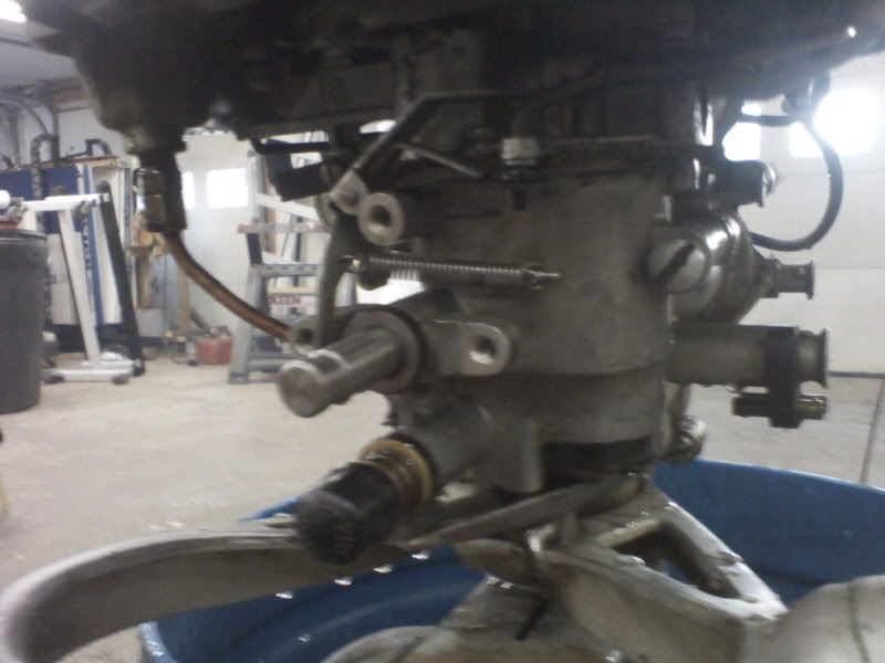

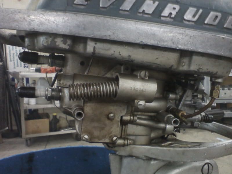

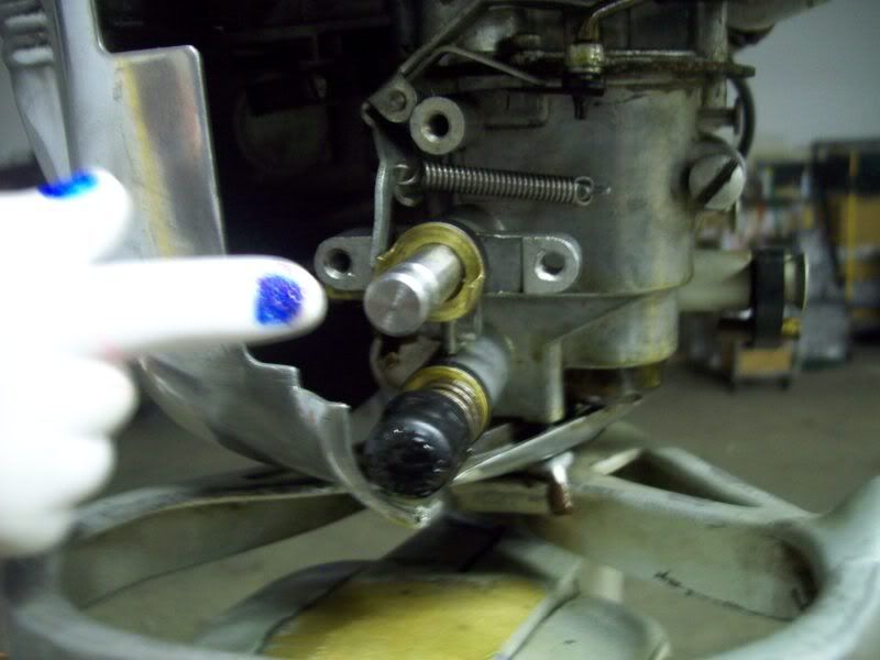

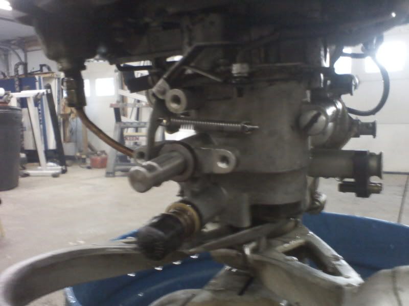

Here is a couple of close up pictures of the carb and tube on the side.

It sounds good in the vidio but I don't see it pumping and water. It looks like they are 2 hose nipples on the side but don't know what they adre for.

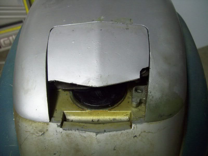

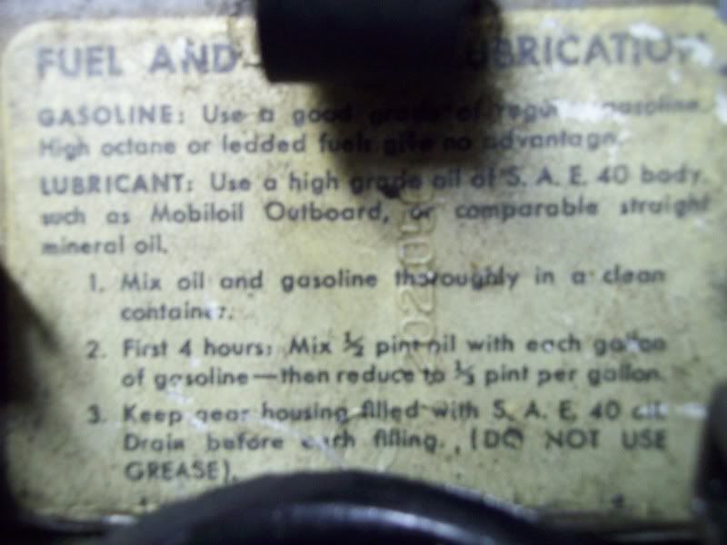

I will mix up some new gas for it next time I run it. The label on the fuel tank says to use SAE 40? It is spraying water out the vents. I will be replacing the impeller before it's done. Just had to hear it run before I spent time and money on it. I ordered a parts list of ebay last night and now to find the few little things missing. Looks like I'm just missing the control knob & spring and the lid that covers the fuel fill is broke would like to find a replacement for that. O.K. how about some more pictures?

I believe those use a metal impeller that doesn't require replacing. Water passages do clog though, so compressed air can check this. The main jet uses a spring behind the knob to hold tension on the needle so it stays at its setting. Use a good outboard 2 stroke oil, and it will run forever. If you have a fishing boat, you will love that weedless lower unit. Go to the AOMCI website and place an ad in the Webvertise section for the gas stopper. Not too hard to get, just have to look in the right place, and that's the place.
