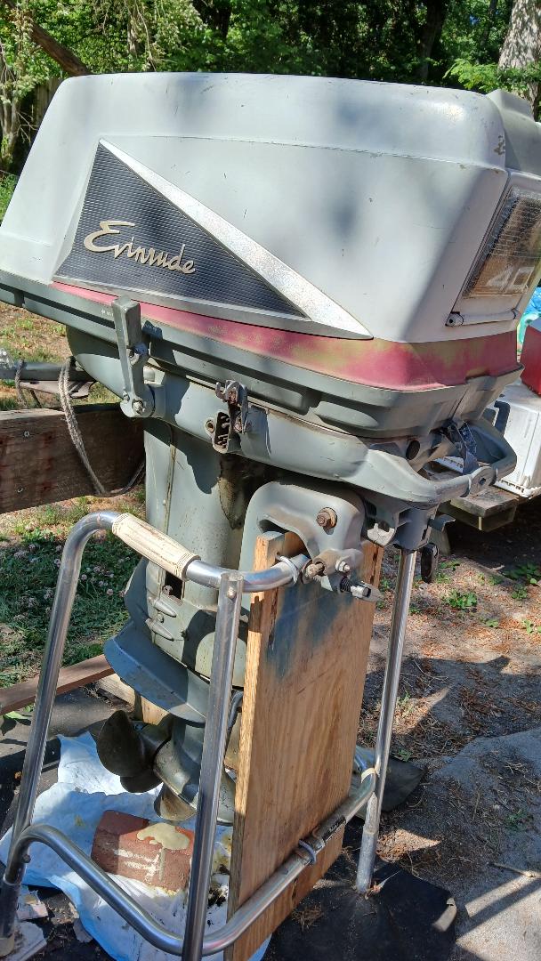

I can't get the motor into neutral or reverse, the lever moves to the different positions, the linkage seemed to move up and down. and as i run it is seems to be leaking gear oil.
I have two motors, the picture shows the parts motor which seems to change gears correctly, but it does not run. I was going to switch out with the one that runs

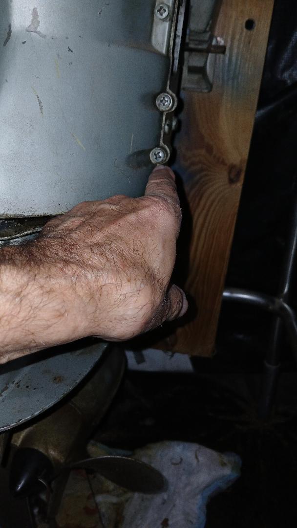

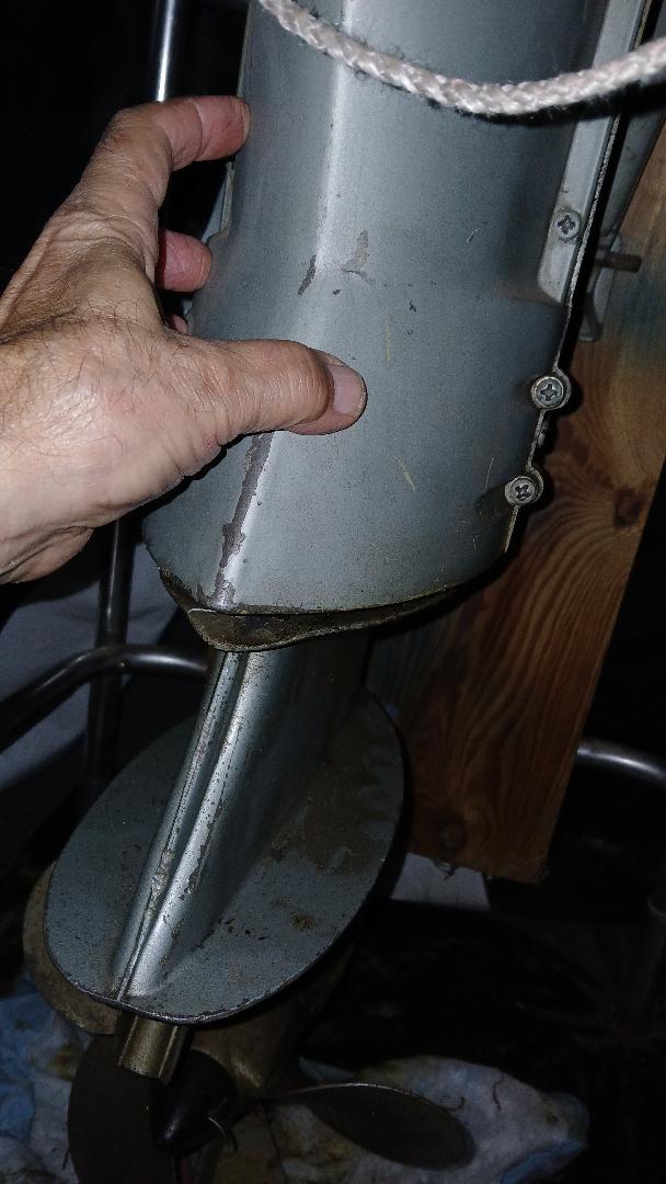

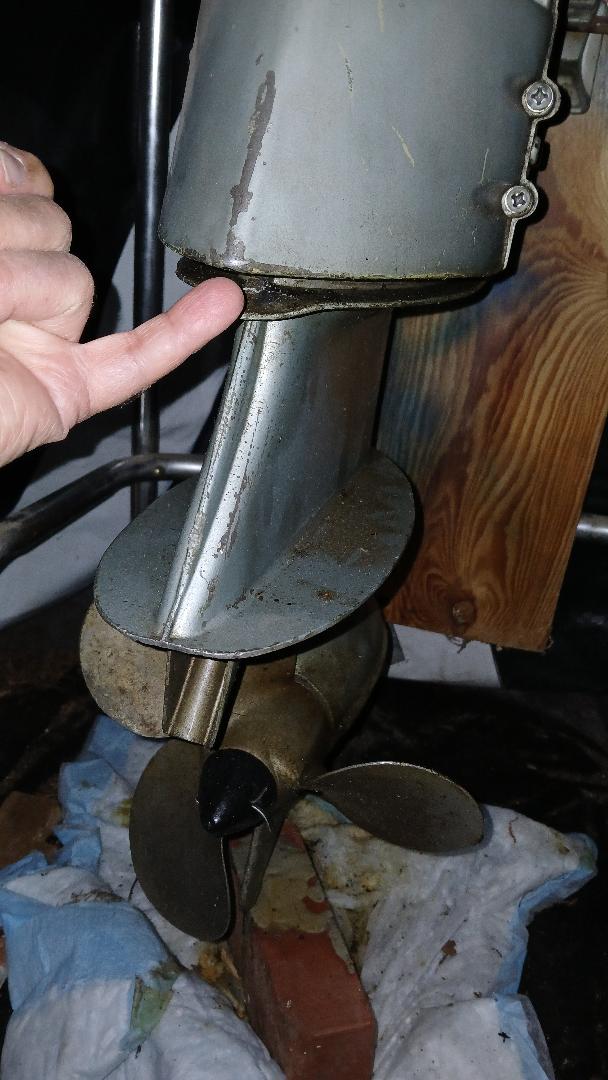

Ed, thank you. no book or videos explained it that way. so to get to that bolt the whole back shaft cover from above the lower unit to the bottom of the motor has to come off. that is just a crazy way to design something. I have to say in my frustration that thought crossed my mind but I just said that's too dumb to have to do that, lol. Also, mine are Philips head screws. i added some pics just to be clear. i will get that done tomorrow
