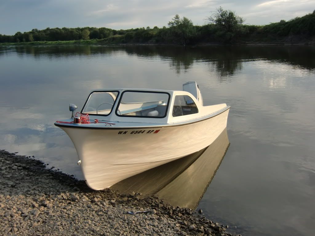

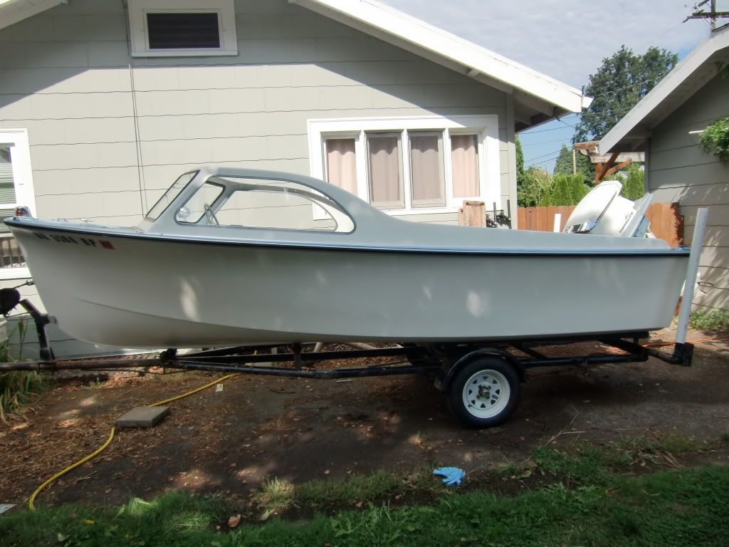

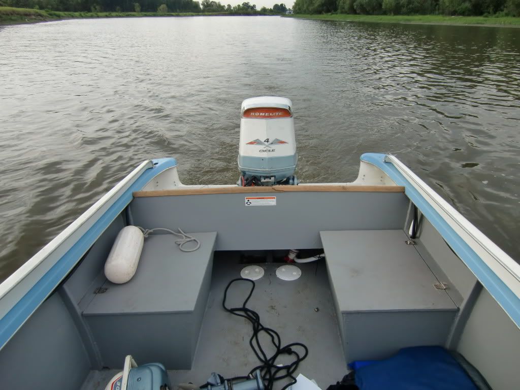

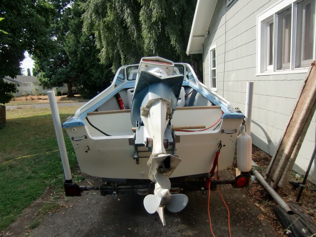

This forum has been a great source of knowledge when working on my homelite! I just finished a '56 16ft Bellboy with a '62 homelite and had a few questions. I replaced the lower seal, pan & valve cover gasket, and impeller and it runs great! No oil leaks. I had it out last weekend, and I got ~20mph at 4400 rpm. Does this sound about right. The motor ran great - no cavitation or anything like that. It currently has an 11" pitch prop on it. I was thinking of going to a 12" to get a little more speed? I "think" the boat weighs ~400lbs +motor, gear, & people probably comes out to ~1100 lbs. I have two 11" props, so maybe I should working on exchanging one for a 12". Pictures are below. Thanks for all the help!

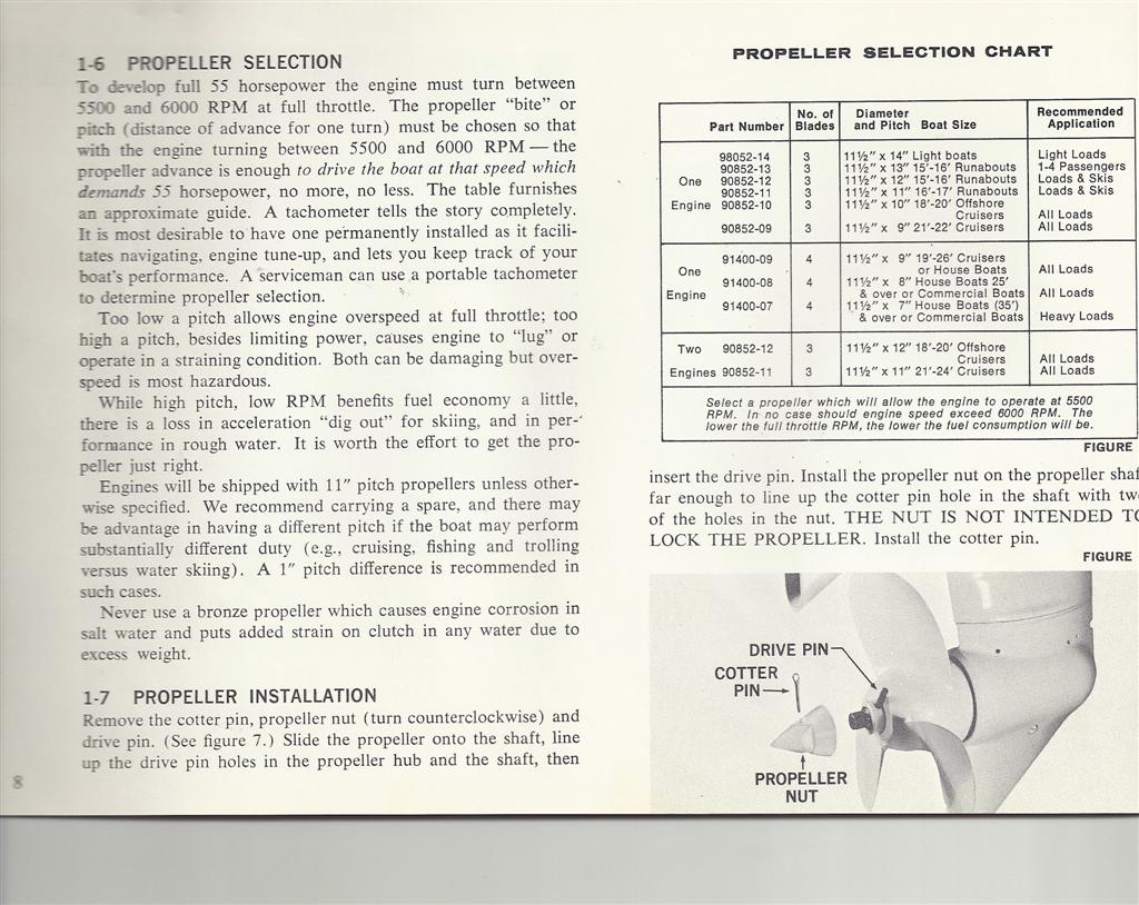

3. Run the boat per the attached copy of the factory Propeller Selection guide and record wot rpm.
Your boat looks pretty light, I think you will be able to run a 12 and maybe even a 13. But it depends on if you had 4400rpm at wide open throttle. If you did something is wrong as you have too much pitch now. So, the tachometer tells all.

John,
Forgot to say nice looking Bell Boy.
The boat matches the motor!
Looks like you did a lot of work.
Bravo.
