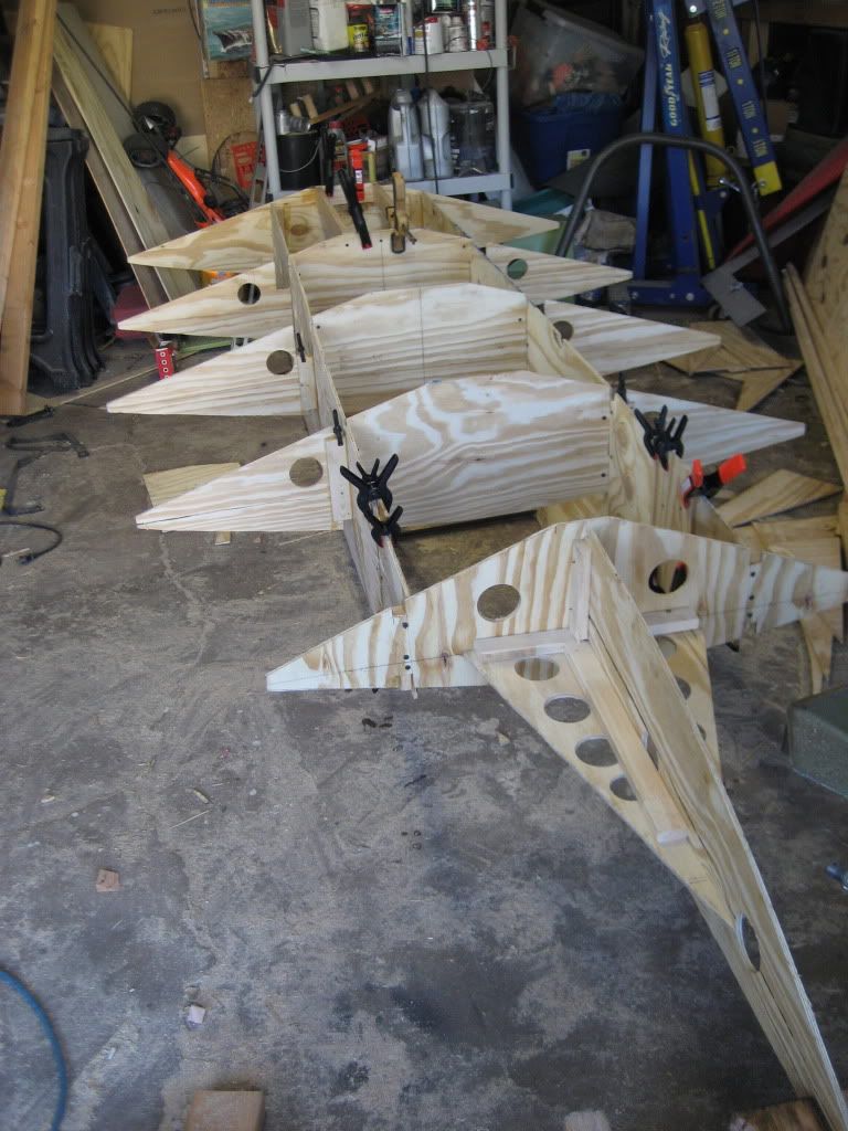

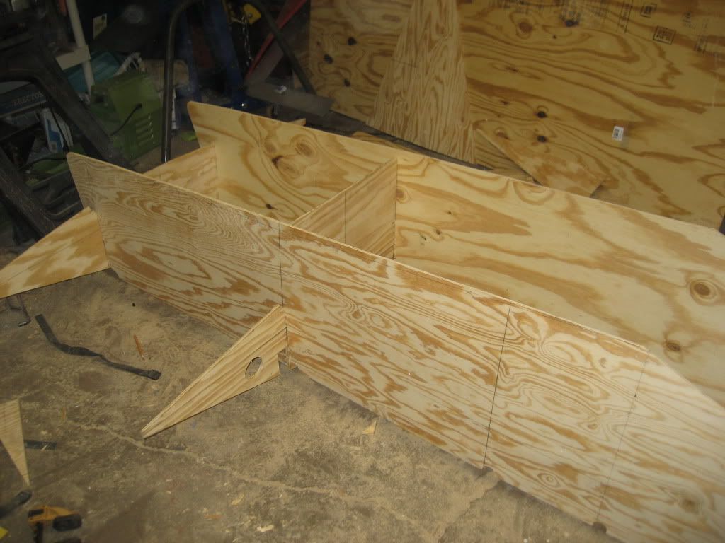

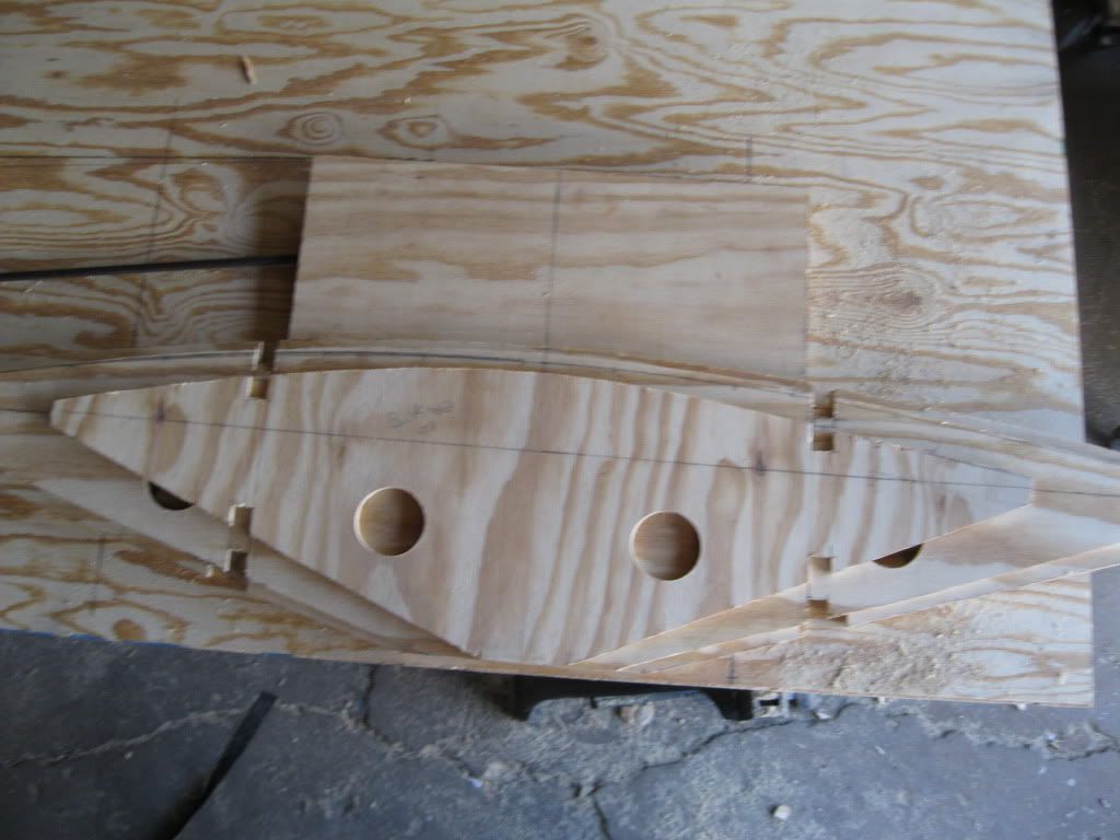

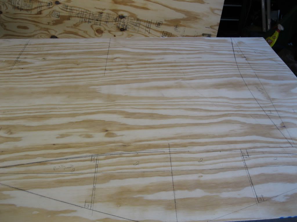

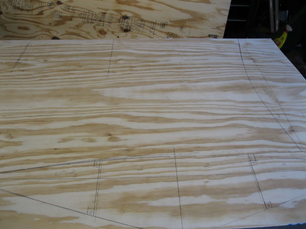

Laid out as many pieces on 1 sheet as I could. I was able to get all but the transom cut out of 1 sheet.

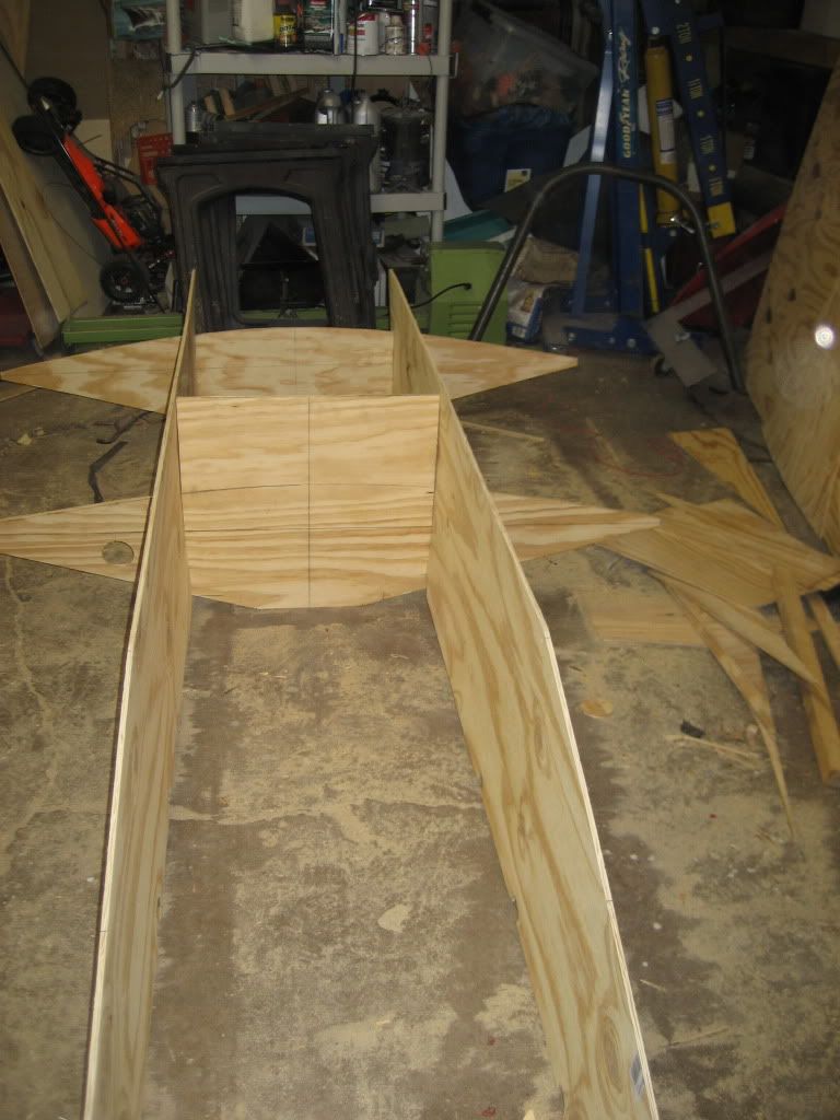

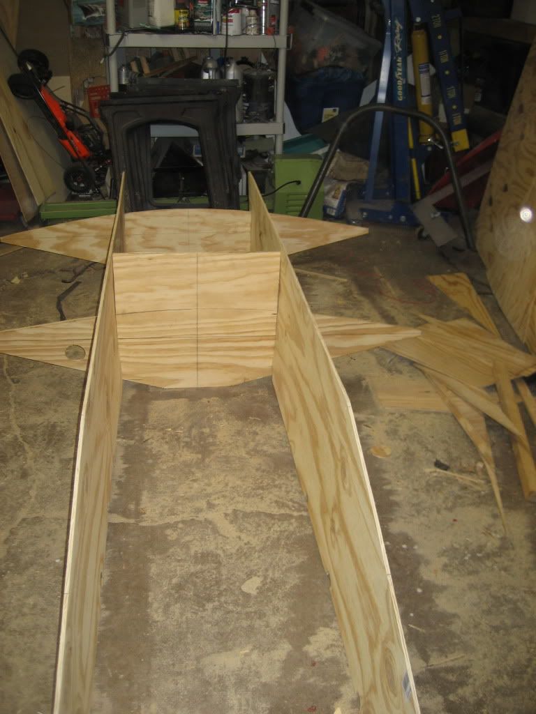

Here are the bulkheads laid out after cutting
Laid it out so I could see what it would look like

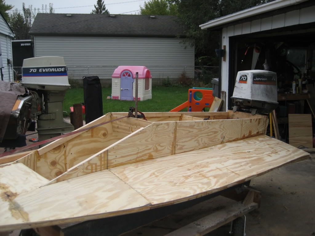

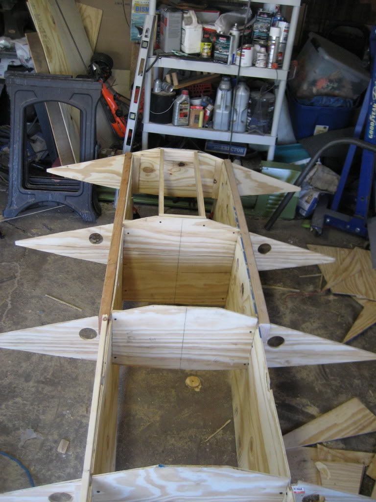

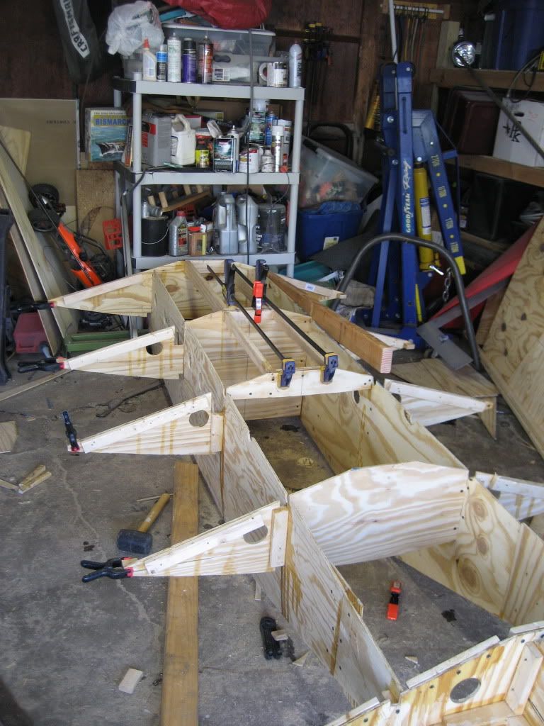

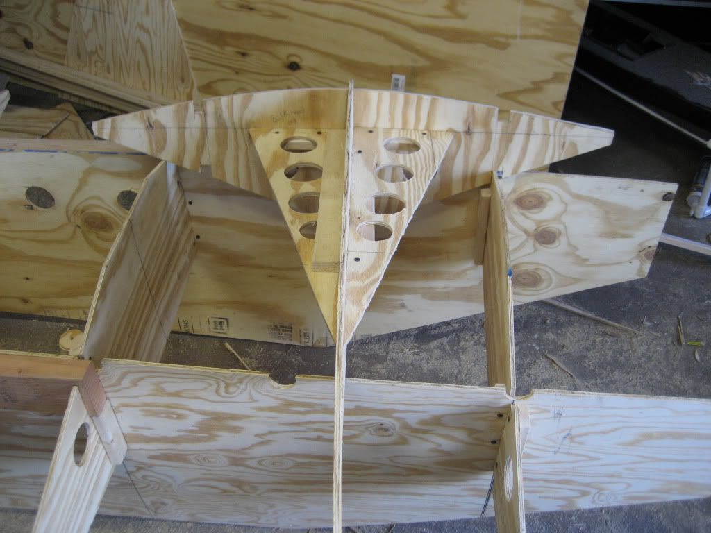

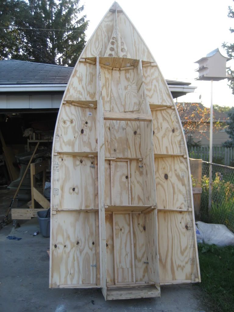

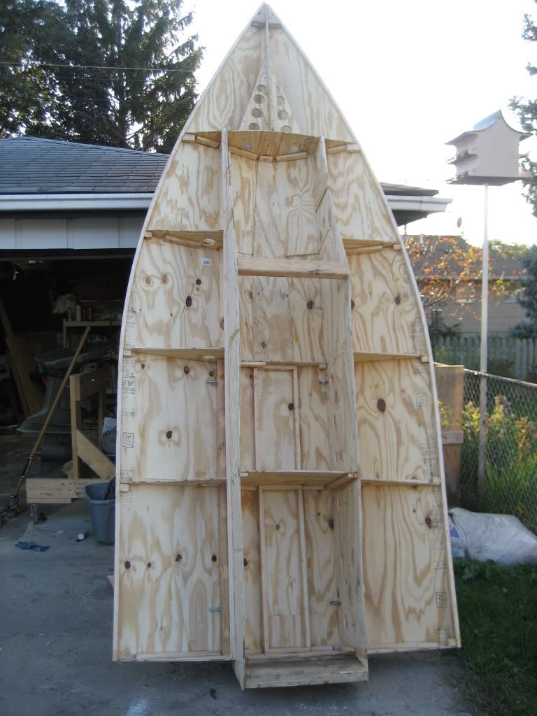

all the bulkheads dry fit
made few changes to the plans in nose
I started gluing the parts together. While I was waiting for the epoxy to come in, I dry fit most of the parts which made it quick to epoxy.
I added bracing to the bulkhead #4 to Transom area and some other bracing where the seat will go. This isnt specified in teh plans but I thought it was needed.

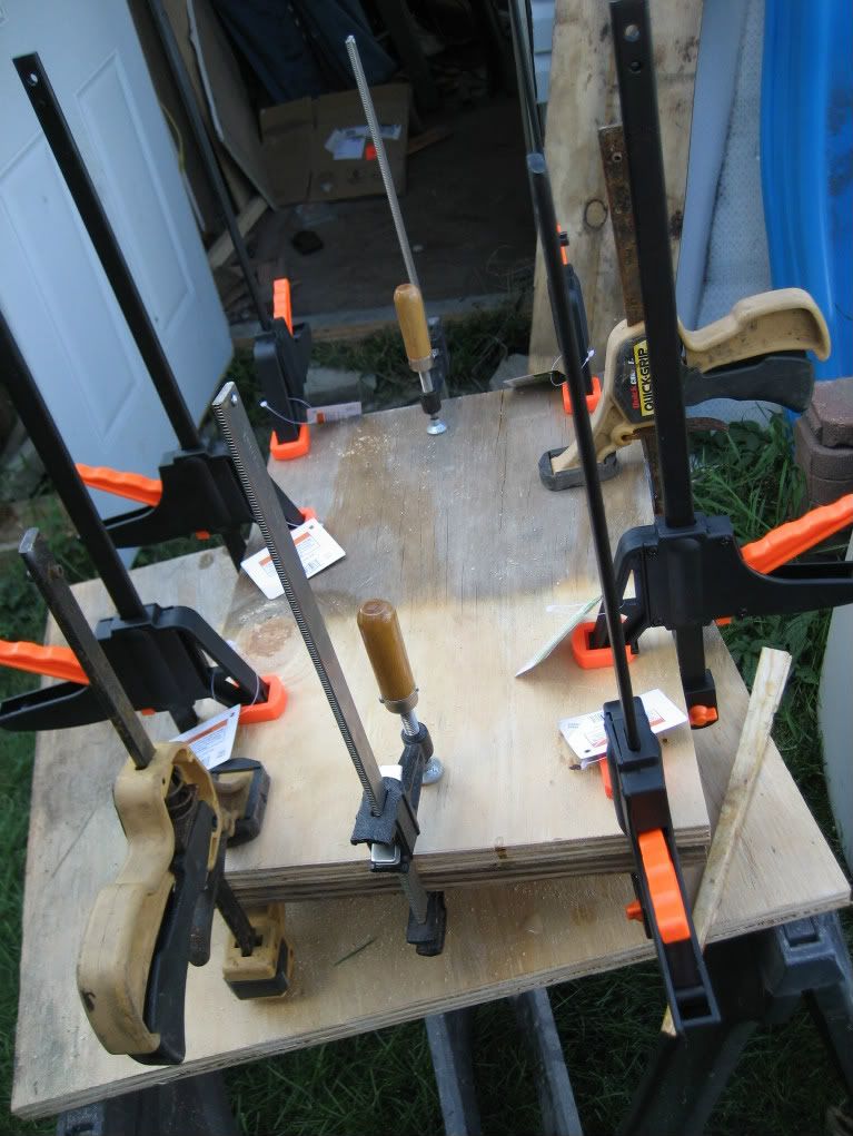

The motor plate is made from 2 pieces of 3/4"ply laminated together
This boat is going together really easy, its actually been a fun build so far.

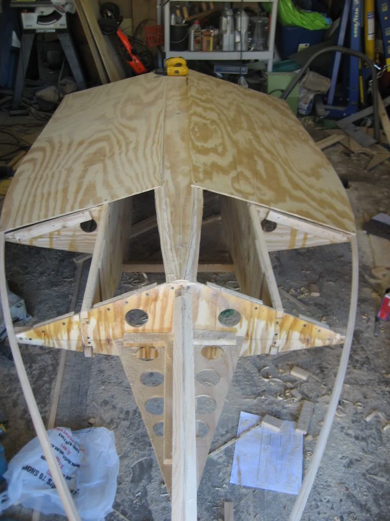

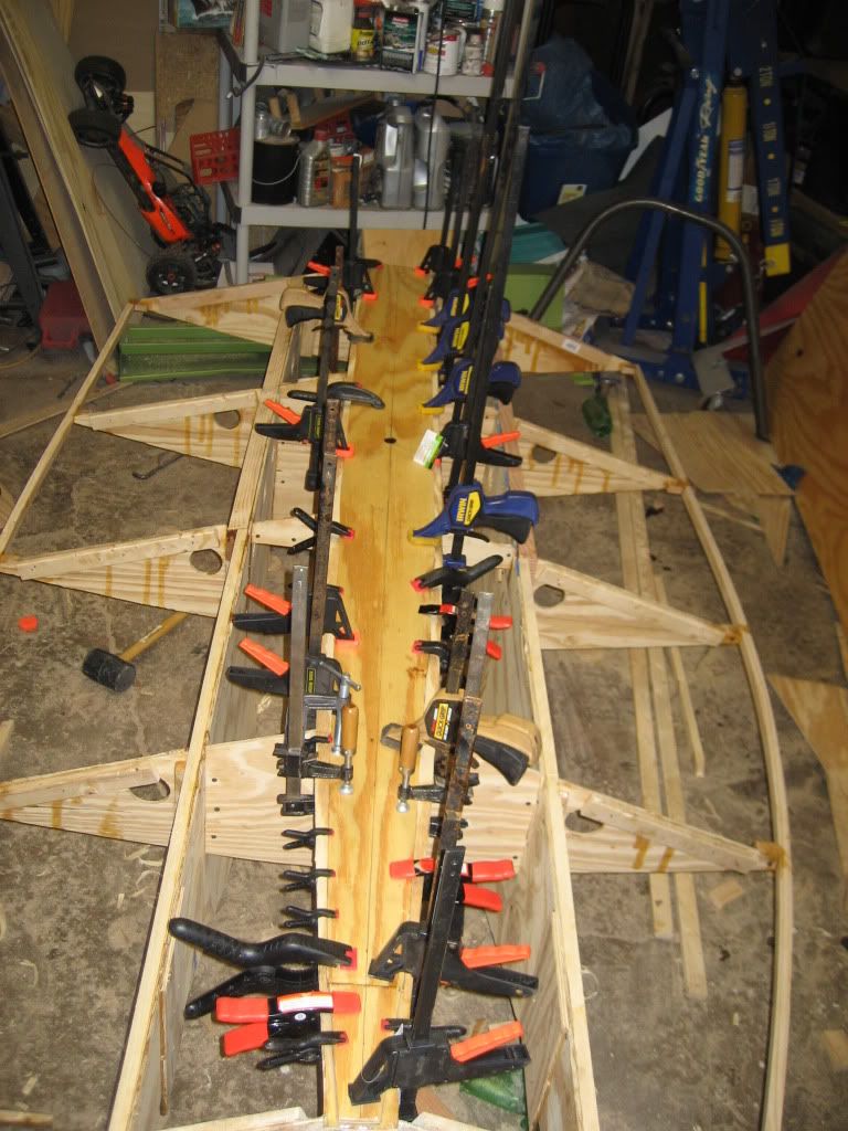

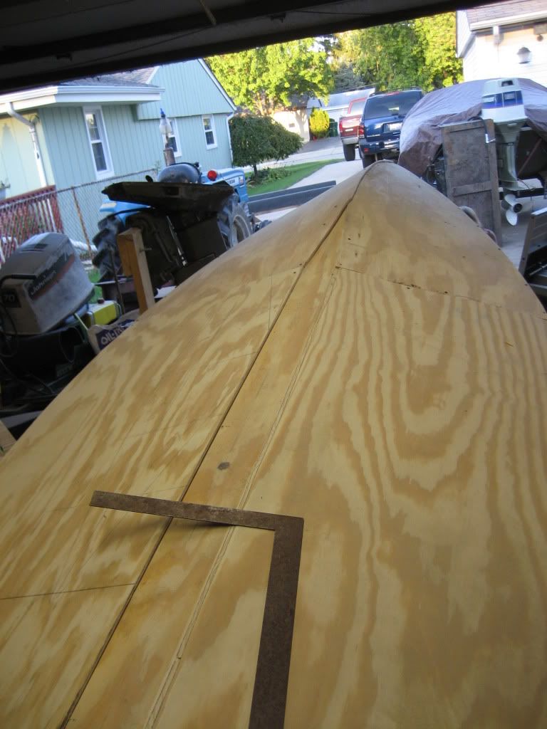

I bent the side rails and laid the keel... you can see in the pics that I went a little overboard on clamps

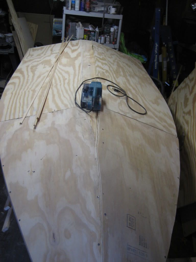

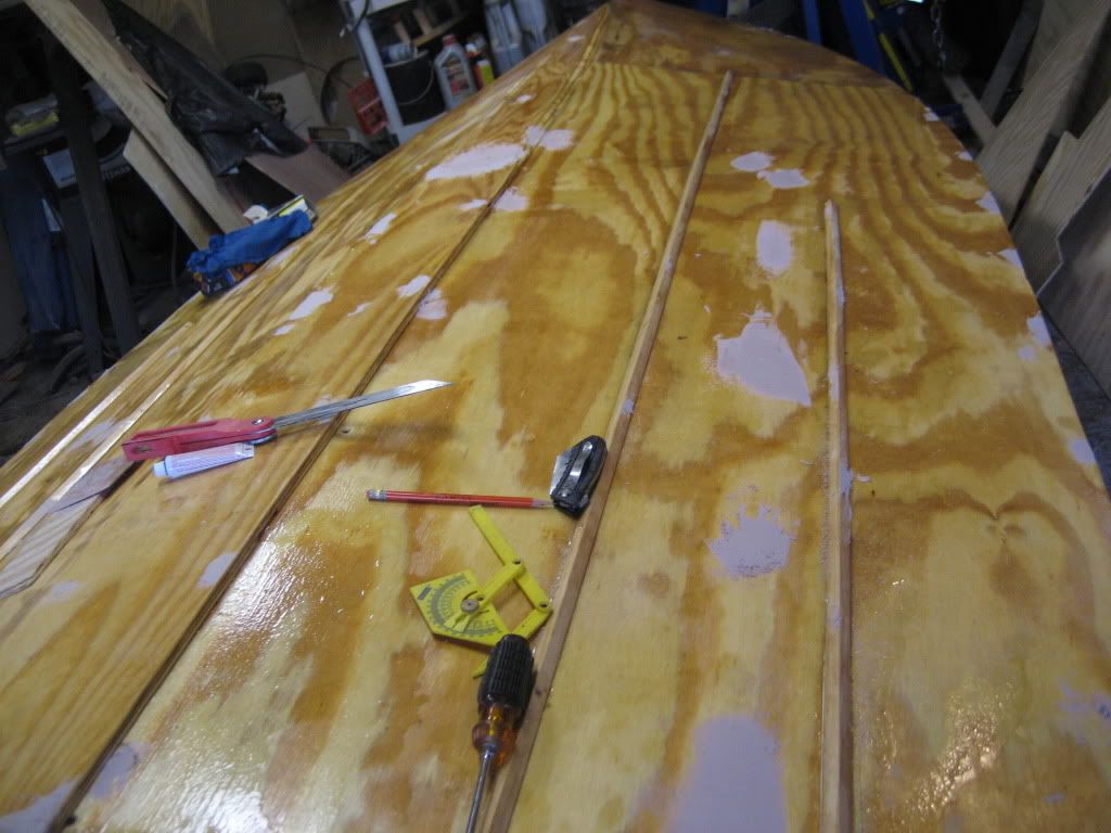

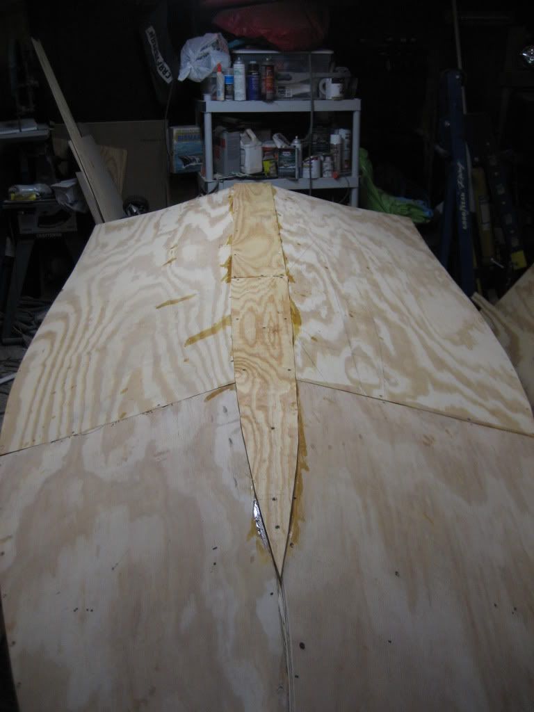

I started laying the hull yesterday... no boring details just pics:

Ride plate is roughed in... I didnt take any pics but I blended in all but the last 50" which is where the boat rides.
Then it was time to flip it... was easy enough to get it up on end myself but I had my wife help me lower it down

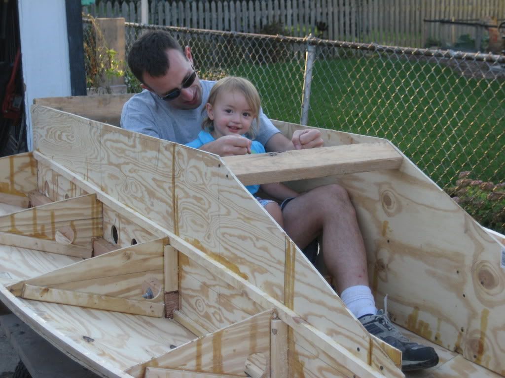

I had some help with the imaginary driving duty

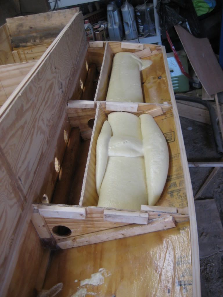

2 cu feet of floation foam... 1 in each side. This keeps the boat floating when/if I flip.

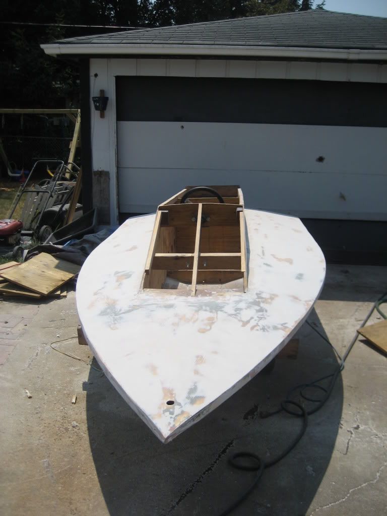

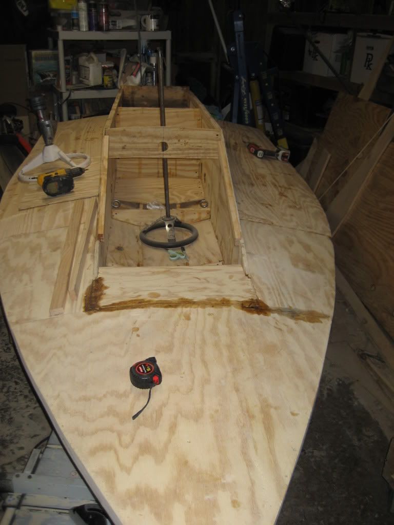

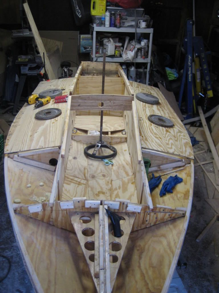

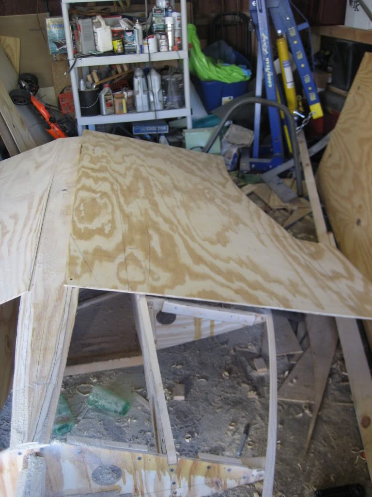

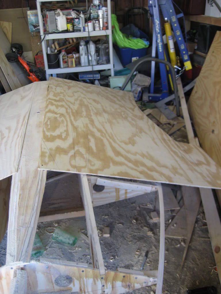

start of the top decking
Re:anyone want to get into racing???? 14 years 11 months ago #47676

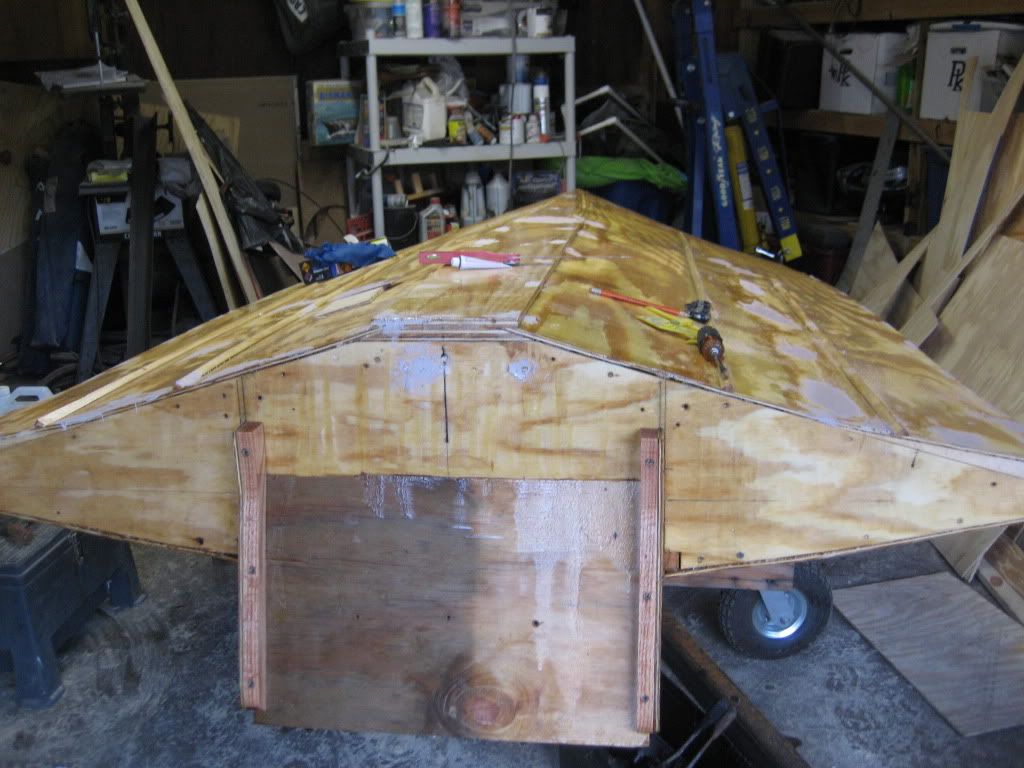

decking installed... though I dont like how I did it.

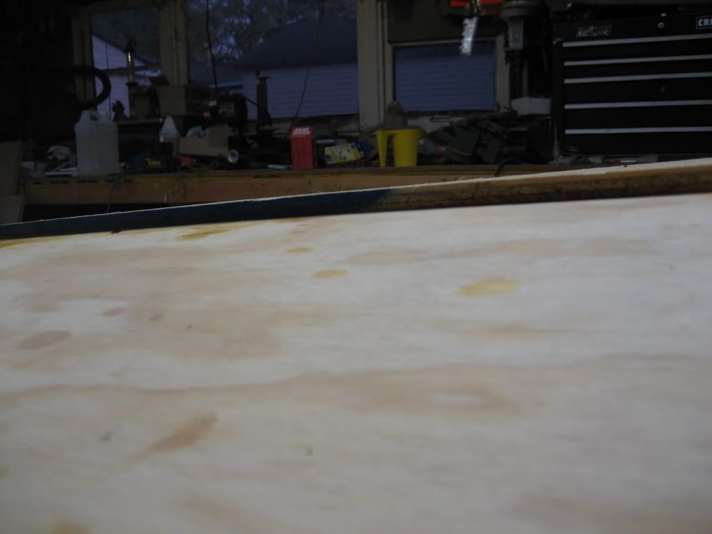

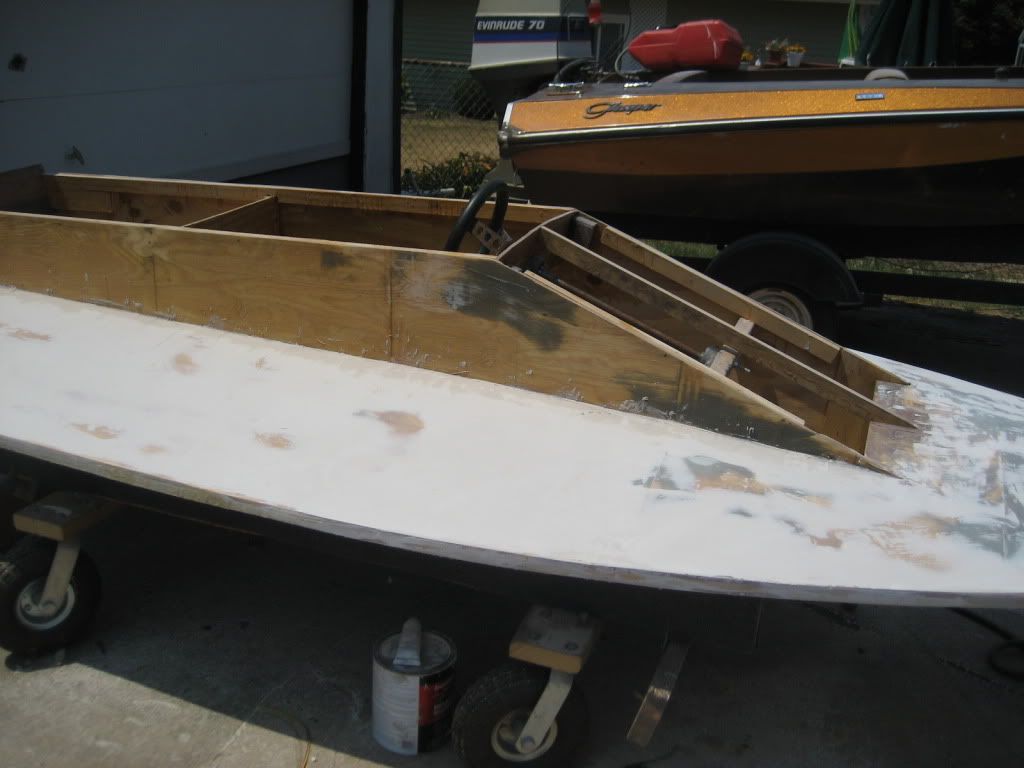

the boats been laying on its back for a little bit now as I sand,epoxy and fiberglass. I rough sanded the hull for adhesion and then laid down a coat of epoxy. After that cured I sanded it and then coated the underside with polyester resin. The reason I used polyester for the topcoat is to give a harder coating than epoxy tends to yield (and the fact that its 1/3 the price doesnt hurt). I still have to sand it all perfectly smooth but, its almost ready for paint.

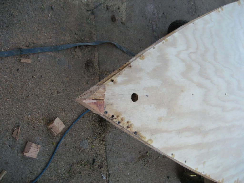

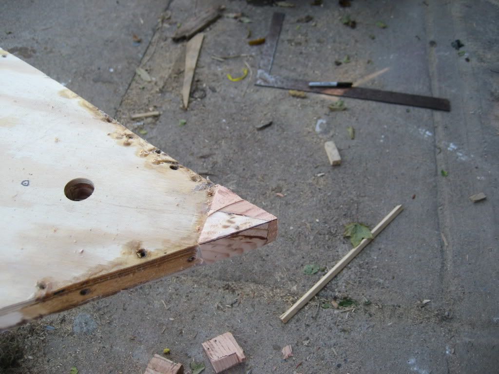

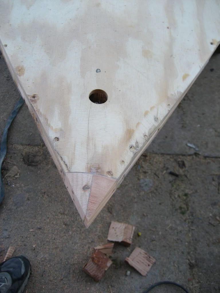

I had to build a nose since I couldnt get wood longer than 12' locally. I glued 2 2x4's together then glued them to the nose (that was cut perfectly flat and sanded). I then cut and sanded it to shape. I wish I would have taken pics from the beginning, it was an amazing transformation.

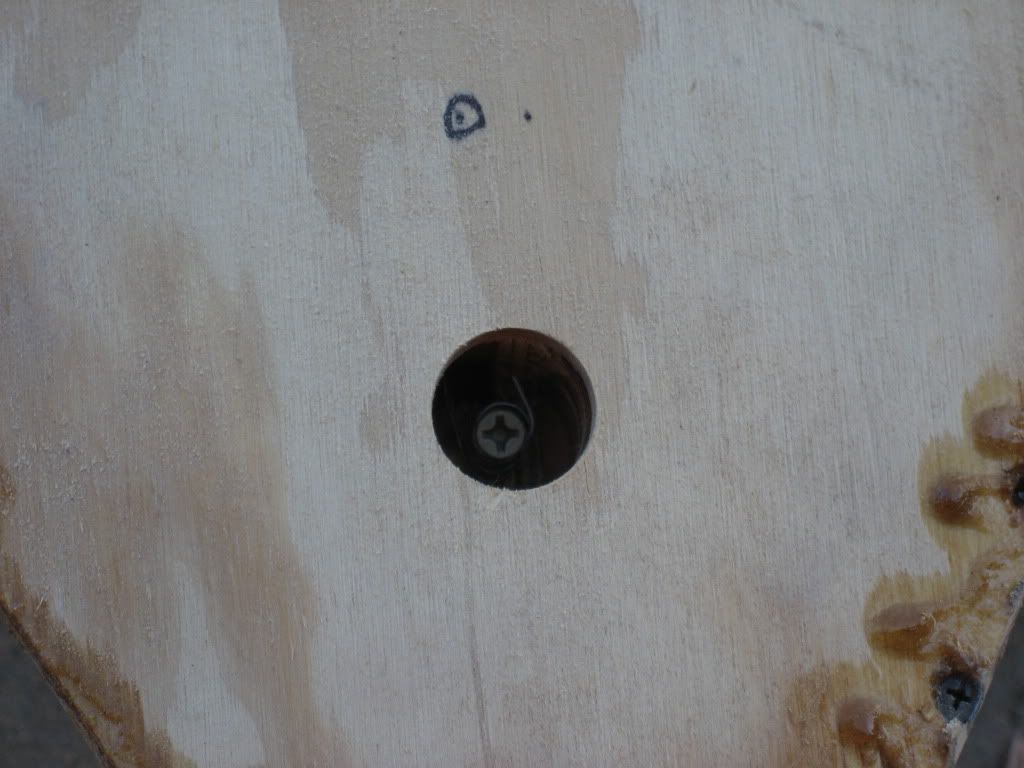

The hole you see is for the bow light. Since it wont be used just as a race boat I have to have lights. I was thinking ahead and cut a routing while the deck was off and then secured a wire with a screw that can be pulled out when I am ready to install the light.

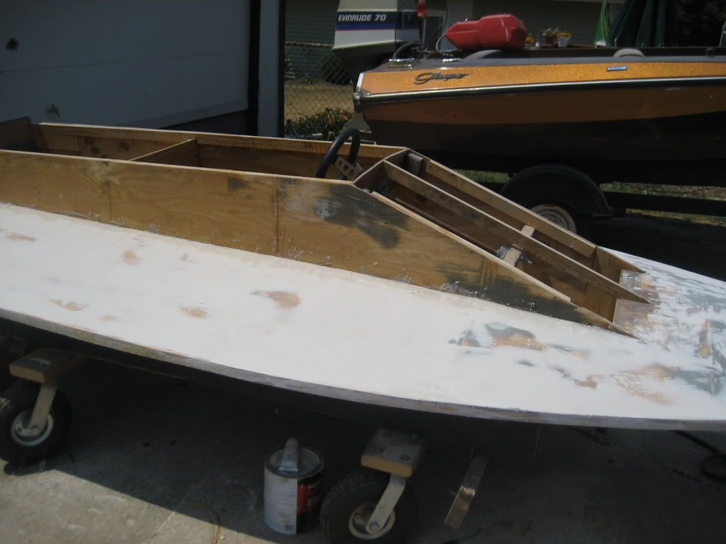

I havent updated this thread in a LOOOOOONG time. Ive done a bit of work and its days from being painted.
