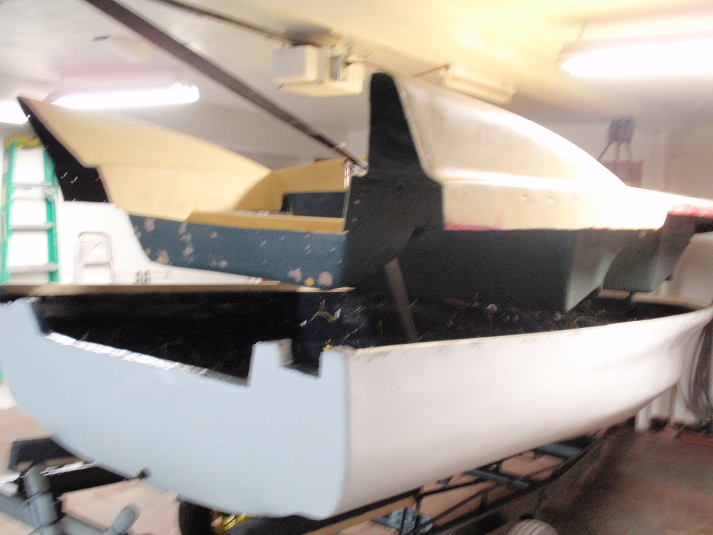

If you want to do it right completely strip all the trim off, sharpie the back with the location, take lots of pictures before you remove anything. Drill out the rivets, measure the inside width because when the top is separated the hull will spread out. Best to take some 2x4's and put bracing across the hull before removing the top. I didn't and ran into many fitting problems when trying to put the two back together.
Some of the trim is easier to remove after the top is popped. Once the two pieces are separated you can flip the hull and do any repairs and paint without problems.

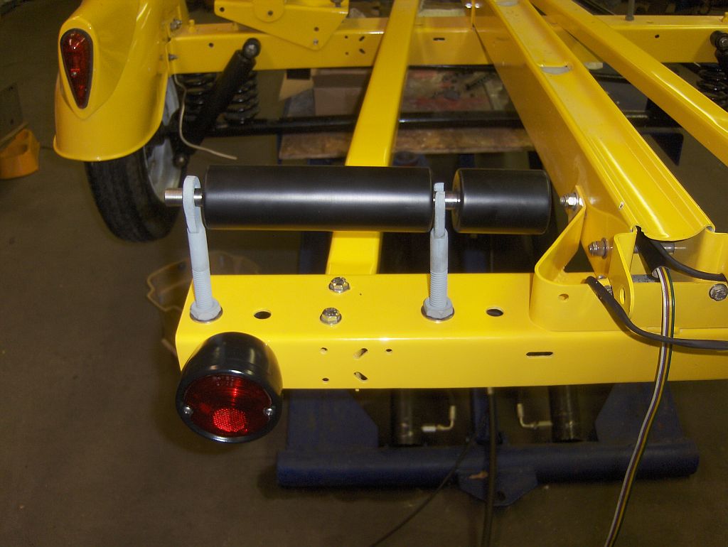

I have had a couple of TeeNee trailers. TeeNee made a number of different models and sizes over the years. Many of them did use the trailer tongue roller system. Usually a Herters works well on the rollers because of their aluminum keel.
I attached a pic of the rollers on my TeeNee. I assume yours has rear rollers and side supports like this.
It would help if you could post some pics of the trailer so someone more familiar with TeeNee's than I am can identify it and advise you if it's the right size for your boat.
