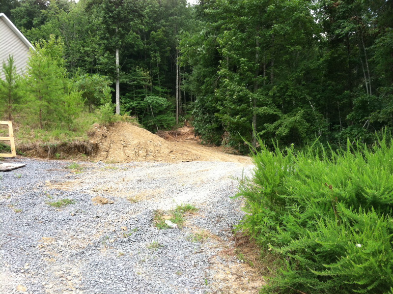

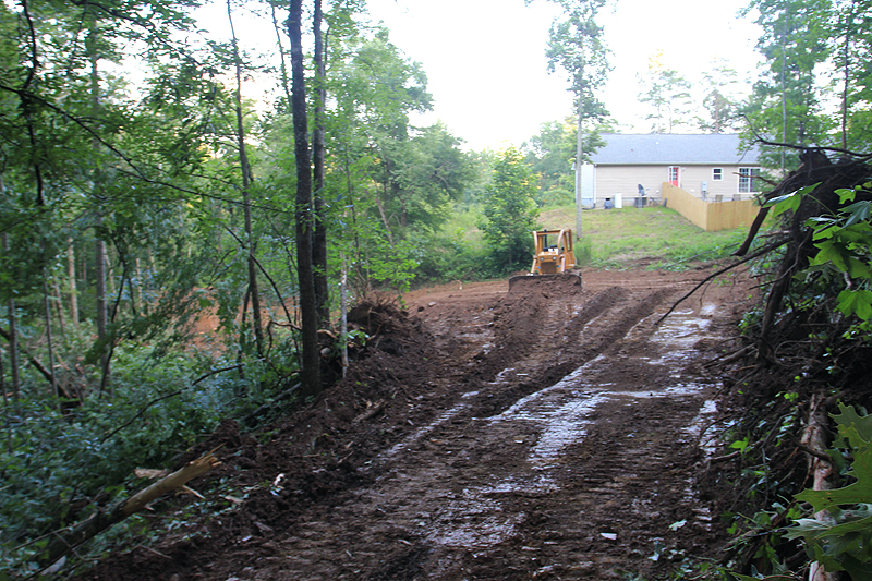

They're done for today- Probably about 1/2 done with the major dirt moving- Here's the new road-
It's 15' wide, and about 200' long back to the building site. They still need to do the finish work on it, and then it'll get a good covering of gravel.
This is the back of the building site, looking towards the house-
They will be dropping this area down another couple of feet, which will widen it considerably. They are going to be packing it all in, but I am going to give it some time to settle before building.
They also continued the road all the way behind my house, so it connects to my existing driveway, so I've got a loop all the way around my house now (can we say RACETRACK?? :) )

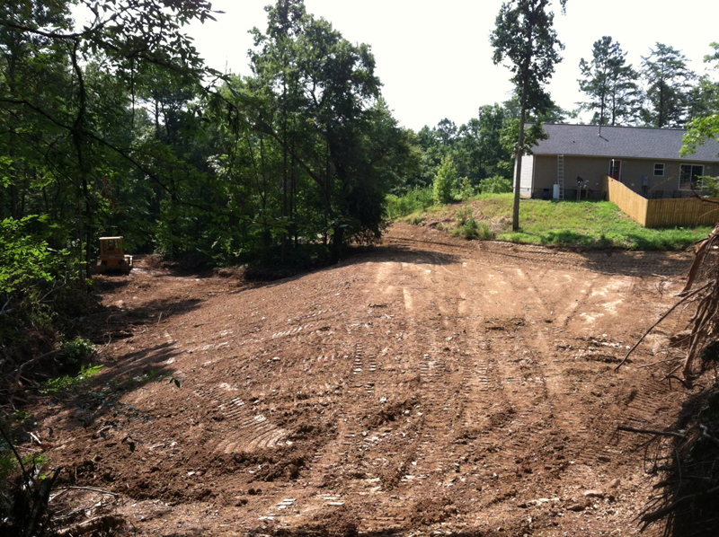

Despite the HOT weather, they got the site prep work done this week. It looks VERY different back there
now. They had to cut a new driveway back to the site, the old location would have been too steep of an approach, and I'd have spent a small fortune on fill dirt to make it work-
The old driveway will be covered in stone, and used as a parking pad. I can fit a LOT of boats down there- and it's in the woods so the wife will never know :)
This is the pad where the building will go- Looking towards the house. I'm going to be able to fit a 24' x 48' building there- I had planned to do at LEAST 24 x 36, but that extra space is always welcome!

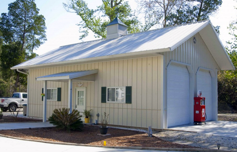

I'm in the final planning stages now- This is an idea of what I'm going for-
This shop is 24 x 36 x 12, mine will be longer, and I think that at the one end I'm going to do a single 14' x 10' door rather than two 10 foot doors, in case I ever want to get anything wide in there...

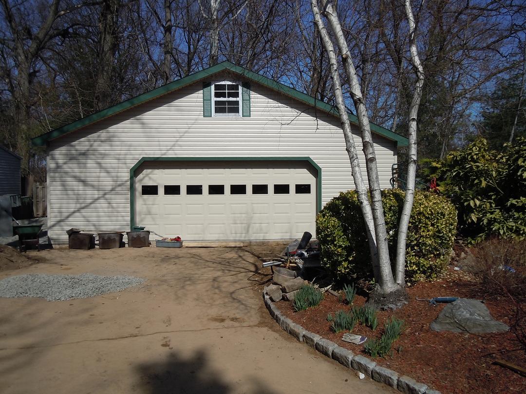

sure is..i paid 24k for my 24x30 on a 6"slab.

Ron, that's a nice looking building!

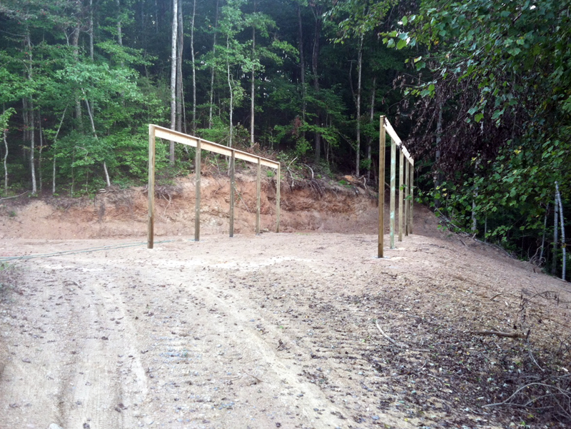

Well, the final meeting with the contractor went even better than expected!
We looked over the details, to make sure we were both on the same page. Then he told me "I've got my crew, hole digger, and lumber here- You want us to set the posts tonight?"
Of COURSE!

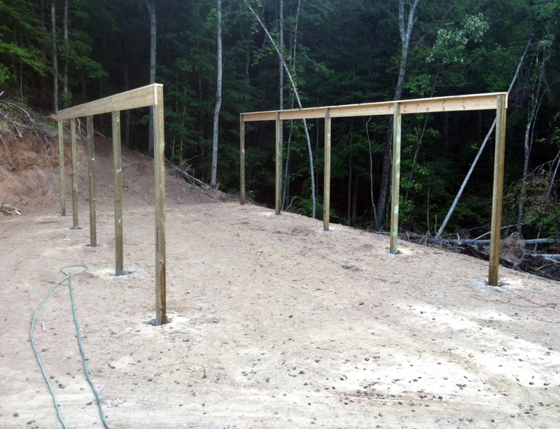

So, The posts have been set and trimmed, girders installed, and top plates on-
This is the approach from the driveway. The big (12' wide) door will be on this gable end-
The next step is to have the concrete pad poured...

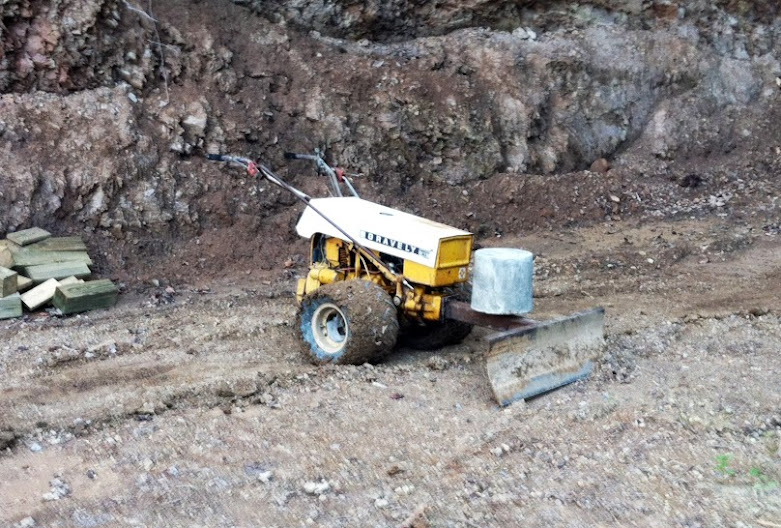

The gravel was delivered while I was at work, and I had a few hours after work to start spreading it. The dump truck driver did a good job of the initial spreading, which saved me a LOT of work-
Luckily, a helper showed up with her bulldozer to help-
After a couple of hours of raking and shoveling, I had it 'roughed in', and the back 1/2 or so leveled, using string running from side to side-
It'll need a bit more leveling up in the front, where the pad was a little low, but I should be able to get it all done before the weekend!
The Gravely with it's grader blade was a lifesaver on this project- it made quick work of moving the gravel!
-Andrew

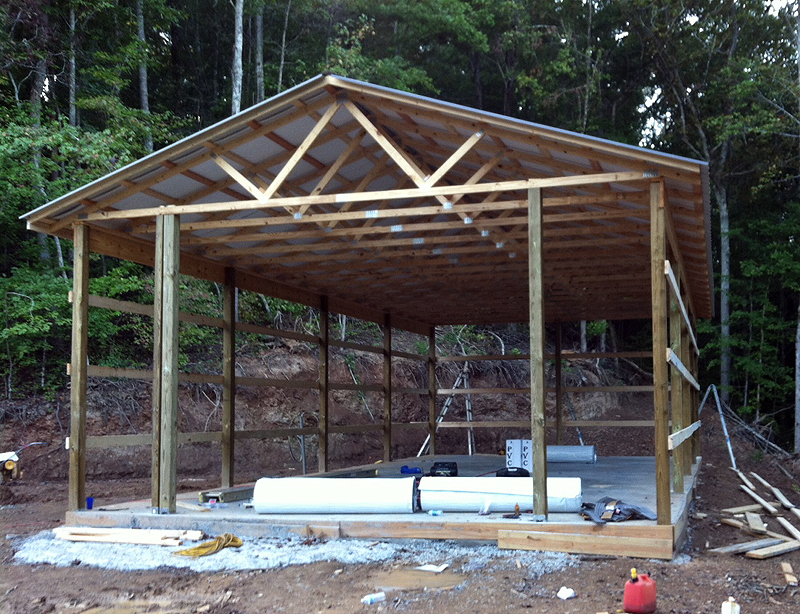

Real progress today- The builder started on the roof when I was at work, and when I got home it looked like this-
The trusses are up, and the insulation is going on. They worked 'till dark, and got the metal on the roof tonight. I'm sure that they were anxious to get the roof complete, as that is one of the 'milestones' in the construction that means they get another check :)
It is starting to look like a building now. It also looks much bigger, too! I'm sure that'll change once I start putting all my toys in there.

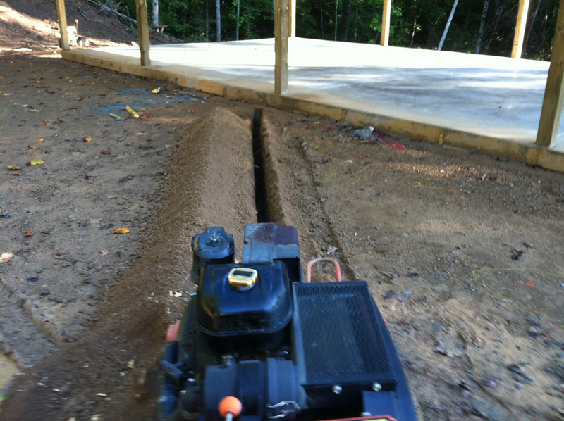

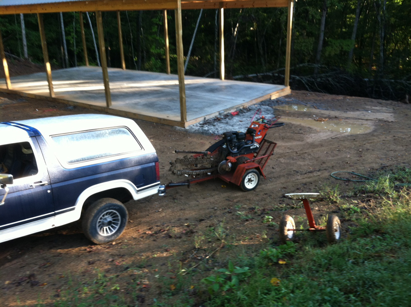

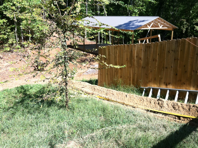

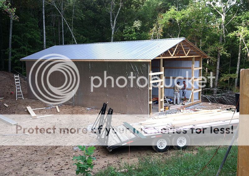

I got to have some fun with the Ditch Witch this weeked-
It made quick work of the trench- About 100' of it, 32-36" deep.

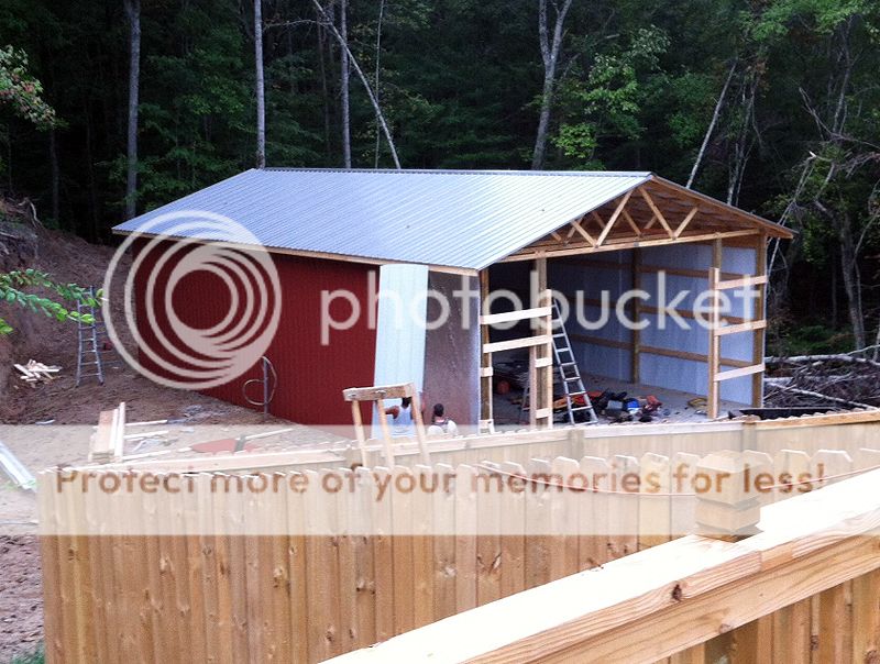

And, the builder was back today. This is what I found after I got home from work-
They've got the siding here, and the doors should be ready to go. I ended up making a last minute change, and went with a 14' wide door rather than the 12', since it was only $130 more.
I also had cut the insulation out of the walls, for budget reasons. It was going to be $700-$800. But, I found a guy on Craigslist last week that was selling 6' x 125' rolls of radiant barrier bubble insulation for $70 each, and at that price, I couldn't pass it up. So, the walls will also be insulated.
They are supposed to be back tomorrow, and will hopefully get some siding up! They are supposed to be done this week sometime. It won't be long before the toys are moved in!

Insulation is done on the side walls-
And, the siding is going on-
Coming along now. Other than the garage door, it should be done this week... I can't wait to start moving in!

Shelby18 wrote:
Looking good. Are you going to insulate the ceiling? And maybe hang some fans? What will you use for lighting? Details, details.
The roof is insulated with radiant barrier/bubble insulation. Since I don't plan to keep it heated full time, that should be sufficient for my needs, so I'm going to leave the ceiling as is for now.
Lighting will be fluorescent, I plan on putting 8 fixtures up (one per 12 x 12 bay). The fixtures will be low profile, so they don't get in the way- I'm not SURE what I'll ever need the 12' plus headroom for, but if I ever DO need it, it is there!
I don't plan on using ceiling fans, since they'll be hanging in the way. I have a couple of big industrial floor fans that I use, which should move PLENTY of air. Heat will come from a portable propane forced air heater, which I'll use only when I plan to be working.
They are working on it today- and things are getting REALLY close... It won't be completed until the middle of october due to a delay in getting the 14' wide door, but once the walls are complete, I can start on electrical and start moving in.
-Andrew

Sorry, I couldn't see the insulation.
I would recommend T-4 fixtures. The 8' bulbs are getting hard to come by, at least on the left coast. So it's only a matter of time before everyone else gets hit. Plus they are more efficient. If you are doing painting I'd get daylight so you can see what it will look like in the sun. I just went through this exercise in my factory. Thought it might help.

I'm going to be using 4' fixtures- They're cheap... Of course since the shop isn't going to be heated full time I will make sure that the ballasts are good for cold areas! I've made that mistake before, may of the ballasts out there don't function correctly under 60 degrees!
They got most of the siding on today, just have some trim to finish up now... Of course it was too dark to get photos of it by the time I got home, so it'll have to wait until tomorrow.
-Andrew
