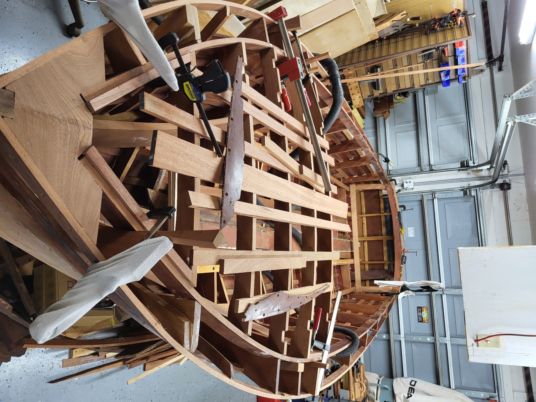

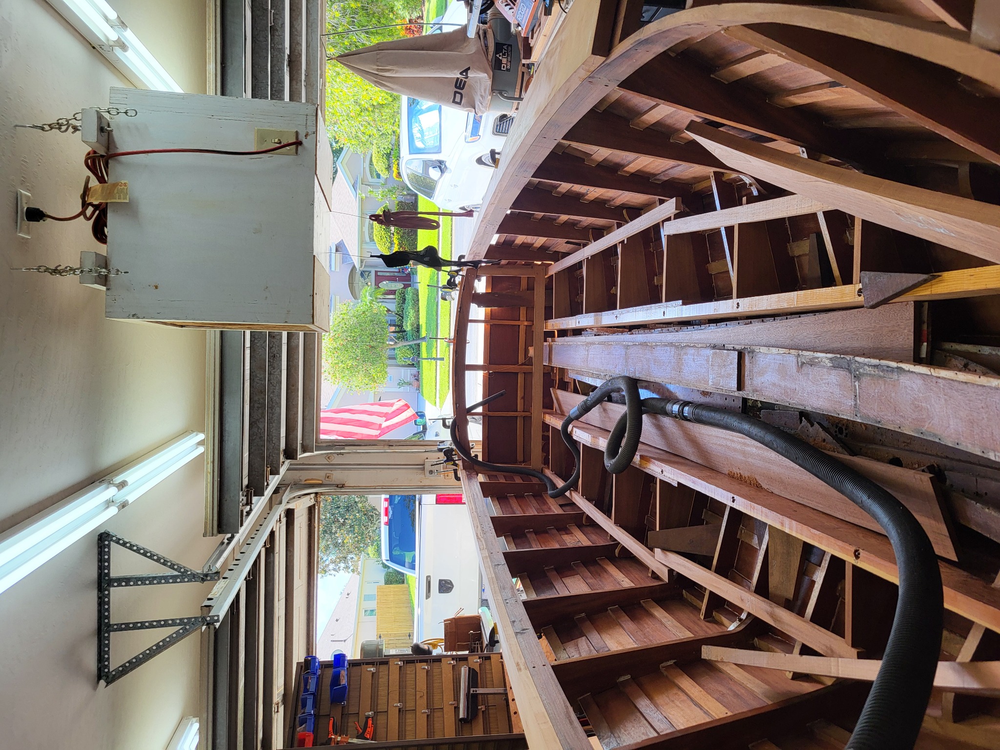

Holy crap has it been a year since I posted!?!?!!!?!? Well I left Northrop Grumman and started back at my old company from Maryland but get to work from home and travel to where testing is needed. It's been keeping me pretty busy but I have been getting stuff done on the Resorter. I need to get this damn thing dome before I can'e even get in it to launch and use it!
So I did get her flipped over and here is her surrent state. Back deck beams and battens are done. Got the fron beams in and the batten beds routed out with the new toy. I'm finishing getting the battens all cut in, then removing it all to CPES it and permamnetly install it. If you look in the bilge, the deck wedges and out support beams are there, They have to be CPES'd and installed permanently also.
I'm also going to make wedges for the intermediate frames and make 'horse shoes' for the intermediate frames, that attach to the Chines. This prevents the tabs from cracking/breaking, which was notorious on these back in the day.

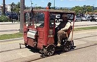

I haven't been on here in several months. Your Century looks great...so great that it looks like I did the work! Just got the last boat I'll ever restore out the door. I'm now officially retired. Rather than sit around watching Laverne and Shirley reruns, I bought another restoration project...a rail speeder. It's one of those things that used to be a railroad inspection car but pickup trucks with retractable train wheels made them obsolete. Running them is a big hobby now. (narcoa.org) The body of the one I bought is total junk so I'm going to build a "woody" body...white oak, Honduran mahogany and ribbon sapele...a good use of the leftover lumber in the shop.
