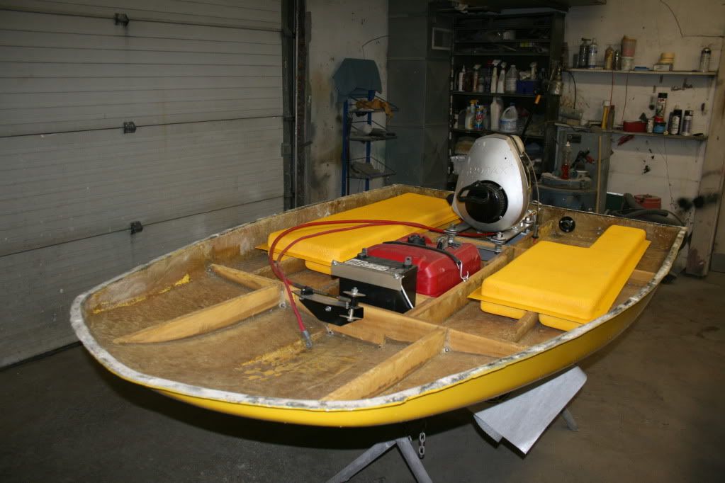

Here is a picture of my motor and tank . .

I utilized a 3 gallon Attwood gas tank.

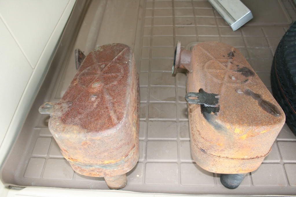

The stainless muffler far exceeds the muffler of 1968. Two shot 1968 mufflers were sacrificed to determine the factory construction, and then custom built. There was no other choice.

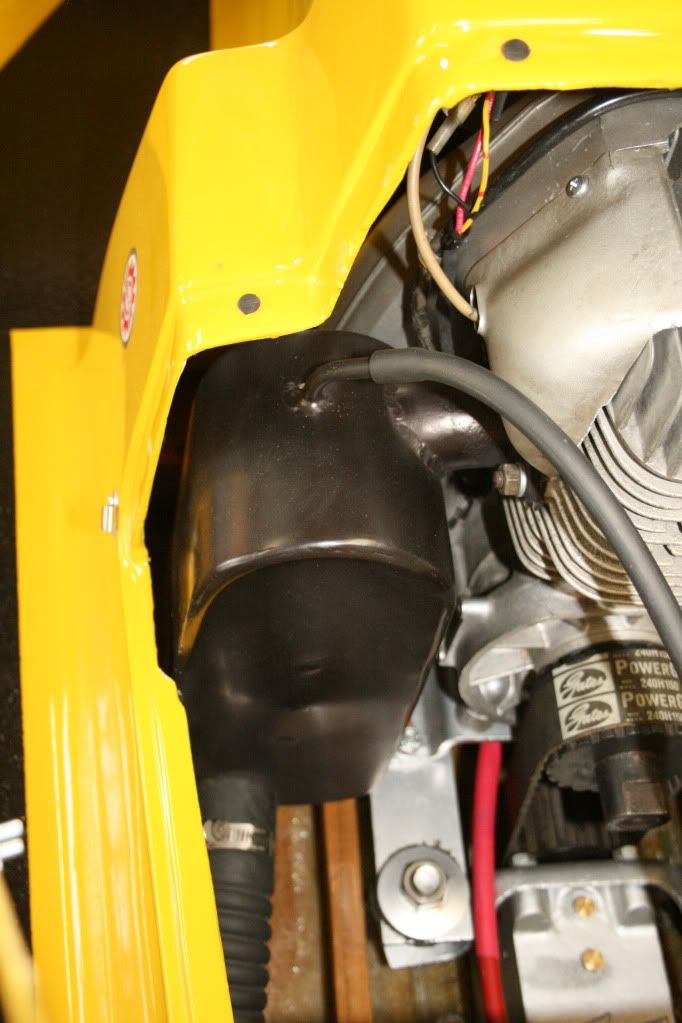

7. Curious how you did your venting, could you provide a picture of where you mounted the blower motor, and how you wired it? Looked through the pictures a third time, and not 100% certain.
The muffin fan is 12 volt wired hot into the battery with a hidden toggle switch under the raised seat. Wired hot so as it vents the engine compartment of gas vapors while eventually inserting key. ALWAYS lift the seat for a proper amount of time to aid in further alleviation of gasoline fumes. Probably overkill, however “safety first”.
