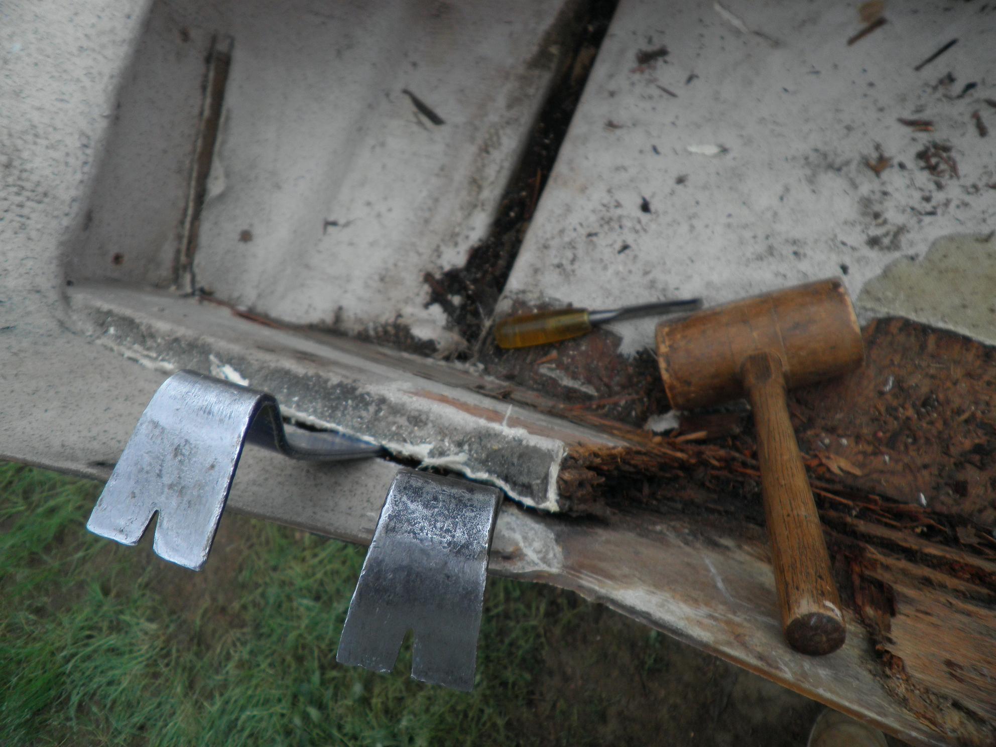

This is a good thread - it's nice to see someone digging into a new project. My projects are stalled and covered in snow right now.
For what it's worth - I seldom use power tools to dismantle the wood and fiberglass structure of a vintage boat. I've taken many apart over the years, and the fewer power tools I use, the better. Using power tools to cut creates a lot of glass dust, and it can be risky. I normally use a heavy rubber mallet, a wonder bar (flat steel pry bar, a junky beat up wood chisel, and a carpenter's hammer. The rubber mallet and the wonder bar do the majority of the work. The trick is to find seam in the tabbing and jam the flat bar under it to start breaking the bond. You get the joint to pop, then follow along the line of the joint to continue the separation. With practice - you can follow a joint most of the length of the floor without stopping. Tabbing can often be completely torn away from the hull without damage to the hull structure. There are times when this is not the case, especially in boats where the builder used a lot of material. Most of the old boats were lightly, and often poorly assembled. Stringers can be removed by popping and tearing the tabbing on one side only, then push the stringer over to the other side to crack the tabbing at the base. The remaining tabbing can be torn out, or ground / sanded to prepare for new construction.
Re:transom replacement 12 years 8 months ago #87268
Just be careful if you're prying AGAINST the hull or exterior transom skin. Flat bars make really interesting shaped divots in old crazed fiberglass & gelcoat......

"Just be careful if you're prying AGAINST the hull or exterior transom skin. Flat bars make really interesting shaped divots in old crazed fiberglass & gelcoat"
Yes this is a very good point that I neglected to mention. The flat bar always kept parallel and flat against the outer skin, and used mainly as a tool the get under the tabbing. Using the flat bar as a pry bar is a big no-no when the back of the bar is against the outer wall of the boat. As long as the bar is just coaxed under the tabbing, or wood, it normally will not damage or stress the hull. It just takes a bit of practice to see what works best on each situation.

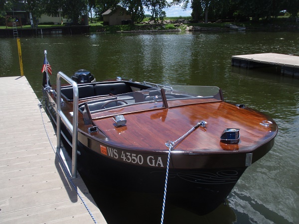

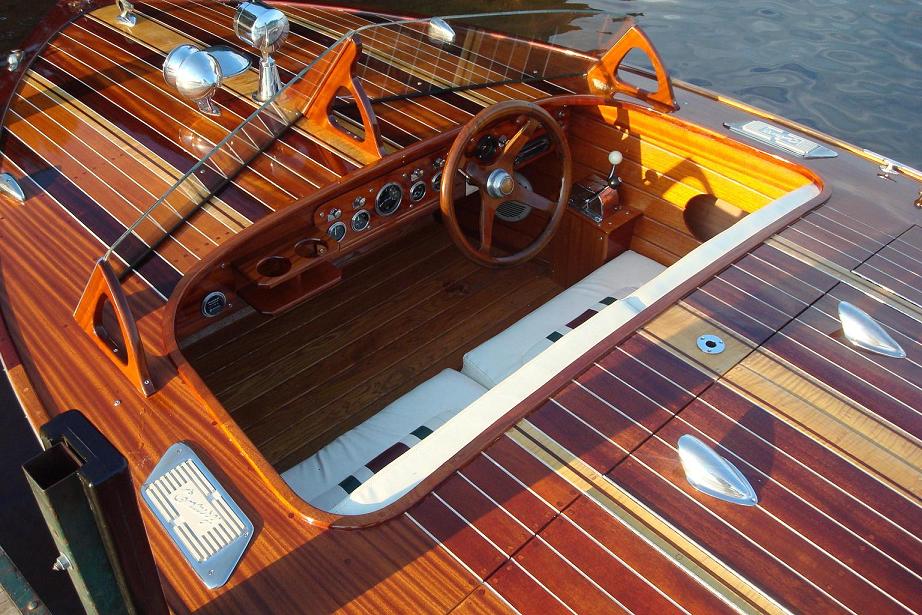

Another option is suspended solid wood planking. I admit that it's a bit over the top but it just looks so damned nice! The decking in the photo below is 7/16" x 2-1/2" white oak, spaced about 1/32" apart to allow for ambient moisture swelling and pass through of rain water. I secure the planks with stainless screws, plugged and sanded fair. On a boat with a solid floor, I have used 1/4" "stringers" placed fore to aft which raise the planking so that water can run beneath to the transom drain/bilge pump. Of course, mahogany could be used just as well.
I once re-decked a vintage Chris Craft 24' cruiser this way using mahogany and added a 5x7 oriental rug with PVC "rattan" deck chairs. The combination got rave reviews.

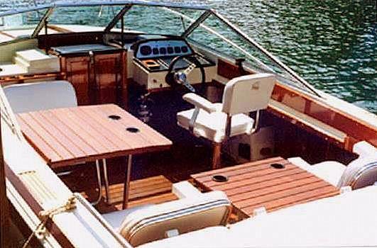

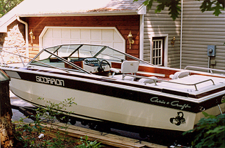

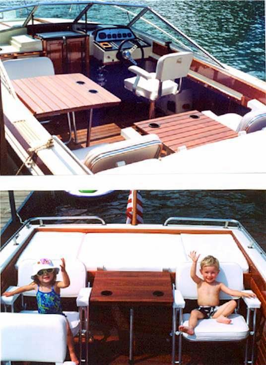

Here's another boat I fitted with a wooden floor: my old 1980 21' Chris Craft Scorpion. Sorry for the poor photo quality but it pre-dates digital cameras so the "snap shot" was scanned to my computer.
The decking is all mahogany, about 1/2" x 2-1/2" strips set on 1/4" mahogany strips running fore and aft to allow rainwater to run beneath to the transom drain. All was screwed right into the original fiber-glassed plywood floor with 1-1/2" stainless screws which were sunk into holes cut with a 3/8" Forstner bit and then plugged, sanded fair. In this particular case, I oiled the decking: 50/50 mix of boiled linseed oil and turpentine. I applied several coats...maybe 6 or 7...with 0000 steel wool. It looked great and when dry, had a deep low-lustre sheen.
The folding tables were made of Brazilian cherry, also oiled. They were supported with inverted chrome 1" flag holders which held removable 1" billet aluminum rods with white rubber "feet" on the ends. I even made a mahogany rack to hold the rods when the tables were down. As shown, the tables were great for snacks and afternoon libations.
All other gratuitous mahogany trim was varnished with eight coats of Captain's varnish, sanded between coats.
The Captain's chair was a Pompanette Ebay find. The rest were double framed aluminum deck chairs. When the tables were folded down, the chair next to the Captain's was placed between the other two in the rear...three across. Moveable deck chairs gave me all kinds of options: storage, large coolers...even a dance floor with the option of some serious terpsichore to Aretha Franklin's ballad, "Until You Come Back To Me." After docking, all three chairs could be lifted onto the dock for relaxing in the shade with friends...and imported beer/wine. I like options.
We once took this boat to a local boat show...new boats from dealers, free sodas, hot dogs, etc. We tied up with all the other visiting boaters. My boat drew a constant crowd and when the "powers to be" finally tracked down the owner, I WAS ASKED TO MOVE THE BOAT! Eventually, my next door neighbor begged me to sell the boat to him...in February, for my price, which wasn't cheap. I let him have it.

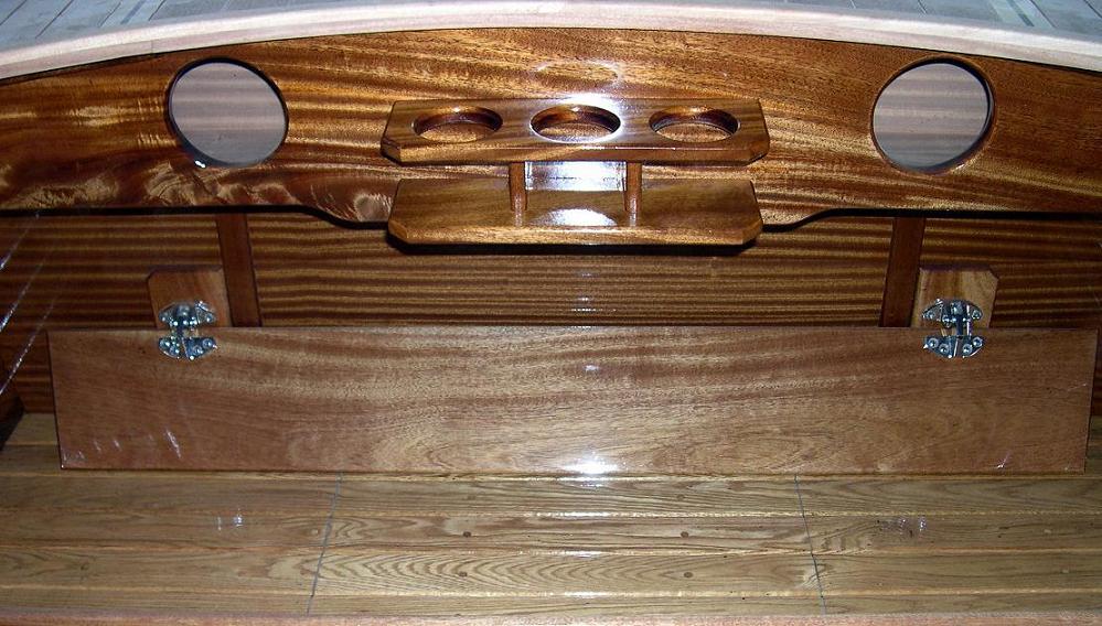

Same Boat...

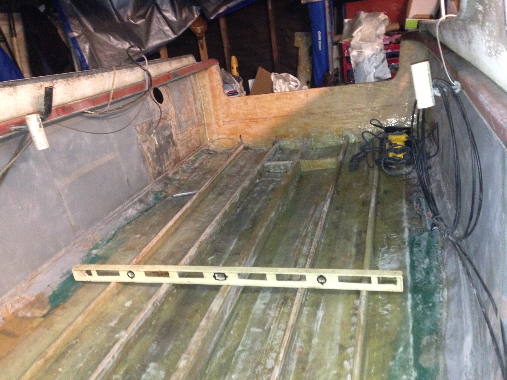

hello all I got my transom and stingers glassed in with epoxy wow that was allot of work.
Now i need to put a deck in the problem im having is new deck width is 4' 5" so how do i put seems togather?

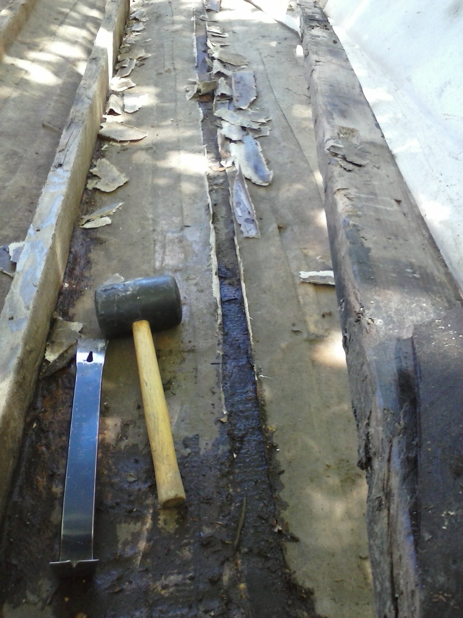

Here's How I do My Deck Seams!! 6" strip of 1/2" ext. Grade plywood glued and screwed to the underside of one piece and then use thickened resin between the edges and then CSM over the seam.

Wow a few years has gone by i looked back on these notes I've came along way!! Got my new transome, stringers, expanding foam, floor, bench seats, in and started priming, so much work but Im starting to see vary hard work pay off, I still have a long wY to go but getting closer each month. Just wanted to say thanks to everyone for helping me get this far. I will post some pics soon.
Bellboy.

Here's what was done to my 17' Shell Lake Sunliner. The upper deck was completely trashed, caved in, split, ripped but the hardware was excellent. Removed the entire top and gutted the interior. Rebuilt in '30's/40's style all hard Honduran mahogany. It can be done. Pictures were taken last year. Forget the shoes in storage, I like to go barefoot on the water :laugh:
