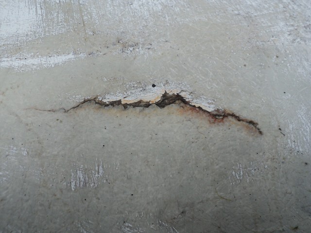

Both are pretty bad, they are cracked and there is a hole under the port stern(see pic)

Hey rip did your boat sit full of water? That hole looks like it was poked up through. Maybe had somw wheight in it. I fixed one similar. Someone threw something into the boat. I cut out the bad glass and put two layers over the hole. I filled the hole with Duraglass from the inside and I am going to put a few more layers of mat inside. The outside is done. The rear corner closest has the repair.

Robert,I am not sure if water sat in it I would assume thats correct, it was also on a roller trailer that was to big for the boat.

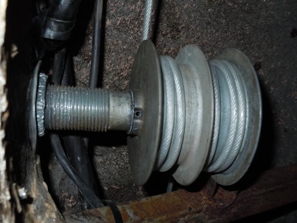

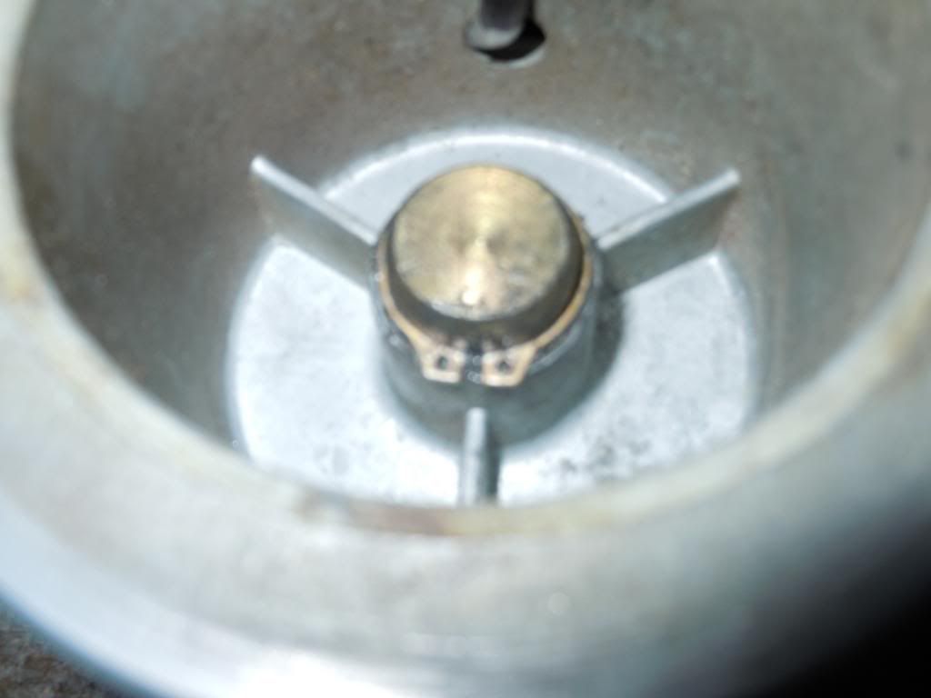

Although I am having the same problem that Normspeed is having. I cant get that damn steering wheel off@!!!
I beatit, pulled it, pushed it, torched it, soaked it in PB and still nothing!! I am about to take an angle grinder to the damn thing. Any more tips that normspeed might need too??

Hand the wrench over to the qualified person standing in the boat!
Did you try going after it from behind? Sometimes there is a nut on the backside of the spool that you can take off, remove the spool, unbolt the whole mount and then remove the assembly. Once the whole kit-n-ka-bootle is removed it is easier to beat the s--- out of the wheel, Just a thought.

hey Cal, Thats my next step. I was trying to not mess with the steering column but it looks like I am gonna have too.

Today, I built a platform that fit over one of the small trailers. and flipped the boat, Now I'm ready to sand it down.
However when I flipped it quite a bit of water started tricking out of some of the holes inside and outside the boat. The boat this feels pretty solid(transom also). I am just worried I am putting "lipstick on a Pig". What do you guys think?
see pictures(the hole in the hull is picture with standing water)

Can you post a pic of the cable drum under the dash? If it's like my aristocraft,you can remove the snap ring,pull the drum,drive out the dow pin and remove the steering wheel and steering shaft together and then set the wheel with the shaft going into a pipe and drive it out with a brass or copper punch. jim

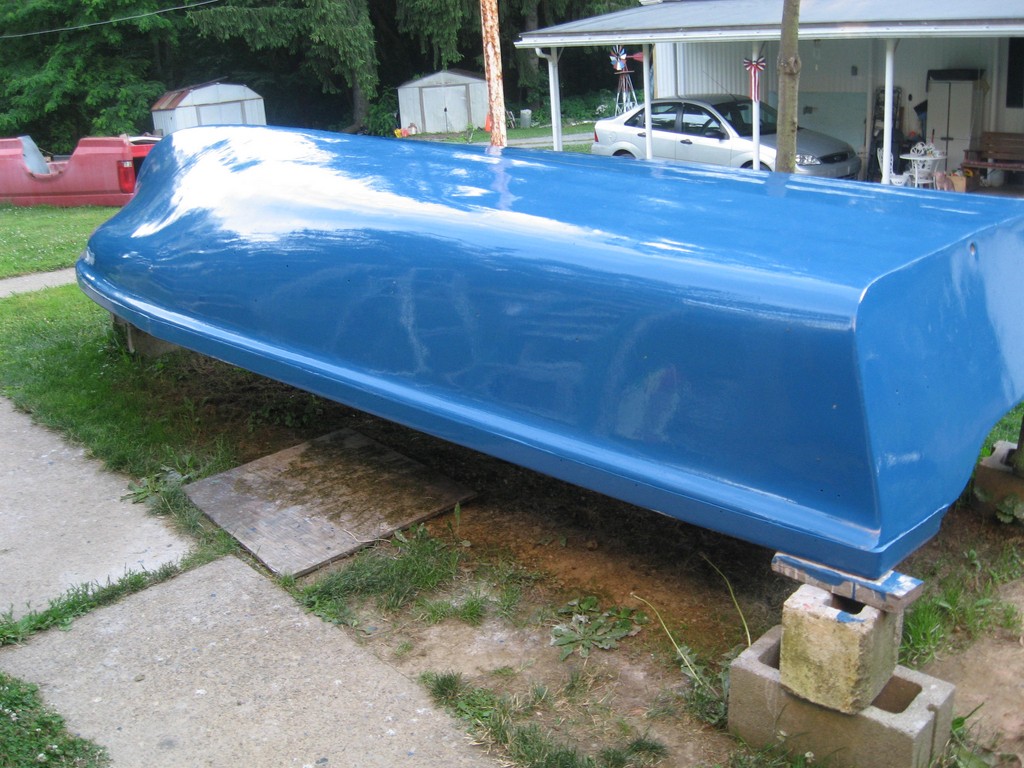

Updated to 11/24/13
Had the boat flipped over. I Put an epoxy barrier coat on the bottom and then several coats of paint. Flipped it back over and sanded, epoxy primer, sanded, painted, sanded, painted. only 1 or 2 more coats and I should be ready to start putting it back together.
I do however need to build bench seats. if anyone has any ideas or have done this before I would love to know if there are any tricks, do's or dont's???

Looks great. What brand red paint and bottom paint did you use. I want yo paint the topside on my boat red.
Re:Ark Traveler *NEW POST*old thread UPDATED 10/2/13 12 years 8 months ago #86790
  • rip fc3
  • rip fc3's Avatar Topic Author
  • Junior Boarder
  • Junior Boarder
  • Posts: 63
  • Karma: 3
After alot of reading around the old Interweb there are lots of possibilities. I looked at epoxy, gelcoat, paints. I emailed back and forth with a couple of reps from petit and interlux. I decided to use a product called Interprotect 2000e from Interlux to fill in the old gelcoat crazing. After alot of sanding I applied and lightly sanded 3- 4 coats for the hull and 1 good coat for the top.
Believe it or not I decided to go with the $11 a quart Rustoleum topside paint for the topcoat(3-4 coats). I looked around the web and here and found really good results with the topside paint for use even below the waterline, I will let everyone know if I have problems down the road.
the Top is also Rustoleum topside paint for 11 bucks at lowes. I am on my second coat by rolling. It will probably need 2-3 more coats. I had all my spraying equipment ready and I would have had to spray outside and it was a cold windy day so I decided to roll intstead and so far so good.
