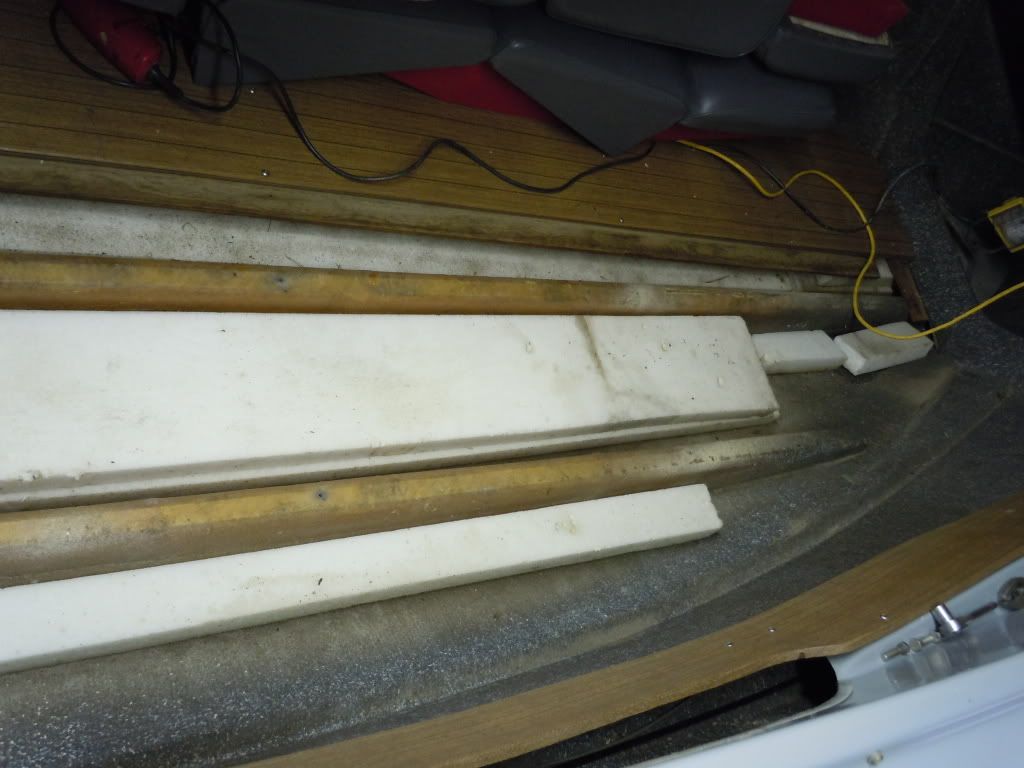

Ok,I'm done being silly. Here's what the factory put in my Crestliner. Some type of closed cell foam just laying under the floor.

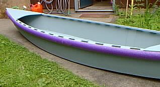

Re:Foam Floatation? 14 years 2 weeks ago #53766
Your way ahead of me Ron. I think the blue looks better than the black on your boat.
