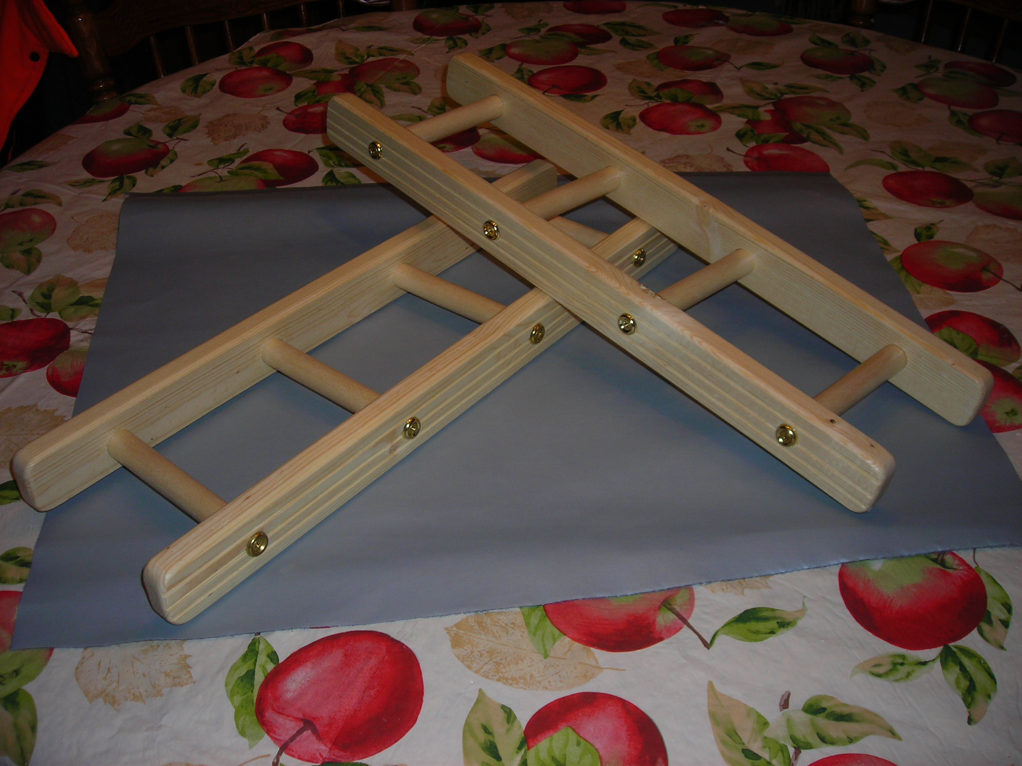

well the only thing i got done was winterizing the camper,and some more paint removal on the fire truck,im back to sick again,but i have to fix the spring house roof today,one of my nephews put a hole in it,i was hoping to hold off on that untill spring,im just going to have to cover it with a sheet of plywood then put a tarp on it and hope it lasts till spring,crap,tomorrow is my surgery,and i dont have everything done yet,oh well.
but the best news today is... i got the ladders frog made..wow frog,great job they are perfect,just fantastic,great job buddy!thank you,john

i agree on those ladders. really nice. talk to you tonite. ron
Re:pedal firetruck for charity 13 years 6 months ago #51504
Laders look AWESOME Frog!

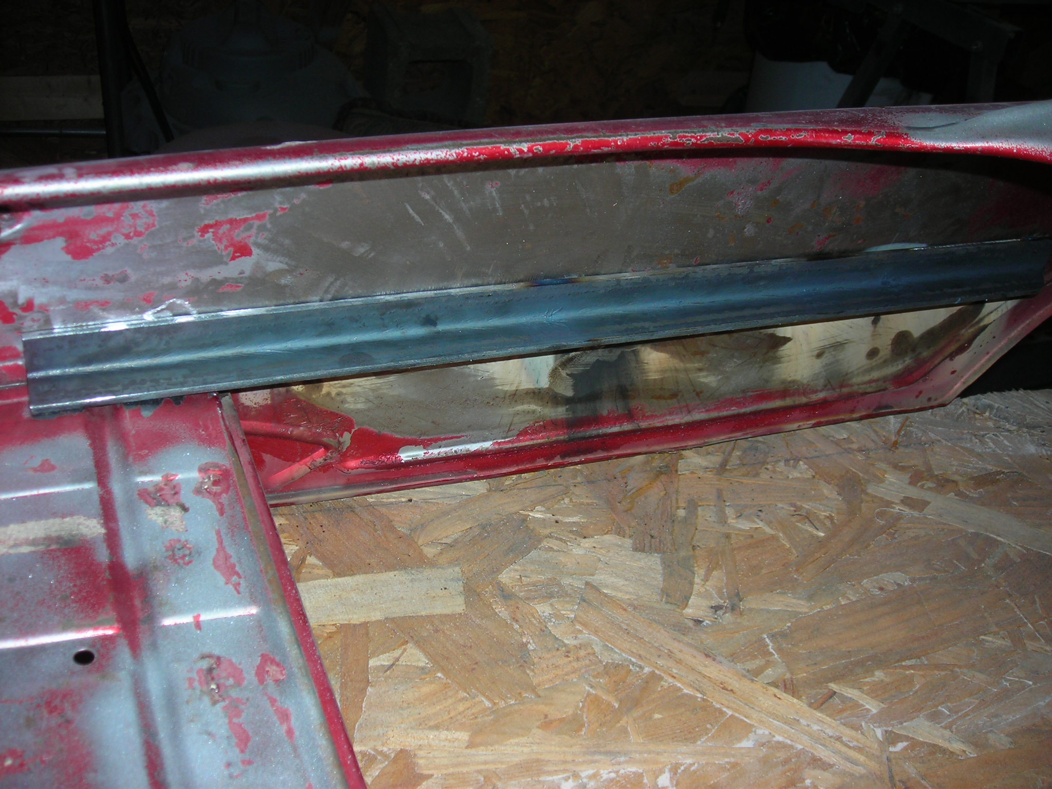

i welded the 3/4x 3/4 x1/8 angle on yesterday,i cut the angle at a 45,and the ground it so its not sharp,then welded it in place.
the sides of the truck were not as strong as i liked,and this will also keep the sides straight.
i will also weld the seat to it,as the only support for it is 3 small tack welds.
all of this will be sanded ,primered ,painted and then coverd with upholstery,thanks to todd,who is giving me 2 of his sewing machines that can sew vinyl,thank you todd you dont know how much i appreciate it.john

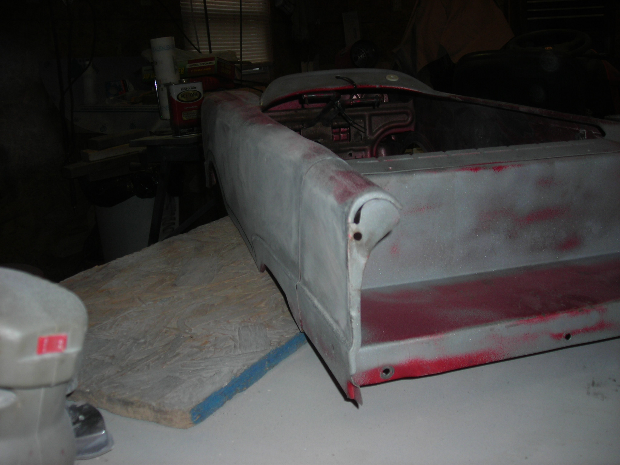

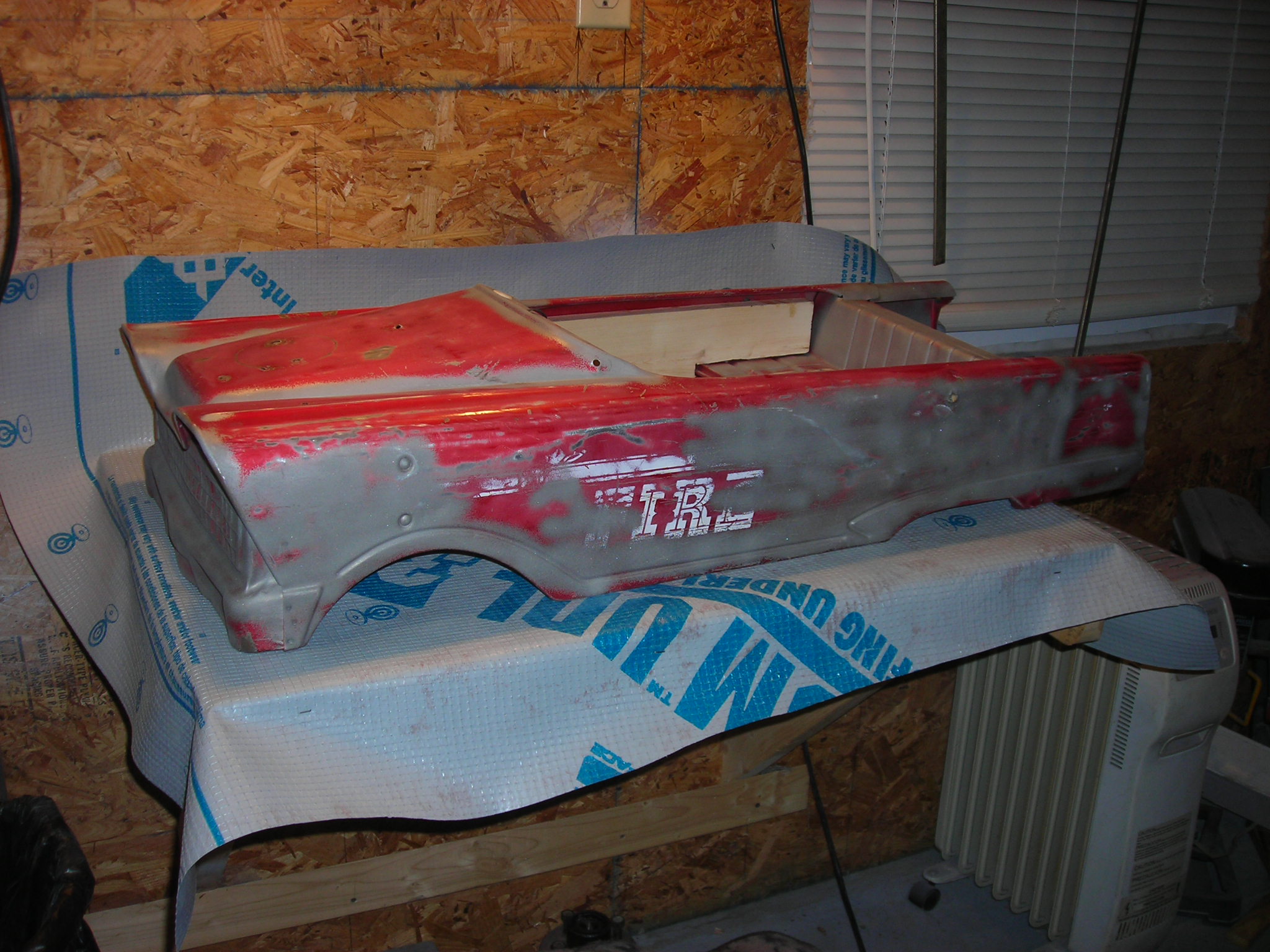

bob ,lol,i am getting better,i finally got a little bit done on the truck,it takes a good bit of standing.
i got some of the heavy sanding done on one side,next is just a little filler ,then fairing.
before
whats done so far alot more sanding to go,lol,john
