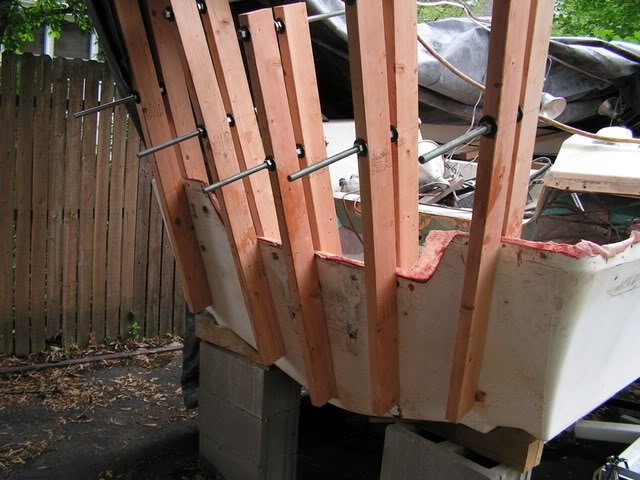

Well I started on the transom .The rear skin was thin and also some bone head ground threw parts on the corners . So I laid in new fillets on all the corners Then put a layer of 1708 biaxial across the whole back to make it stiffer and thicker .Pic is without the biaxial .
Then I coated my first piece of ply with epoxy to seal it and soak in well .I mixed up some US composites Epoxy thickened with Aerosil - cabosil to close to Peanut Butter thickness .I coated the skin and the back side of the ply generously . I clamped the ply at the top but couldnt find any clamps to get down low .So I drilled holes threw it and took 3 inch long 5 /16 bolts with big washers on the outside and 1 inch by 4 inch Oak Boards on the inside and drew it together .I then let it set 24 hours .If anybody is not sure if Epoxy is the best Ill tell ya what ..The next day I went to remove the bolts . Dang things were so adheared to the wood by the epoxy that they snapped while trying to get them out .Ive worked with Poly and I know for sure that it would never hold 2 totally different materials together like that .So imagine how good it is Wood on Wood ..I thought Oh Crap how do I get those out ?? I took my 4 inch grinder and started to grind off 1 of the bolts on the inside . After i had got a 1/4 of the way threw it I saw it spin .The heat must have lousened the epoxy .I clamped a vise grip on them and spun them out .
The next 2 days I did the same thing with the next 2 layers of ply .. I drilled threw the same holes each time and yes the bolts snapped the next day ..After the third sheat had cured . I put 2 layers of Fillets in Starting at 3 inch then 5 inch . I also Filleted the top side of the deck down to the transom and weighted it down .
When I removed all the clamps and bolts this puppy feels like its built like a tank .The original transom was bearly a inch thick . Its close to 1 3/4 now .
Im gonna do one more wider set of fillets then 2 layers of 1708 bi to cover the complete inside of the transom .She should be Bullet Proof I think .Ill fill in my Bolt holes with peanut butter epoxy . So far with epoxy ,hardner , Pumps , 1708 (( A little more expensive but great stuff to work with and builds fast )) Cabosil ,and a roller I got $205 into it including rebedding the spars .Ive got a quart and 1/2 left of epoxy but will reorder another gallon with hardner to finish the floor and glue my wood pieces on .Its $67 a gallon .Im thinking ill have a 1/2 gallon left over toward my Carlson this winters project ..This being my first build with epoxy instead of Poly .. Ild never use Poly again . You dont have to worry about fires , Epoxy barely Smells , And it sticks to everything where poly your hopeing it does .Lots easier on the skin to .Locally Poly is $45 a gallon .Epoxy at US is $67 ..My boats worth more than saving $22 ..The Ply is 1/2 inch acrua ply .About $25 a sheet at Menards or Home Depot .Lowes might have it to I heard .I tested the crap out of this wood before I used it .This would have been alot easier if the transom wasnt curved So dont let my extra work scare anybody off from doing thiers . If it had been flat I could have glued it together outside the boat and saved a ton of time . Ive never done one before so I might be doing it wroung . It was a pretty scary thing to undertake but once you dive in You can do her . Hope this helps some one and I aint boreing you ... Larry

Excellent Larry, she's looking good. One thing though, don't kid yourself about no fires with the Epoxy. It gets very hot once it starts to cure. I mxed up some of the West stuff with filler and didn't get the filler mixed in quick enough before it started curing, the darn thing started to smoke! :ohmy: Mixed it in a small old butter container. Could have been the way I mixed it but it does get hot.
Again looks great and be careful.

bobo your doing a great job,its coming out nicely.
nows a bad time to tell you but i think it was "my famingo" that had some great home made clamps for deep clamping,ill see if i can find them,or else maybe he will chime in.johnp.s the way you did it with bolts is also good,it should be a great bond.
Re:Operation Delmar Stage 2 Begins .. 15 years 3 months ago #35881
i found them bobo,i think i will make a set,great idea for huge wood clamps flamingo.
and great thread bobo,your helping out alot of folks on rebuilding their transoms,john

Thanks Bob ..Ya it can get hot but mine never got that hot ..I see you used a small container thats good .In bigger batchs it reacts faster and causes heat .Maybe some epoxys react different and Im sure air temp has alot to do with it . I used US Composites 635 thin with the medium Hardner . $65 for 1.42 gallons hardner included .They sell West Systems there to Its $81 a gallon Pluss $32 for the Hardner . Part of what I meant by fire is Polys fumes are suppose to be flamable . Epoxy arent and smell a heck of alot less .
Thanks to you to John ..Ya know I saw those Flamingo Clamps on here . Real Neat Idea . I was gonna build some but then I had 3 days off in a row and I was bound and determined to get wood into the back of her .I was concerned about the curve to .With the bolts I could watch it being drawn together in a isolated area .When you hit bottom ya know it ..I didnt exspect the epoxy to stick that well to the bolts thow .I went threw 18 of them ...L.O.L..

Nice sunny day in the 70s today and I had it off .Delmar Time !!! A few people emailed me and asked if I could give some details about what Im doing and how I did it .So Ill try .It is Not my intention to be a smart Arse like Im the God of Body work there are many on here I stand in Awe of .Nor is my way the only way to do things .And if I dont explain right Feel free to jump in and correct me or if you have a easier way maybe I can learn to .First I intend to paint my boat .I have never Gel coated one so my methods might not be right for those who will .Im just applying Skills I learned in a Body Shop for around 20 years to a boat .
Well any holes I had from my bolts in the transom that I wouldnt use again I faired (( Ground them out so the hole wouldnt be a straight 90 degree angle )) and made a Divit in the surface with a 4 1/2 inch Grinder with a 80 grit disc .Ild grind back a inch or 2 from the edge of the hole .Then I mixed Epoxy Resin with Cabosil thickner to peanut butter thickness and filled the whole .Once it sets I smouthed it out a little with the grinder so the epoxy would be below the finished surface .Then i took some fiberglass reinforced body filler (( Not the long hair )) and put a thin coat over the holes .
I then took my DA (( Orbital sander )) with 80 grit and sanded it smouth but below where the finished surface would be .I had some smaller holes where stuff was mounted and Im not gonna reuse those holes .So i ground those back and faired the edges .These holes were a 1/2 inch or less .Anything much bigger youll want to make a fiberglass patch for .I put Duct tape on the back sides of those I could reach and filled again with Filler with the fiberglass short hairs .Once again after It was set I DA it with 80 keeping the Fiberglass putty below the finished surface .Just a side note here . Before applying putty Blow all of the dust off of it and wipe down with denatured Alcohol .DONT use acetone or Lacquer thinner or any thinner really . It can leave residue that will affect the adhesion of the filler .Later down the road your putty could Pop louse . I then prep a bunch of areas to fill and mix up some light weight body filler .My choice is Evercoat Light Weight .For those of you that still use Bondo from Wall Mart or Auto Zone type places do yourself a favor and try some .It sands 10 times quicker , Doesnt clog your paper (( Saves Money There )) and wont get pin holes .Its also about the same price sometimes or cheaper but if you figure in the cost of your time and extra sand paper Its Alot Cheaper ..Evercoat isnt the only company to make it but for the price I love it .Easy on the hardner here when you mix it .If it gets hot and sets to fast any filler wont have its full strenght or adhesion and youll end up waisteing some .Apply skim coats around a 1/4 inch .
Give it ample time to harden then get your Blocks out ..
Theres many types For flat areas ones like the above work well .For curves get a Flexable type . Grab your DA and sand any crap that might have got where you didnt need it but not on your patch area .Then start to sand your repaired surface changeing directions fairly often .Work the edges so it feather edges in then back to your main area Stop and feel your work often with your hand like this and moving at different angles .Try to determen low and high spots ..Yes Im part Irish . Can you tell by the freckles ?? ...L.O.L..Irish , German and Native American ..Theres a combination ..Dont get Lazy here and think you can grab your orbital and sand it perfect .Aint gonna happen for you .Blocking is the only way to go .If you get tired go have some coffee or a beer and chill then hit it again when your ready . Otherwise youll get paint on her and see your bad spots and wish yould have spent another 1/2 hour there .
Work a little on the high then back to the whole area Keep feeling . I do this with 80 grit .If you see low spots like this but rest of it feels good stop it will need another skim coat of filler . Sometimes youll need maybe 3 coats to pull the panel where you need it to be .At times you might have a bunch of smaller spots fairly close together .When you get that after a coat or 2 Skim coat the complete panel and work it as one . Take your time , Feel , Think , Be patient It will pull together for you .
Dont try to make it perfect with 80 grit . When you get close change to 180 and when closer 320 .You want to get the 80 sanding scratchs out by stepping down in grit .
Those long Side Panels in back were full of crazeing so I DA them down with 80 then skim coated the complete panel .
These had wood on them originally but Im not sure if Im gonna go that direction .If I dont I want them prepped for paint .
I get my sand paper and DA paper from TCP Global .Its there Gold paper and I think its made by Norton .Decent paper at some pretty cheap prices .Probaully less than 1/2 of a Local Jobber .Car Quest carrys the Ever Coat pretty cheaply .Global has it to but shipping might get ya but not sure .Filler isnt real light .3M has some outstanding paper but at over twice the price of Norton I cant see it being worth it unless your doing production work in a Pro Shop .But thats just my oppion .
Anyway Still plucking along .Hope to paint maybe next week if life doesnt get in the way . Hope I helped somebody and Didnt bore the rest of you ..
