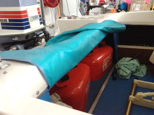

I would consider putting a tank in front for balance reasons. Your setup might tolerate rearward weight bias better than my rig though. I think my motor is a bit big in back, so moving the fuel cell up front really helped with ride and speed in my glasspars case. Was using rear mounted gas tank as well,, no more.

Boat was designed for tanks in rear, and front is open-bow seating arrangement, so no moving the tank forward. I currently go out with three tanks (2 under the splash well plus on in front of them so we can stay for a day or two with no worries), and she planes with no problem and runs very flat (can hit 35 mph).

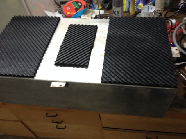

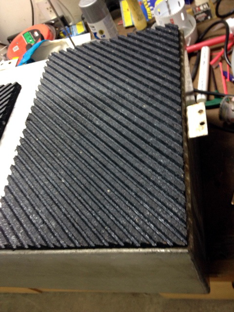

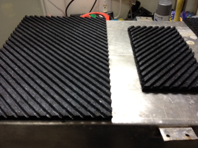

To get the tank up off the floor, at Lowes I found great recycled tire rubber 1/2" thick, slotted stair treads that I cut to size and attached to tank bottom with JB Weld. No chance of any splashed water sitting under the tank, so no worry of corrosion under the tank (plus no stopping wet bathing suits etc water getting to the bilge. Once in place, I will add some foam above to sandwich it in place (to replace the foam under the splash-well that I removed to make room for the new tank, as well). I just need piece of 5/8 marine gas hose and I am ready to do the install.
Re:Installing permanent tank in 73 Crestliner Muskie 10 years 8 months ago #115340
Here is pic of the rubber step tread header from Lowes:

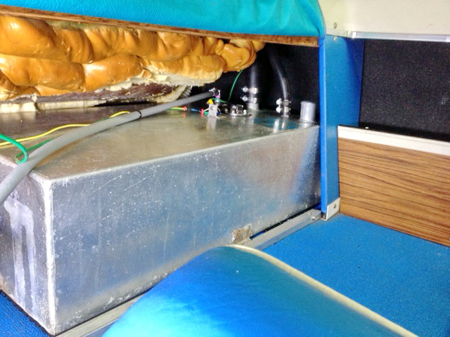

This should work great - channeled to run water away. Here are some pics of the install on tank bottom:

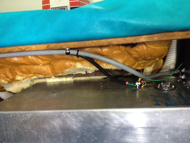

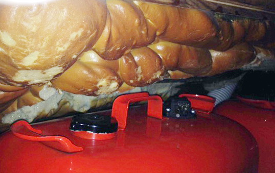

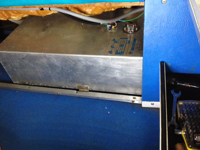

More pics - here is tank area under splash well. Notice I had to remove a bunch of flotation foam. The original Evinrude OMC tanks are still sitting there (not removing until the install day).
The original snap-down flap will hide everything nicely.
I will screw the tank down by the aluminum mounting tabs, using stainless screws (sealed with silicone). With it screwed in place, plus a bit of foam on top to snug it in (I will only use enough to hold it in place, but keep it away from the sender, hoses, and wires for easy maintenance).

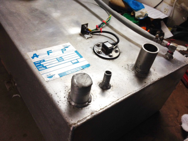

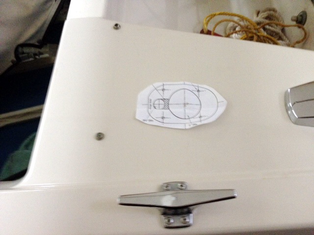

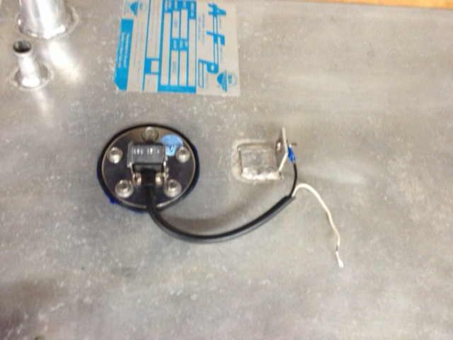

Here are a few more pics for now:

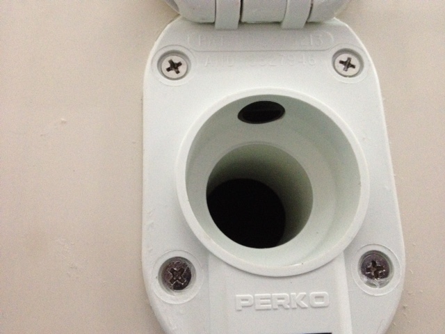

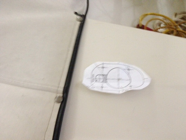

Here is where the filler/vent combo will be installed.

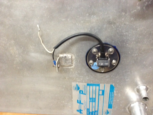

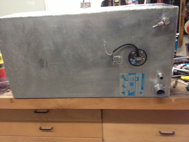

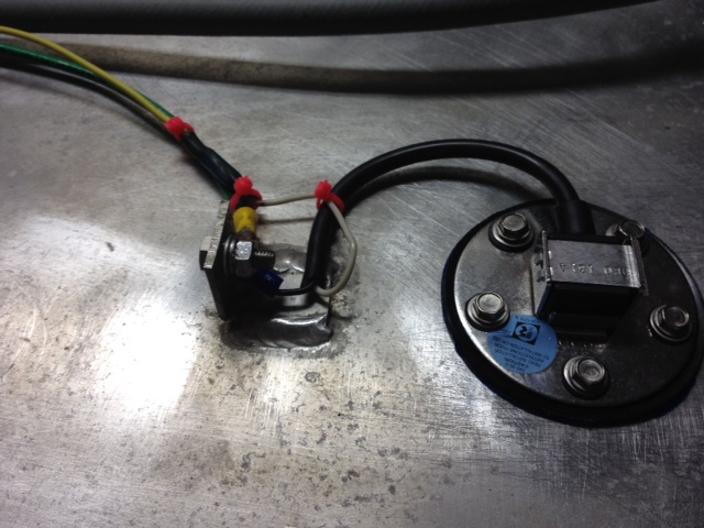

Here is another pic of the sender. This sender could not be any easier to install. White wire to the gauge sensor post, black wire to the boats ground. As I said earlier, a green 10 gauge ground wire will run from the tank ground to the ground bus bar.

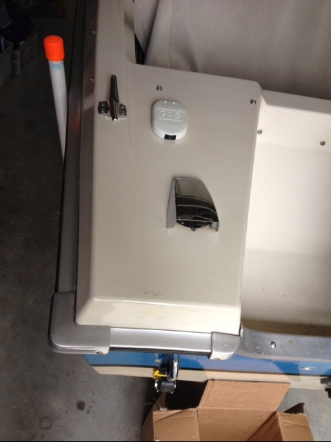

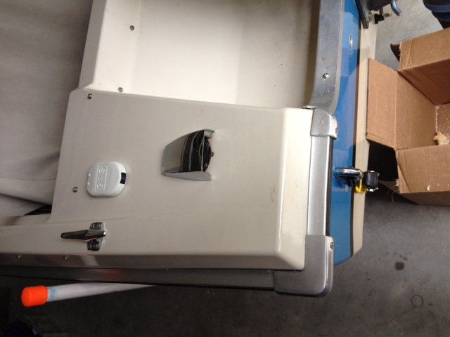

Installed filler on boat this evening, without much trouble (biggest issue was removing foam from the area beneath and cleaning up the subsequent mess).
Found that the filler hose would not allow for the necessary bend needed to hook it up (the hose could not do it without kinking... So, back to the welder we went. I m having the filler tube fitting on the tank moved to an area directly under the filler assembly installed on the boat (and welding shut the hole created by removing it from its current location. I will pick it back up on Monday afternoon, so no working on it this weekend.... :S
So close, and always another problem. Thank goodness I got the tank for only $50.00 on Craigslist, so another $35.00 for Aluminum welding is not that big a deal. Had I paid $300.00 for the tank it would be a different story.
Re:Installing permanent tank in 73 Crestliner Muskie 10 years 8 months ago #115409

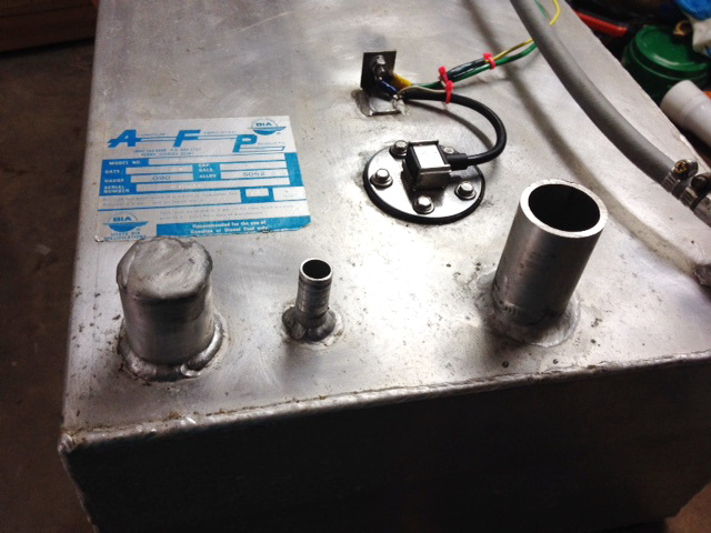

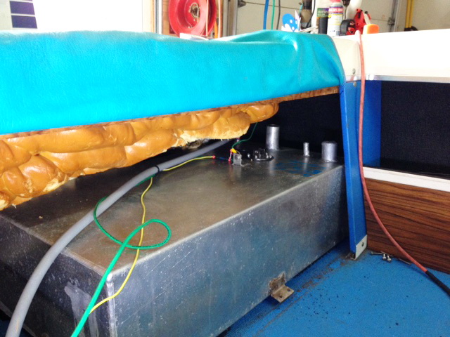

pics of the progress

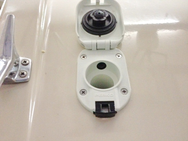

Here is the placement of the new filler. Although a stainless or chrome cover would probably be more appropriate, I had budget and location to worry about. By doing a combo filler and vent, it saves space and reduces the chance of spills.

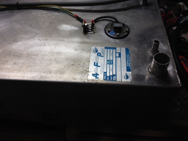

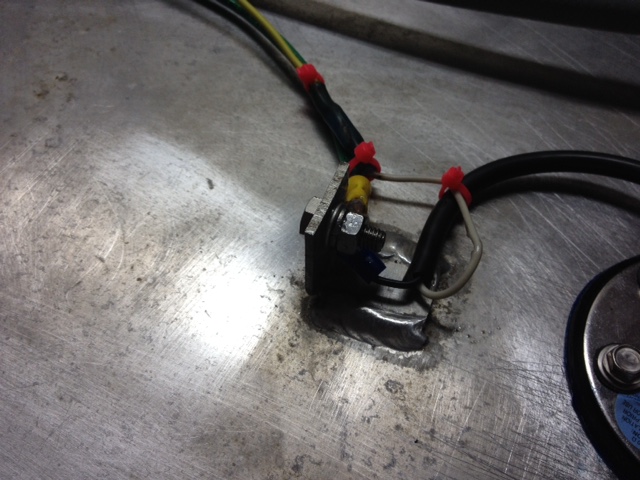

Here is pic of tank with ground wires and sender wire attached. The bolt, washer, and nut are 316 stainless, to prevent corrosion. All exposed parts coated with dielectric grease.
Note: since the cleat is relatively close to the filler, I have run a ground wire from underneath the cleat that will attach to the ground on the tank, so no worry about static spark (just to be extra safe). To do this I removed the cleat, put a wire fitting to one of the screws, and drilled a hole under the cleat to run the wire down to the tank area, Once the cleat was replaced, cannot tell it was done.

Here is pics of wiring, tank label, etc.
Sorry if over-doing the pics...

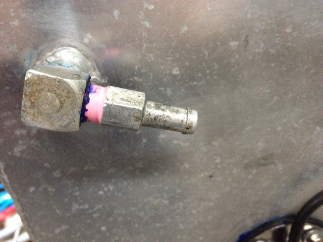

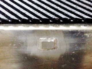

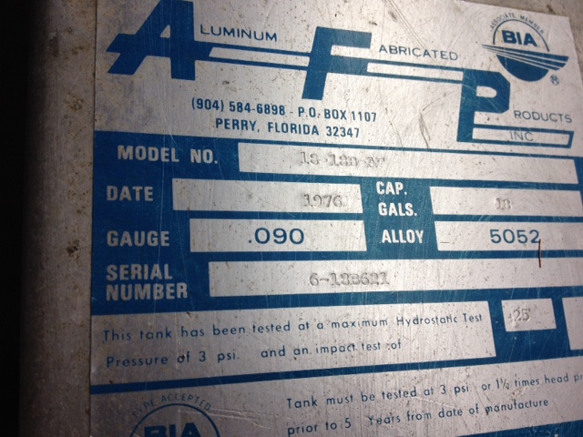

Well, as things would have it, I got my tank back from the welder....
pressure tested it and found 2 pin leaks.
One pinhole leak is in the weld to close off the old filler neck. My daughter saw it and said "it's gonna leak here" before we even tested it. I really thought she was wrong until it bubbled up at 3 psi with soapy water....
The other leak is on the new filler neck - in a spot that was not welded - hard to believe a new "bad" piece of aluminum pipe.... I watched them remove the plastic wrap from new pipe.
So, off to the welder again in the morning - Darn it anyways!!!!
Wish me luck. :unsure:
Re:Installing permanent tank in 73 Crestliner Muskie 10 years 8 months ago #115534

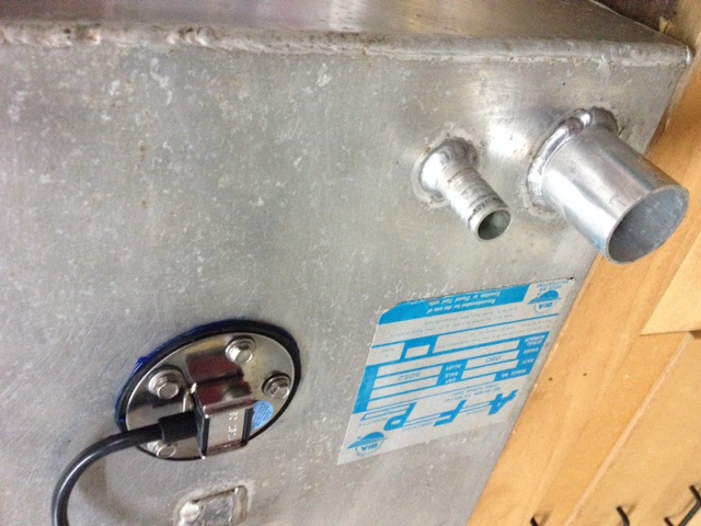

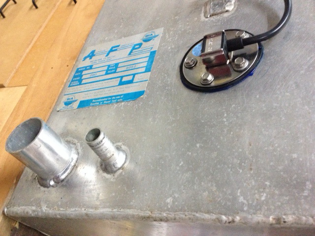

Got the tank back from the re-welding - pressure tests good now (no leaks at 4 PSI). Yippeeeeeeee!
Here are some photos of it now:
They decided to cap off the original filler, rather than cut it off and plate over it (said they were worried about too many filings getting into the tank). The cap is 1/4" aluminum, so should be strong as an ox.
Here is it in its space - ready to connect up.

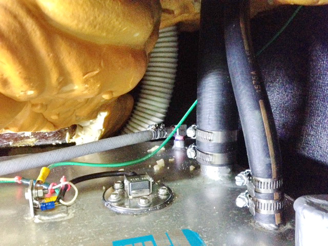

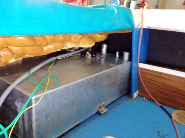

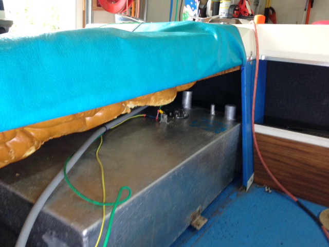

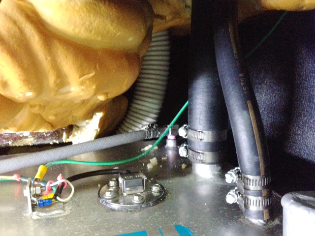

Here are more pics of the install. Ground wire from the cleat now connected to tank ground tab - other end of tank ground 10 gauge wire to soon be connected to the ground bus bar.
And here the filler and vent hoses are installed. Double clamped on each with 1/4" gap between the clamps, as required.
Closer look:
Re:Installing permanent tank in 73 Crestliner Muskie 10 years 8 months ago #115539

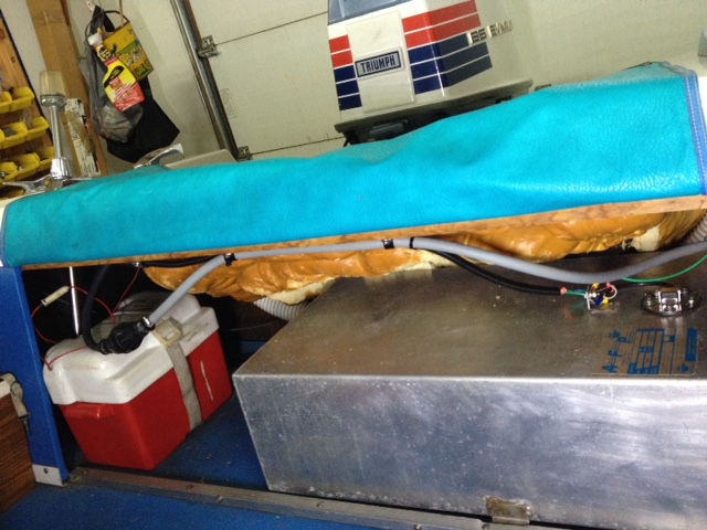

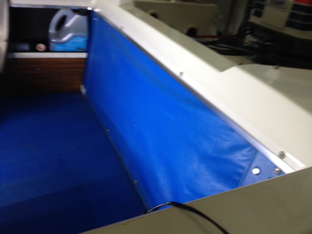

Tank has been screwed to the deck with stainless screws, so it cannot move a bit. Every screw was sealed with silicone, so no water can penetrate the floor. I had to notch the floor level snap rail to crear the tank mounting screws - can't tell from the face, so looks like it was meant to be. When I had the aluminum snap rail off, I found they never put sealant around the screws that go into the deck. I added silicone sealant to them before re-installing, so better than ever.
I still plan to replace a bit of foam, which will sandwich it down even more (top side only).
Here is filler permanently installed - it has silicone under all screws and edges, so spills cannot leak into boat or bilge.
Rear snap down cover clears the tank perfectly.

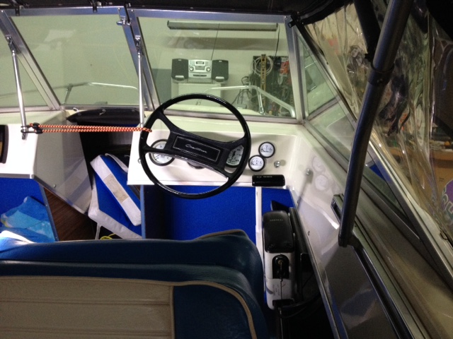

Thanks Bob. I will get the dash work done this weekend. Hole for gauge is drilled and neg bus bar removed for relocation and wire organization. Almost there.

Well, the project is completed. Fuel tank fully installed, gauge installed, all wiring completed, and gas in the tank. It feels good to finish a task - but what will I do next? Will have to find something else to obsess over. It should warm up this weekend (we have been cool/cold and rainy for the last 10 days in the Carolinas. Nice to see the rain finally stop. I am in the Charlotte area (25 miles east)and so did not get hit as bad as they did in SC. 24" of rain fell on Columbia SC.

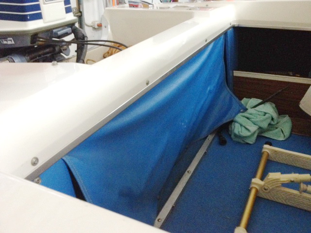

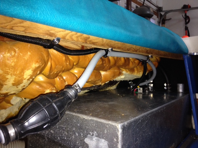

Kudos on a safe and neat installation, I can,t see where the fuel line runs after it leaves the tank but make sure it is not allowed too rub on the edge of the tank.
Re:Installing permanent tank in 73 Crestliner Muskie 10 years 8 months ago #115819
Fuel line is held up in place behind where the rear cover flap hangs, going over to the squeeze bulb and then out to the motor. The photos were taken before that was done. I also still have to spray a bit of foam above the tank to replace the flotation foam that I removed.
Re:Installing permanent tank in 73 Crestliner Muskie 10 years 8 months ago #115831
Here are the final photos -
Here is how the fuel line is supported across back of boat - out of the way and safe and secure. More than enough slack for turning to steer.
Here is view of it going across

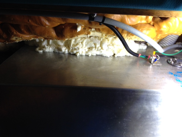

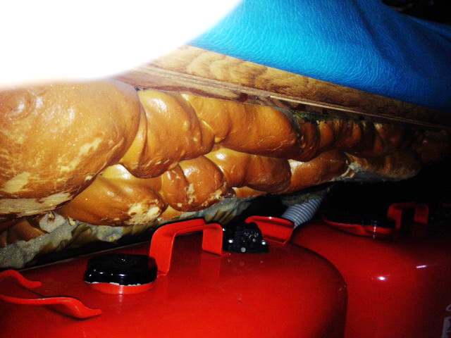

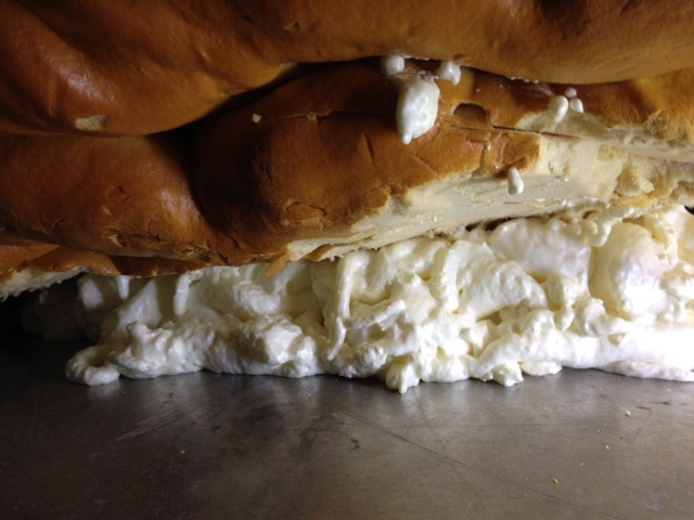

foam has been sprayed (still to expand a bit more and harden in place.
Re:Installing permanent tank in 73 Crestliner Muskie 10 years 8 months ago #115832
Here are photos with the foam sprayed and expanding:
And here is a closer shot - new foam is a lot brighter than 43 year old foam.

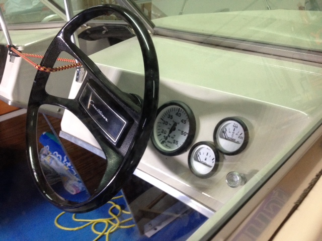

Here are pics of the gauge installation. I would have preferred a different spacing, but I had to work with existin holes and hidden structure.
view from the side:

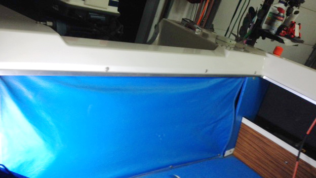

View of trim back in place, notched to allow for the tank mounting bracket that is siliconed and screwed into the deck.

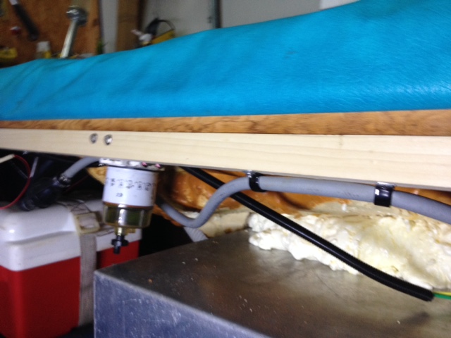

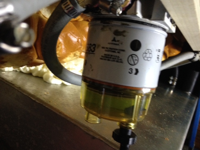

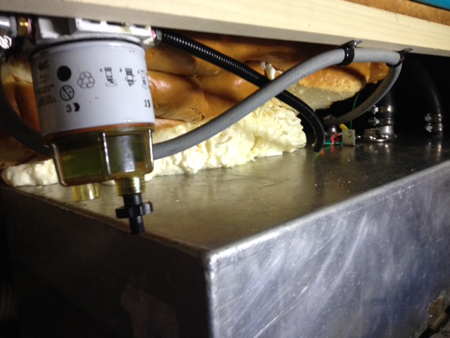

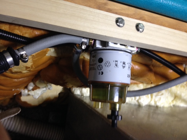

Found a 10 micron water-separator/fuel filter on Craigslist (NEW cartridge still in plastic wrapper) for $20.00 - couldn't pass that deal up.
I just installed it - was not too difficult. Tested and all good.
Re:Installing permanent tank in 73 Crestliner Muskie 10 years 7 months ago #116330
I ran the fuel line so it does not rub on anything. The squeeze bulb is in an easy to get to location, as is the drain on the filter.
Here is what it looks like done ... all hidden from view.
Thanks again, all.

That Racor is a good unit, you shouldn't have to worry about dirty fuel or water problems anymore!

Good move. A problem I've found with the fuel/water separators (and I use them all the time) is that if they are mounted above the fuel source there is a tendency for the system to get air bound. When you pump your bulb the initial time it takes forever. If you have even the slightest leak, even when you disconnect from your motor air gets in the line. Elimination of the problem is to mount the filter on the same level as the tank or even below. Just sayin'. If you have a situation, simply change the mounting position of the filter.
Good luck.
Cal
Re:Installing permanent tank in 73 Crestliner Muskie 10 years 7 months ago #116357
Wow nice price!!!!
Re:Installing permanent tank in 73 Crestliner Muskie 10 years 7 months ago #116369
I filled the filter 3/4 full of gas before I spun it onto the top, so very quick to prime it up. I chose to mount it up to be out of the way as well as easy to see water/drain it.
