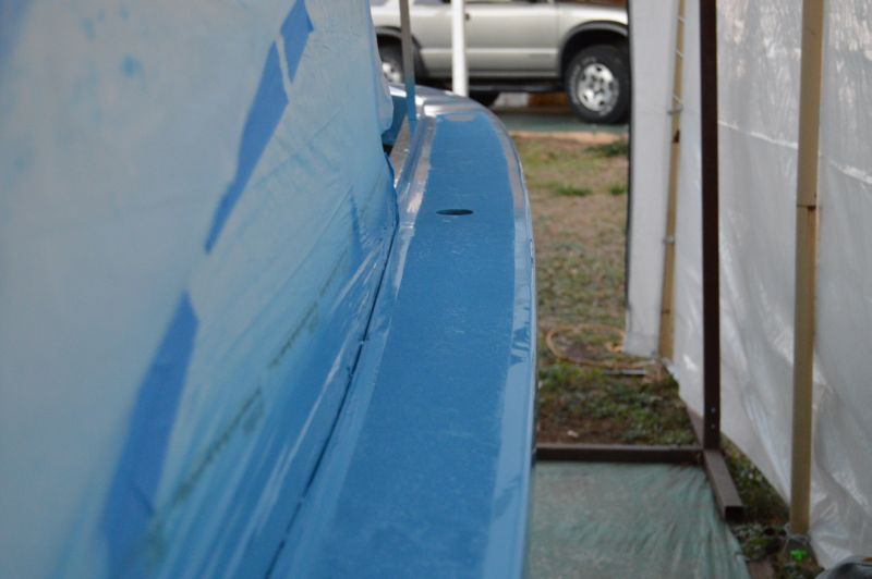

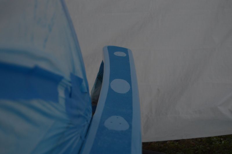

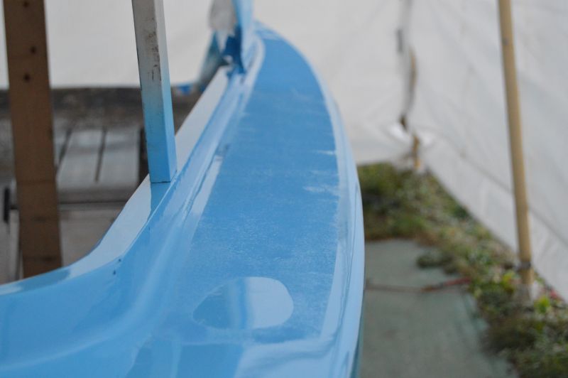

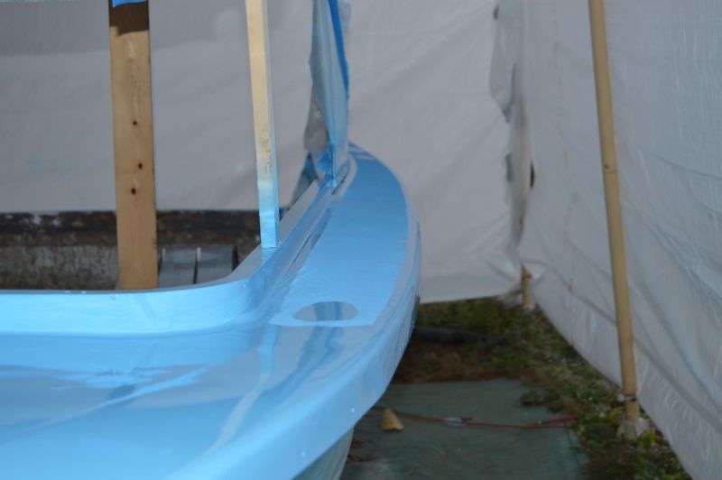

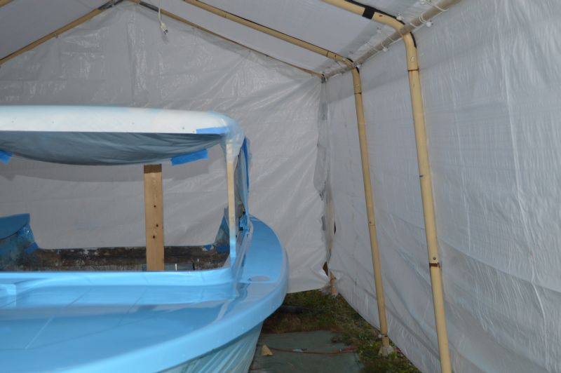

ok update on my work here are a few pictures of the nonskid around the cabin. i wanted it in the same color as the paint but tuff coat couldn't be sure the paint would stick so i went with the intergrip additive for the brightsides paint. roll a coat on ,broadcast the micro spheres dry, then vacuum off and spray a final coat. worked great... i got my mistake fixed today and now waiting on a few days of warmer weather to paint it one more time. you can see in the pictures the outline of the nonskid around the deck. the voids are for my hardware i have about a 1/4" margin around the part. i think it will work fine after the final coat. i am hoping this will make the calender for next year. im working hard and shooting for this summer for her maiden voyage ......

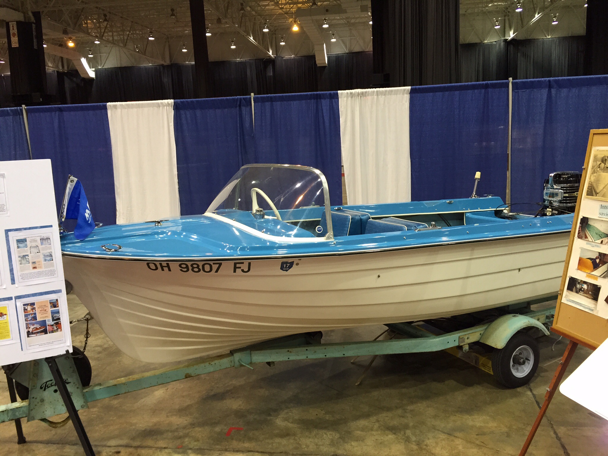

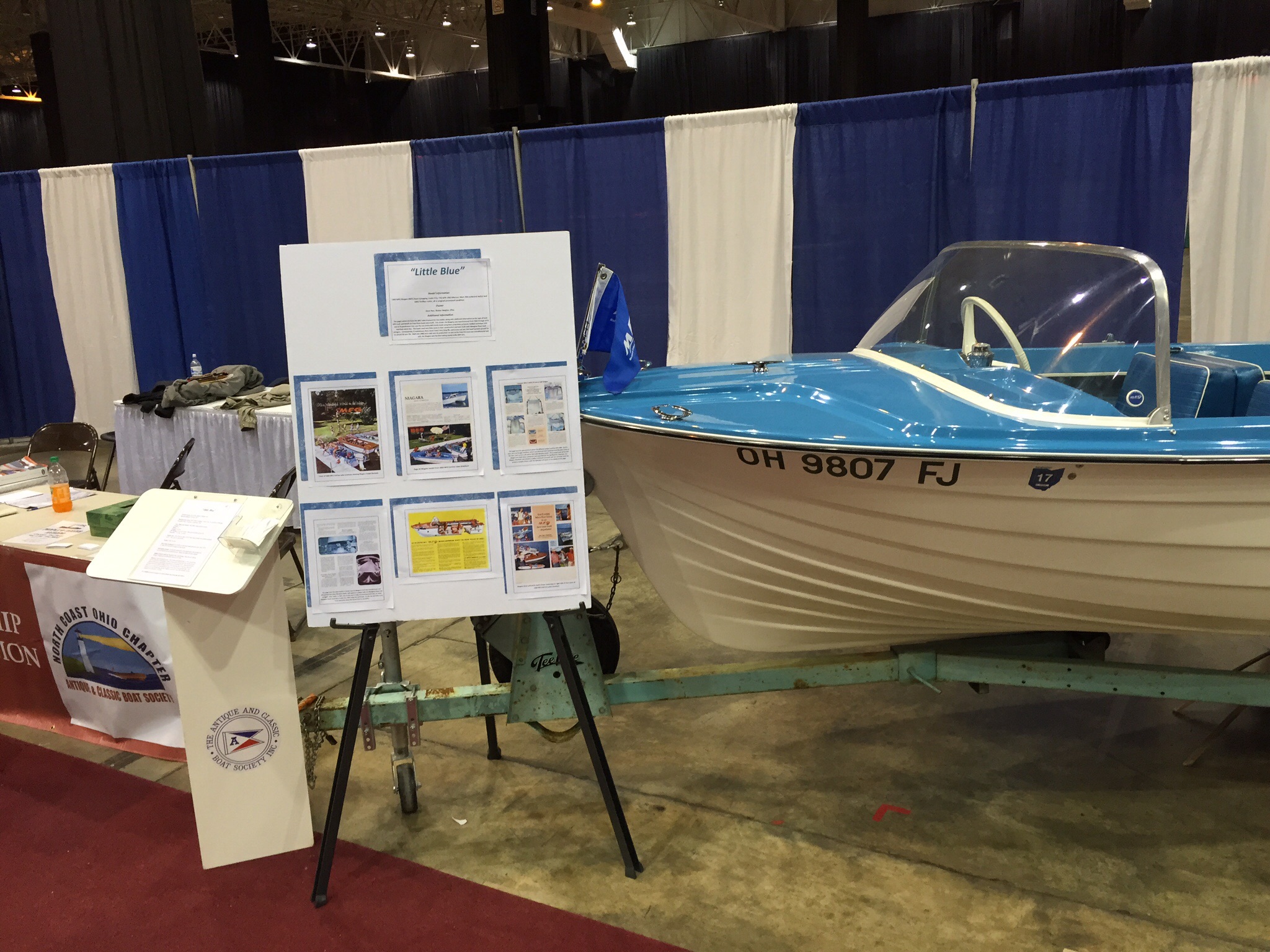

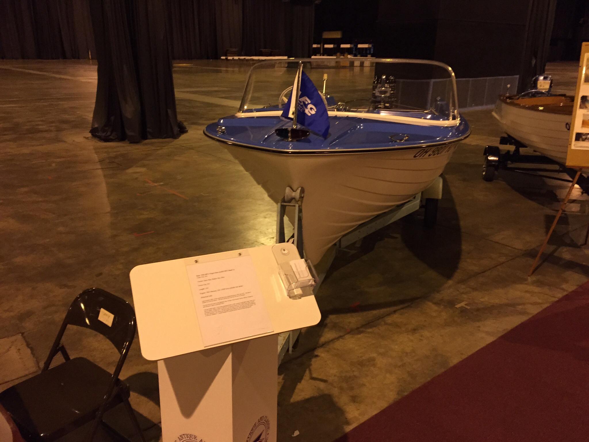

I'm showing my MFG at the ACBS booth at the Mid-America Boat Show at the IX-Center in Cleveland through today.
Showing it gives the opportunity to at least talk with others about boats until spring comes.

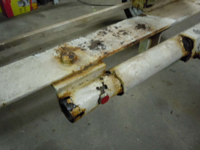

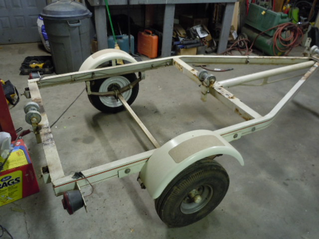

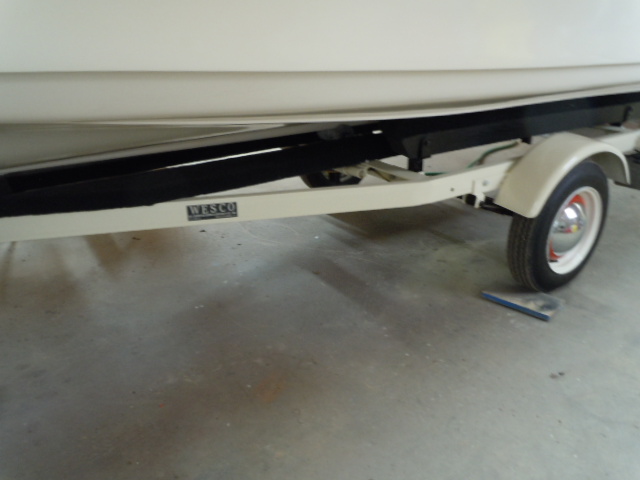

I'm in the process of getting my old trailer ready for salt water duty this summer. I decided not to put the new trailer in the salt. Worked too hard on it to mess it up LOL.Had to do a little repair on it from previous salt damage.

I have to get motivated and do one of my trailers
