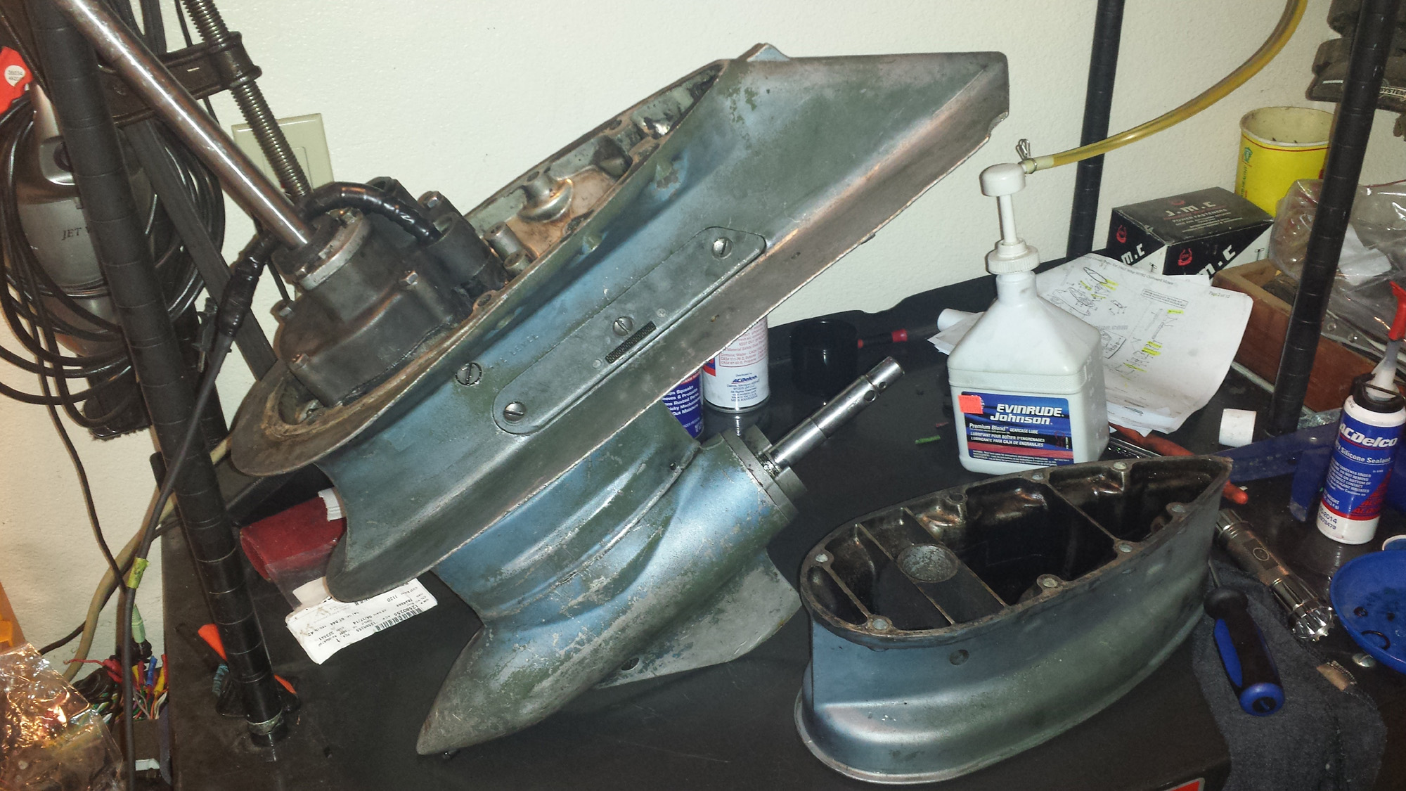

When that one comes in I'm gona do a full rebuild with new seals. For now I realy want to get this thing in the water so I reused the old seals, they still hold tight to the shafts, I replaced gaskets with rtv silicone for now. Filled with fluid and pressurized with about 30 lbs of air and didn't see any leaks. Ready to install tomorrow. I'll tell you what, these things sure are a lot easier to take apart than put together, took me a few tries to get the wires right, had to take them apart after I forgot to put the seal on that seals the gear case to the housing. lol. Also tested the the coils after putting the fluid in, I have forward and reverse, wooohooo.

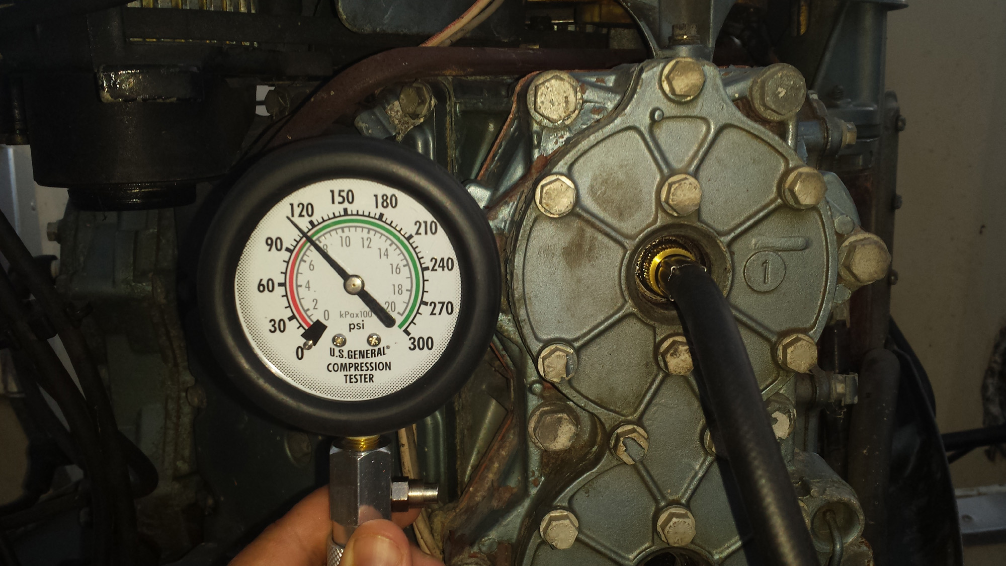

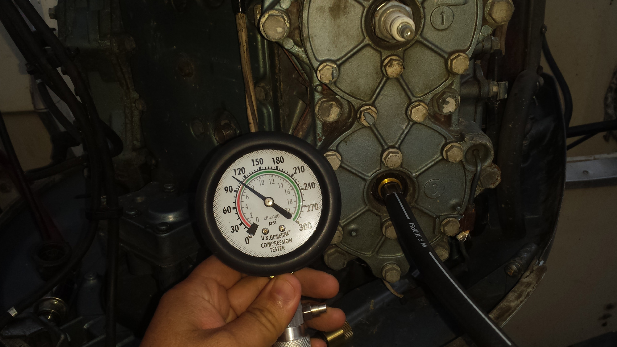

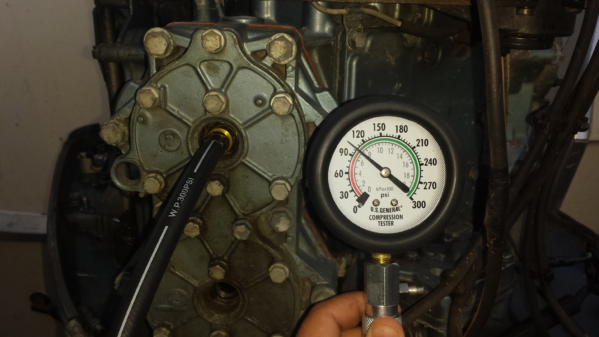

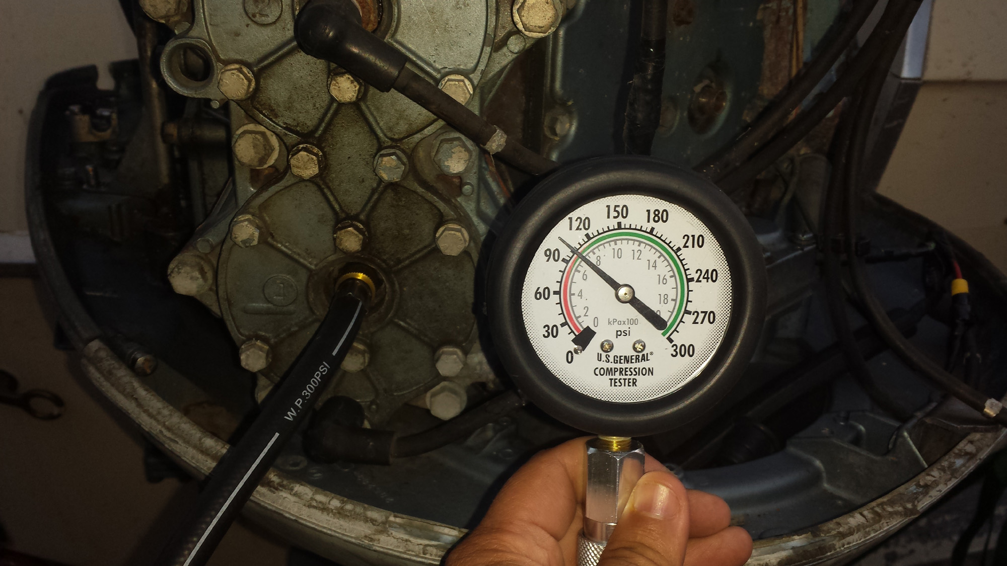

I just like adding pictures, hahahaha. Whats a good compression for these engines? Mine are all around 100psi.
Re:1965? Evinrude Starflite 90-s shift issue 12 years 4 months ago #97619
More pics = Good! We like more pics. LOL
IMHO your compression readings are decent, and more importantly all within 10% of each other. I'd consider that a good motor, but do run a can of Sea Foam through her as we discussed. Carbon build up around the rings can cause them to stick, your readings might even come up a little from there.

For those engines, your readings are very good.Was that a dry reading or did you squirt a little oil in the cylinders? I enjoy seeing the pics.
It hadn't been started in a week but I'm not sure if you could call it dry, lol, when removing the plugs it was very oily inside, I'm running 20:1 right now while I'm doing this for added protection while doing all the testing. The old plugs seemed in good shape too, but I replaced them anyway, it now idles better and at a lower rpm. I even got the rpm gauge to work with this motor that was original to this boat, 1980 bayliner, originaly had a Johnson/evinrude 6cyl. Loved that the gauge had a switch on the back so you can use it for 2, 4 or 6cyl. lol
