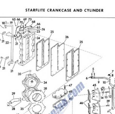

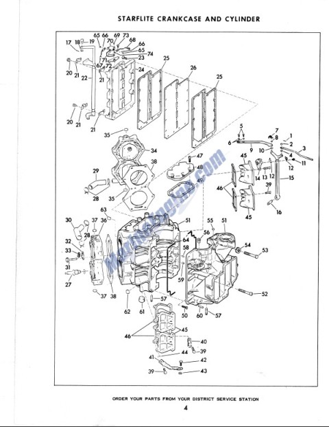

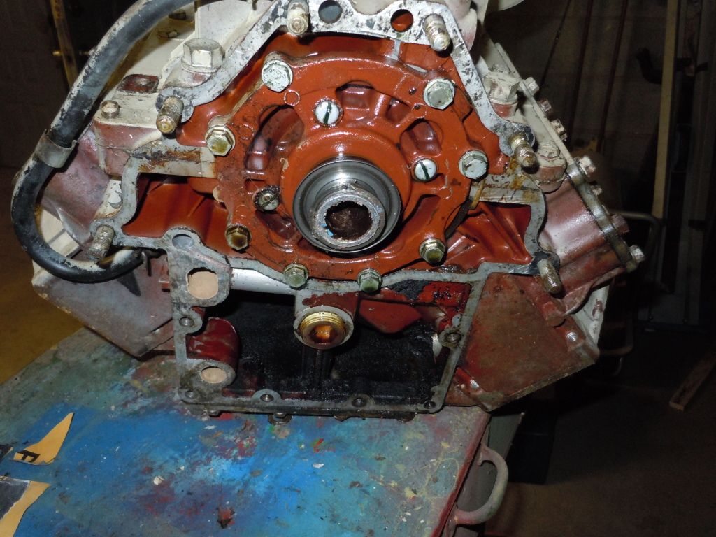

When i found it wasn't pumping i was at the boat launch. I have a 55 gallon drum that i cut the top 1/3 off. when it's full the lower unit is submerged quite a bit.
Yes both valves and springs are in the thermostat, i thought about removing them and the vernatherm to see if flow is better.
I'm pretty sure it is not pumping. I used a hand-held laser temp gun and shut motor down when it read 200 degrees. The temp gun seems pretty accurate and for the price it better be!
I've never removed the inner and outer exhaust covers to see what's behind them and the manuals don't make it clear but there are gaskets there that could be bad.
#25 in pic

Re:thermostat question 14 years 2 months ago #68745
  • curse
  • curse's Avatar Topic Author
  • Posts: 445
  • Karma: 5
another pic

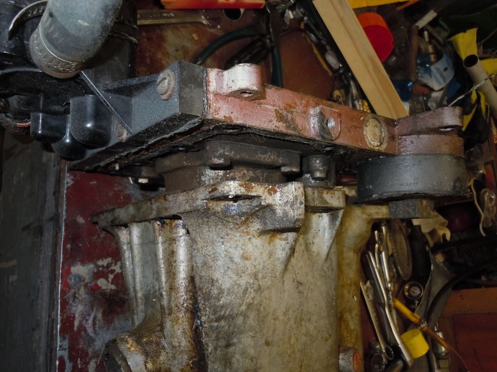

quote-(Do the cooling tubes attach to the exhaust adapter under the powerhead? The manual isn't real clear on that and the tubes will not remove from the top end of motor.)
Yes, each tube attaches to the
adapter assembly with a collar held on with two screws. I have a 75 hp apart now if you need some pics, let me know .jim

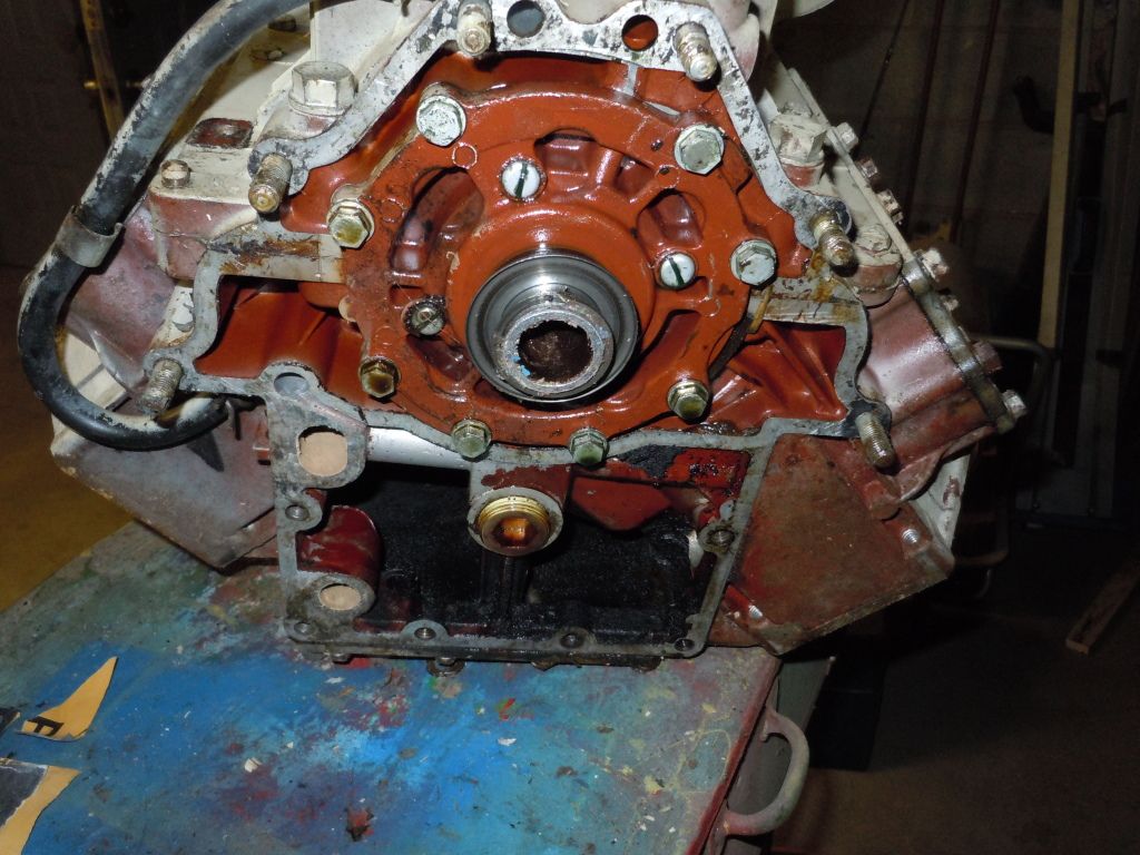

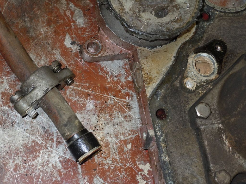

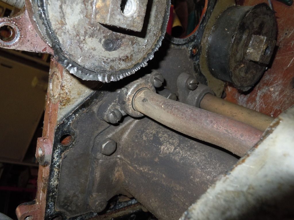

Re:thermostat question 14 years 1 month ago #69254
  • Jim L
  • Jim L's Avatar
  • Posts: 1426
  • Karma: 60
Here you go curse. Keep in mind this is a '63 75 hp electric shift,but other than the linkage verses electric cable, I'd think they would be very similar.

These motors can lose water pumping ability if a head gasket is leaking or blown. Exhaust gasses leaking into the water passages can blow all water out of the block.
Most Definitely pull both heads, check them for flatness and replace head gaskets, before removing the powerhead.
Another thing you can try is, with the lower unit removed, pipe water from your garden hose up the water supply tube and run the motor. Be very careful as you'll have little backpressure and she'll rev up fast (not good for V4's).
If you run enough pressure to get water circulation thru the block, it's gonna point out a leaking gasket (you'll get water on the offending cylinder's spark plug).
Your water system's pressure is enough to overcome any exhaust gasses blowing back into the water passages; however the motor's water pump won't develop enough pressure to do the same.
Note that leaking exhaust manifold gaskets can also cause water-pumping issues, but blown head gasket(s) a more common cause of this problem.
I can't recall any rubber flow diverters in the old V4 blocks, they definitely had them in later models. If you pull both both heads and find no rubber bits in either side, I'd say you're pretty safe in assuming there are none. On blocks which have the diverters, they slide into grooves which are designed to hold the diverter in place.
HTH & G'luck with the troubleshooting.........ed

Re:thermostat question 13 years 9 months ago #73413
  • curse
  • Posts: 445
  • Karma: 5
Update.
I took lower unit off and was looking everything over when i found the water tubes are loose (they twist/spin easy and one of them can be moved at least an inch) and may have something to do with the water not circulating?????
Question is..is there an easier way to get the powerhead off the top of motor? I got the lower tray/cowel loose but it is still in the way of the bolts at the bottom of the powerhead. Is it really a pain in the butt or am i missing something?

Ok, here is the motor i found. Owner thought it was a 90 hp but i got the model number (80793 r) and see it's a 67 80hp. Since it is a long shaft i will need to use the 50 lower unit along with the hood from the 50. Another thing...i couldn't find a parts diagram at marineengine.com. Any links to other sites that do have a diagram?
Before i pay the $150 for it is this a good motor?

The Johnson equivalent is likely listed on marineengine.-Different cover and different colour paint.
Re:thermostat question 13 years 9 months ago #73773
The engine is priced good, but only if it checks out. You will need to do a compression test on all four cylinders. DO NOT shoot oil into the cylinders before testing them. Test each cylinder and record the numbers. All four cylinders should have similar readings. Anything more than 20% between cylinders usually indicates a major problem. A 10% difference is common and suggests the cylinders are decent. When new, this engine probably pushed 100psi per cylinder. Old but good running ones will often push 80psi per cylinder. Be absolutely certain that it is not a salt water engine. Salty engines will have rusted screws on the thermostat cover, and likely rusty cylinder head / exhaust cover bolts. Do not buy a salty engine. Forget the lower unit from the Fifty - it's a complete dog. Find a short drive shaft for the 85 lower unit. They are easy to come by, and simple to change. You will also need to change the shift shaft in the lower unit, and shorten the water pump tubes. It is all pretty easy to do, really. The lower unit must be disassembled, but it should have a seal kit installed in it anyway. If you go this route - there is plenty of help here if you need it.
I'm giving you a link to the BRP website parts database. BRP only goes back to 1968. But the 1968 Evinrude 85 HP speedifour was nearly the same engine as the 1967 80 hp., excepting for the flywheel, ignition, and internal throttle linkage. All other parts are same. Click on the link and use the pull down menues to search
epc.brp.com/Index.aspx?lang=E&s1=bc1e8d65-9924-4a11-b364-55ccabb78fc5
