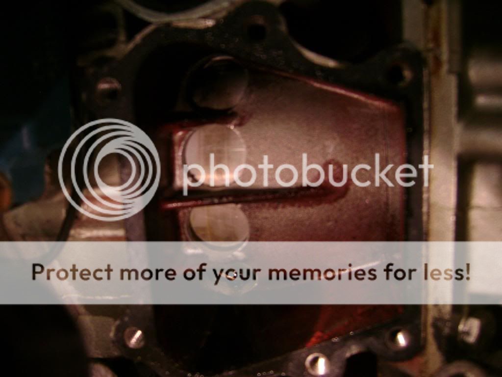

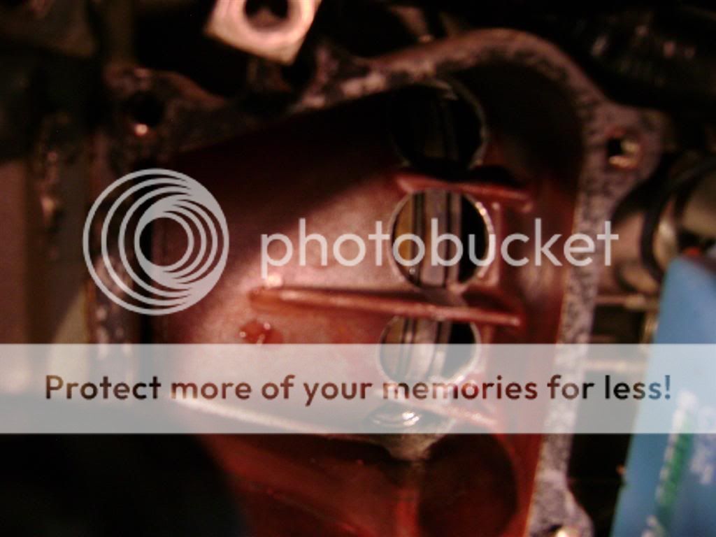

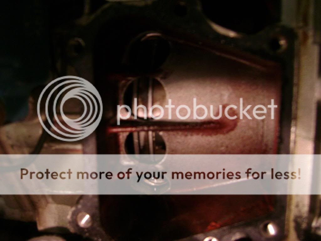

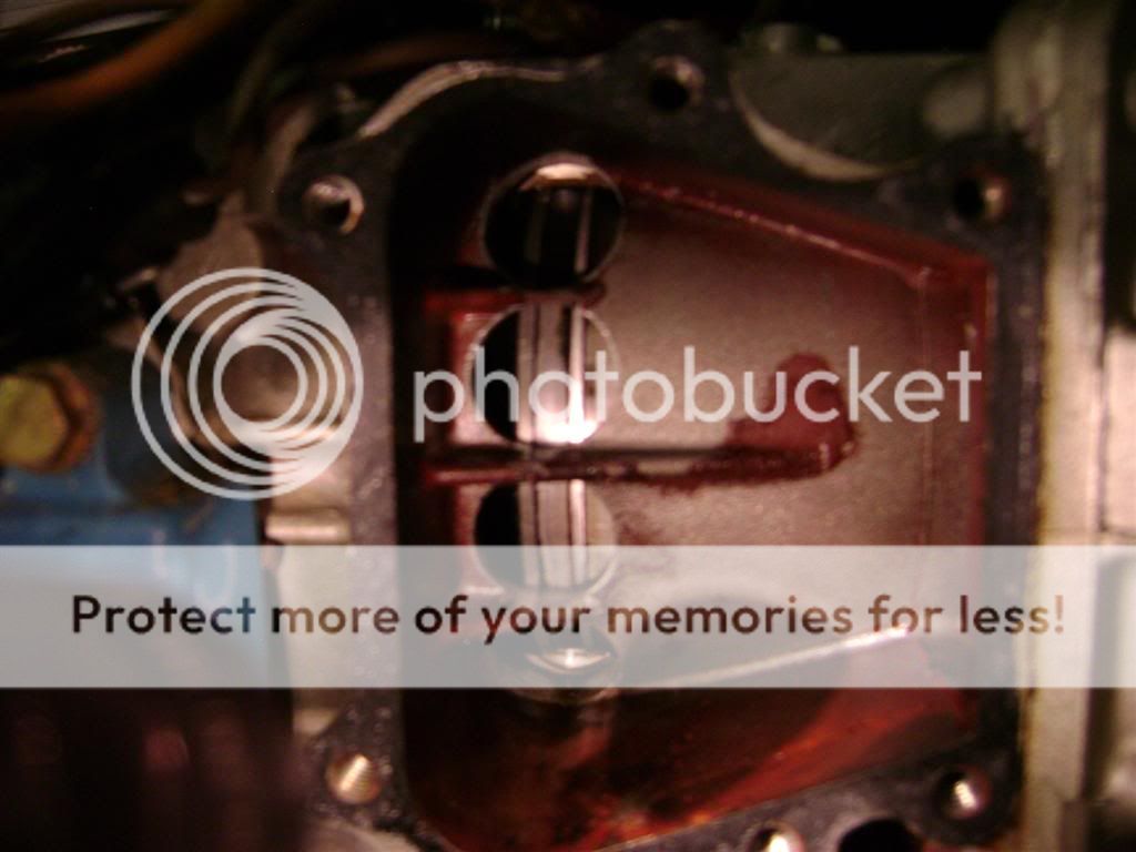

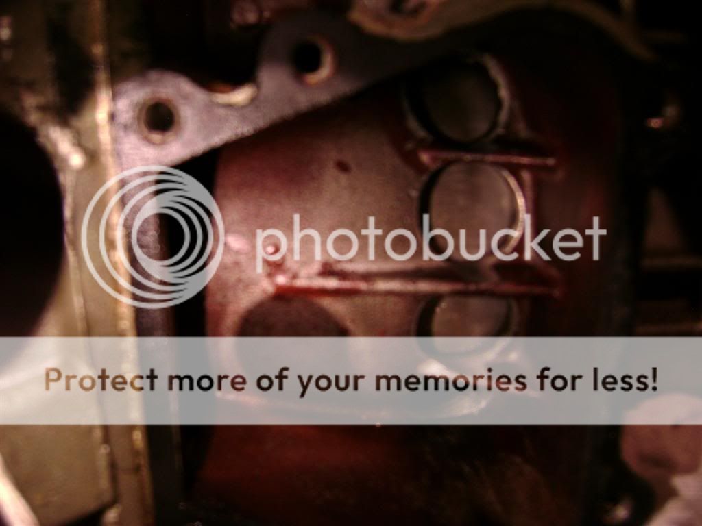

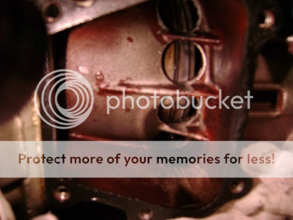

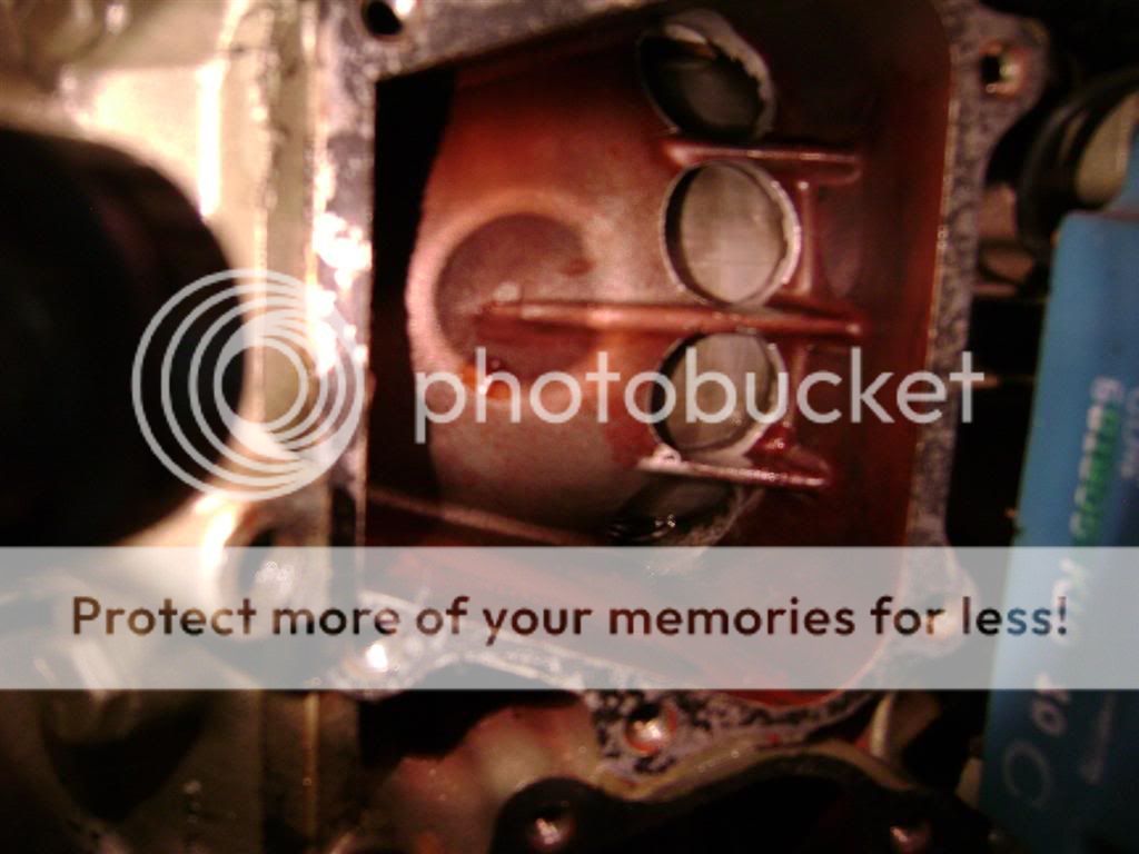

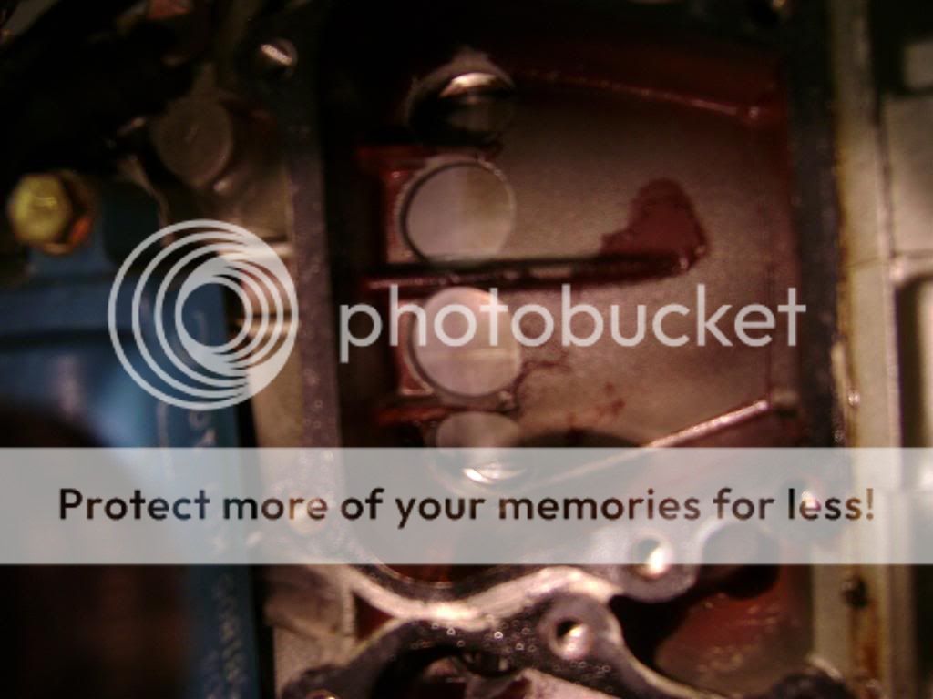

Re:1978 Evinrude 115 V4 Model 1115899C 14 years 10 months ago #53155
  • MarkS's Avatar Topic Author
Okay gang, transfer port cover inspection complete, I think it's time for "the happy dance" in OMCville!?+1,3,2,4 (I think)rings And skirts; Shined a flashlight thru the spark plug holes, saw no scoring whatsover on cyl walls, what do you think?
(Sorry the pics turned out kinda blurry, had trouble getting the camera to focus that close.)
Re:1978 Evinrude 115 V4 Model 1115899C 14 years 10 months ago #53157

Good for you,Mark! I'm going to keep an eye out for me another good engine. Just hope I can find one close to the shape yours is in. Merry Christmas
Re:1978 Evinrude 115 V4 Model 1115899C 14 years 10 months ago #53163
